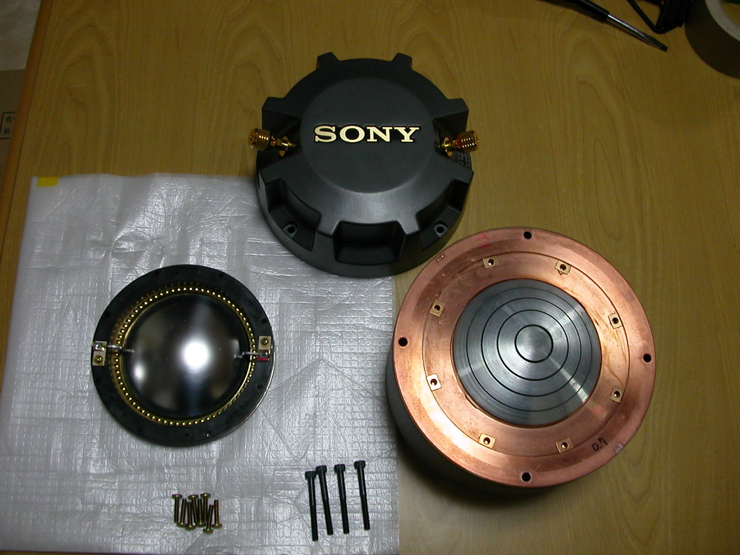

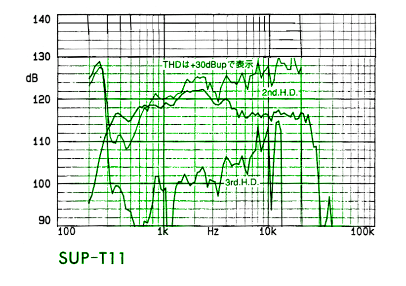

Those modern Sony SUP's from GT sound are surely something, even the originals fared extremely well compared to the TAD 400x series when they were introduced, lower distortion especially on the top end.
The measurements is from the original Sony SUP drivers.
Not the improved GSU from GT sound. The GSU are 6000$+ each driver if memory serves me right.
4 slit phase plug, 2,0 T, good inductance control with copper shorting ring, copper plated motor, really thin and lightweight alu diaphragm. very interesting large format drivers indeed.

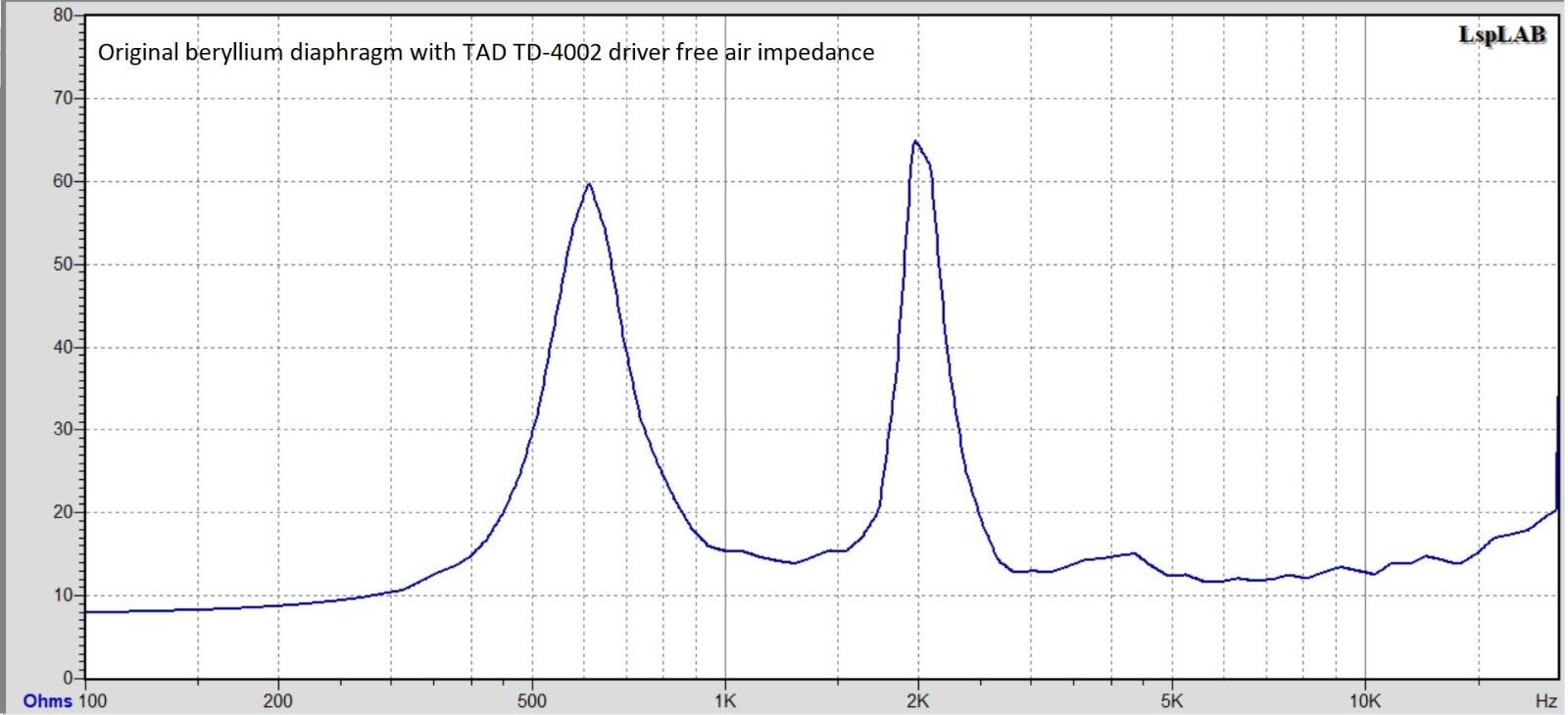

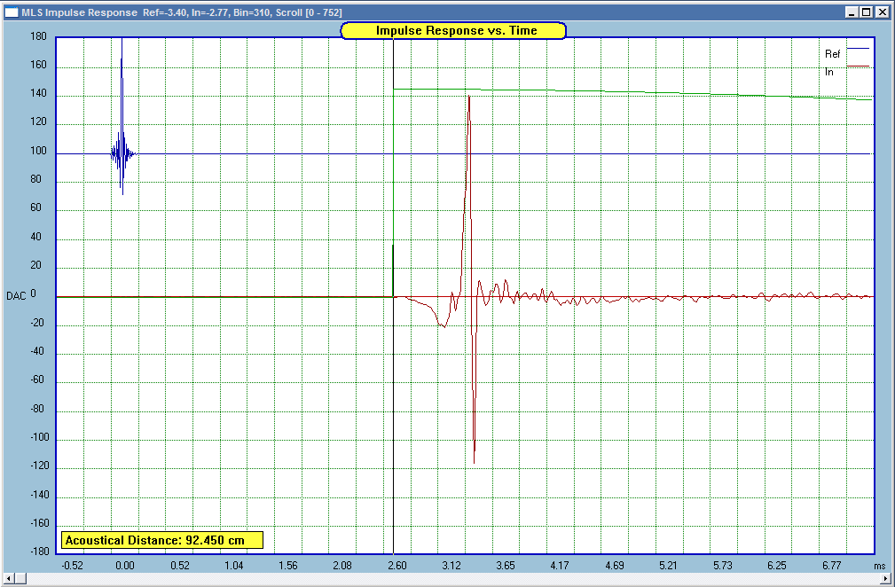

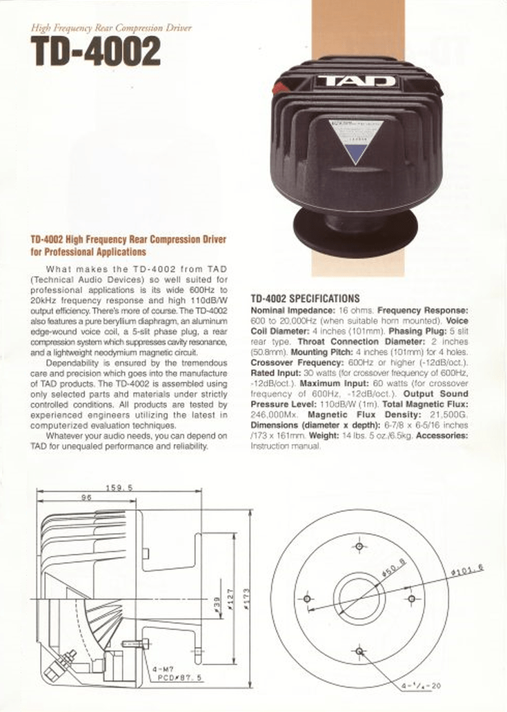

But if it has to be beryllium, why not buy a pair of TD-4002s for about $1000-1500 that even includes a removable throat adapter?
Have to agree with you there.
They do better without the adapter as a 39mm exit.
Also a better candidate for modern horn designs as they do not exhibit the typical slow flare rate/long throat of it's siblings, when used without the adapter.

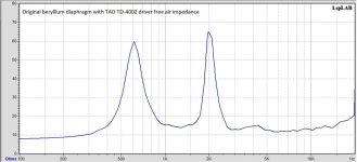

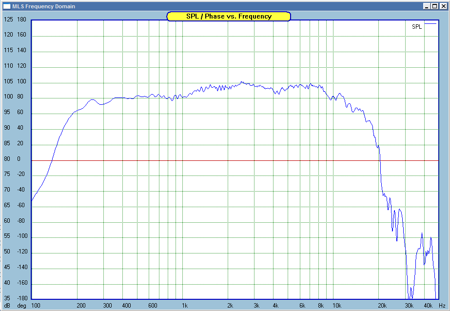

Well behaved response, 2,1T neo magnets, 5 slit phase plug,copper shorting ring, well behaved impedance curves and Impulse responses, good distortion measurements.
The only horn i know was specifically designed for it is the TH4371. 70 deg, diffraction horn. from the TCM 1621/22.
And the Cinema horn from the brochure i linked below.
I know @Cask05 have used them with success on his K-402 horns also.

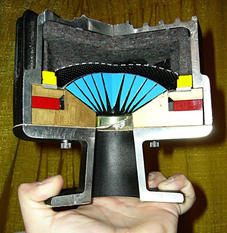

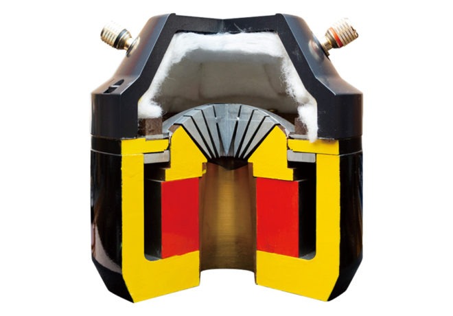

Notice the extremely tight gap, and the rubber that's visible in the cutaway covering most of the depth below the voice coil, to avoid cavity resonances from the space.
This one goes through most of the design details of the 4002, with one completely disassembled, for anyone who is interested. English texting helps for anyone not French ofc.

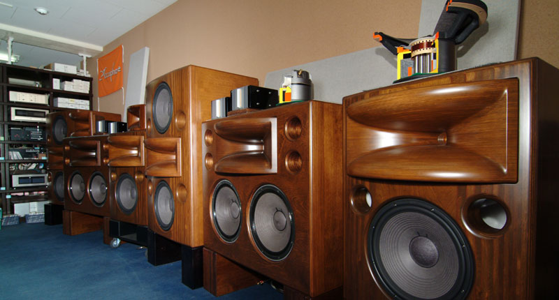

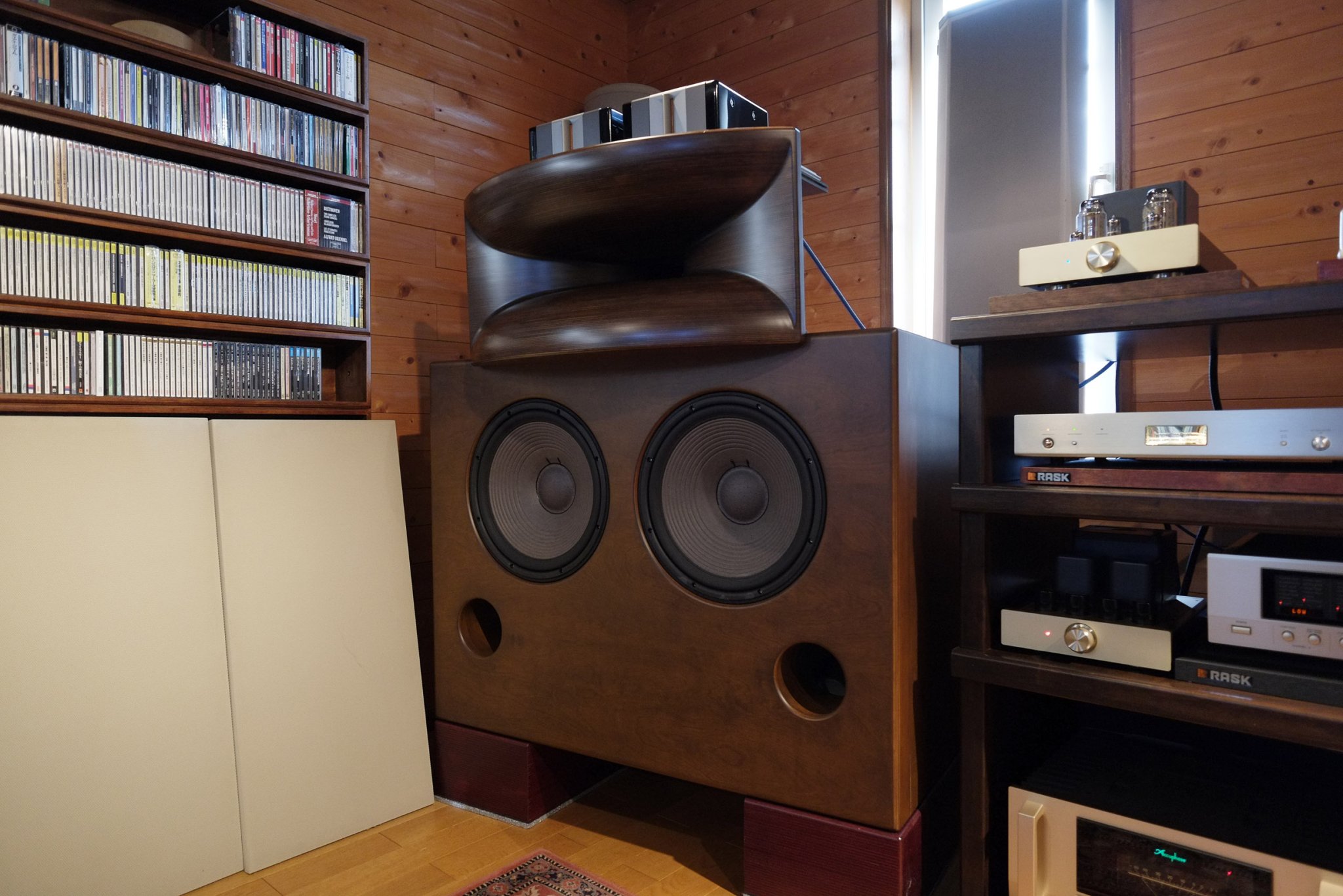

I visited GT Sound's headquarters on the outskirts of Tokyo a few years back, and listened to three of their speaker systems, all using this compression driver.
Superb is the only word that comes close to expressing it.
This is niche ultra-high-end done right (as opposed to the nostalgic jokes from the likes of Goto or ALE, IMHO).
But, when I said (referring to the TADs) that "there is nothing else as good on the market today", I was thinking of mainstream manufacturers, not über-expensive niche ones like GT Sound...
