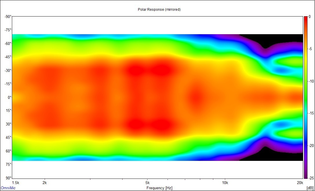

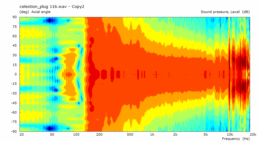

And here is the directivity plot measured in an anechoic chamber. (Ø 38cm Controlled Directivity Axi-Symmetric horn with a built in plug)

Ahem...that's "prior art" (in the patent sense). That would negate any patent application that occurred within the past year or so. Bravo.

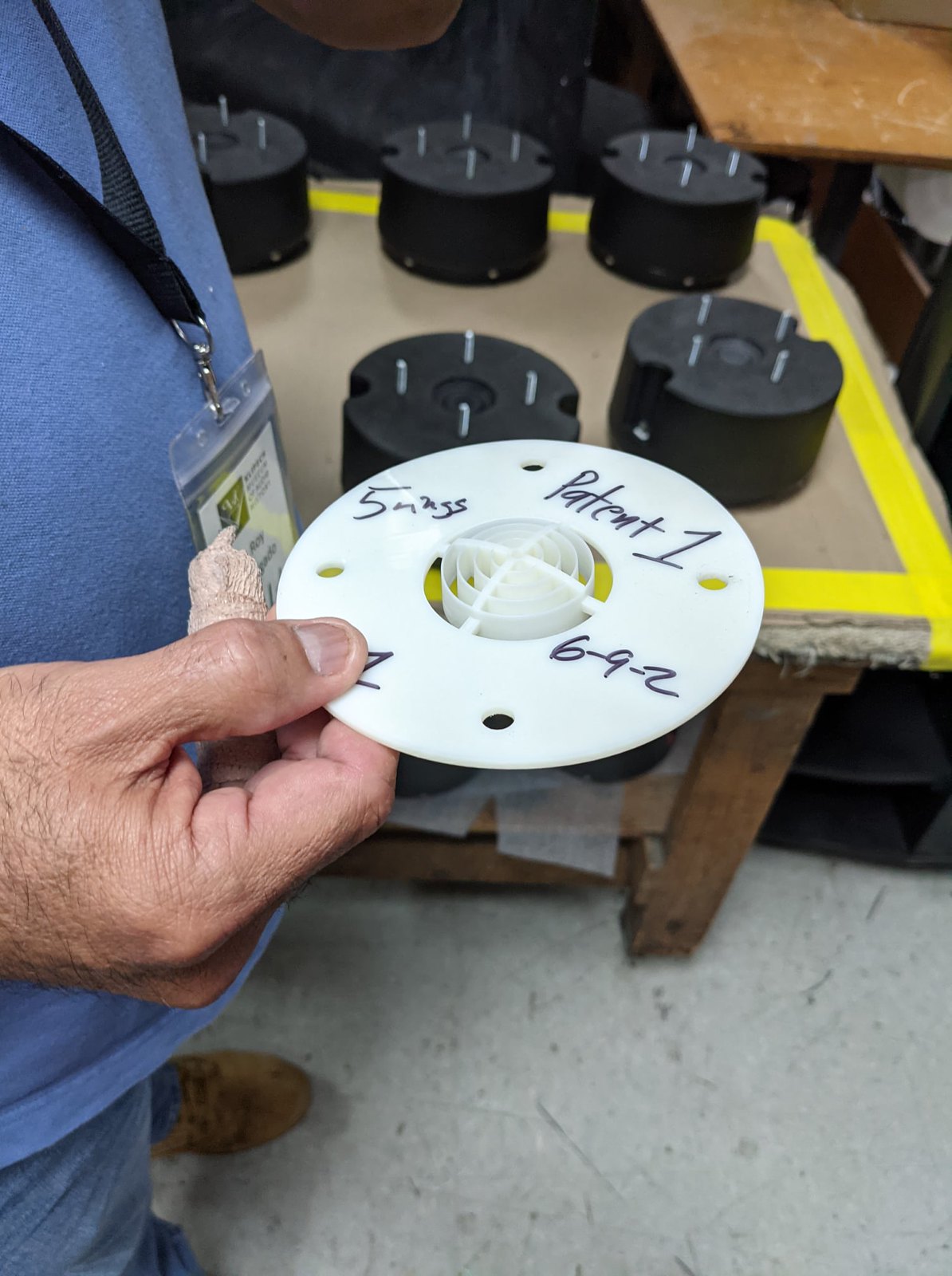

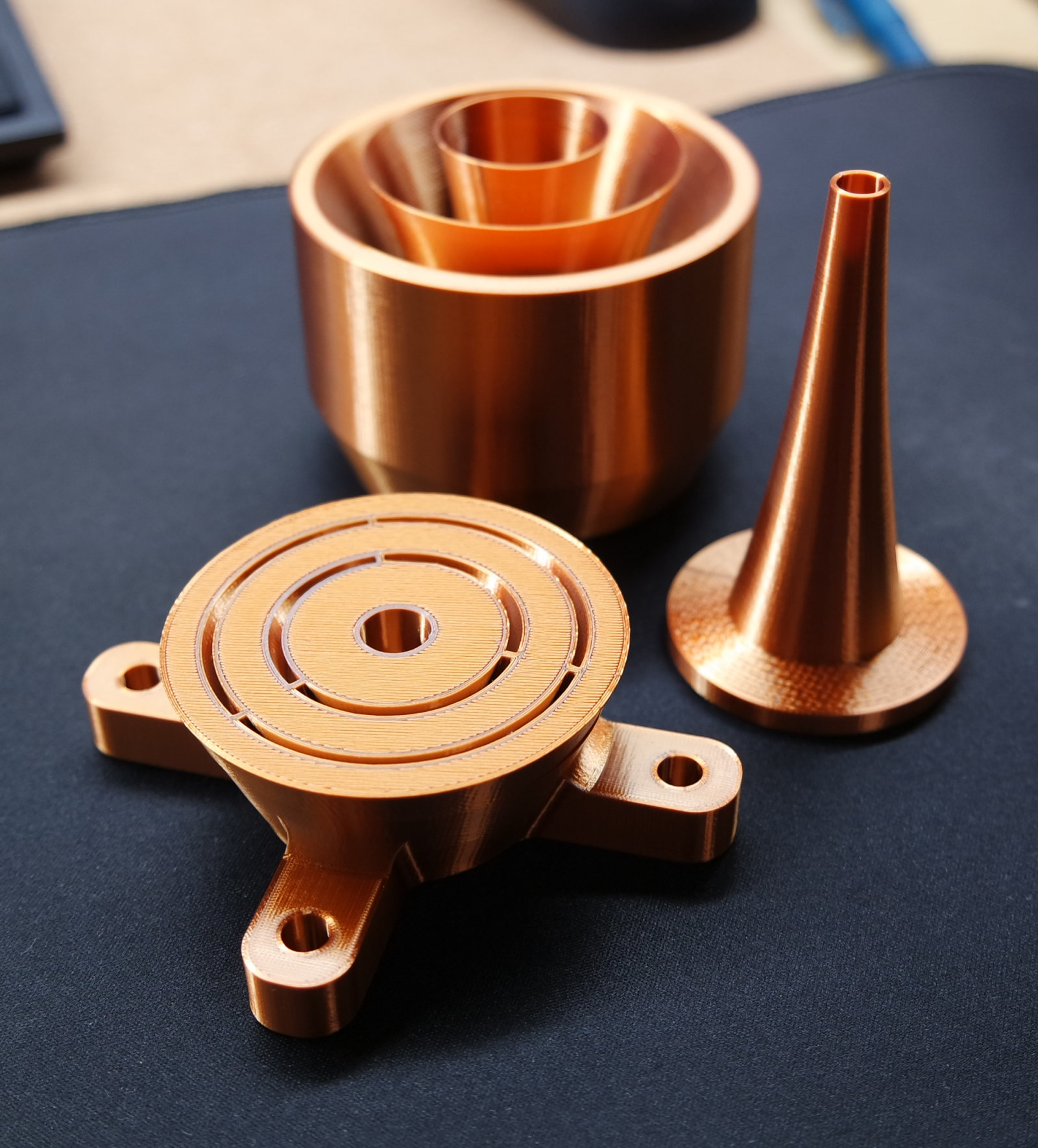

For those that haven't seen the throat diverging lens (that someone else called a "phase plug extension" and yet someone else called an "external shaping plug" or ESP), here it is:

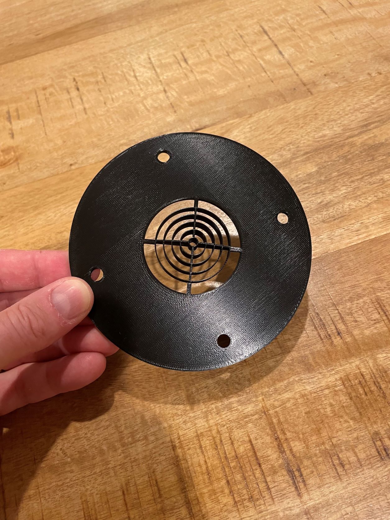

Here is what the ones I use look like:
Chris

Thanks. Your "ESP" concept looks like part of the Axi2050's phase plug design by Jack Oclee-Brown (EP 2011365B1). That's an actual "phase plug extension" if it matches the output phase plug geometry of the Axi2050.
I wonder why the Klipsch lens seems to work...? My ears (subjectively) and the polar measurements (objectively) tell me that it does...up to 14 kHz. Could it be that it's not actually a phase plug extension, but an acoustic lens that's doing something else?
Chris
I don't know, I have yet to see an objective data showing that it actually does something.
- The whole aim of the current ESP design is to convert a flat wavefront into spherical. The closer is the actual exit wavefront to flat, the better it should work. The details of a preceding phasing plug haven't been considered (maybe they should but that's a whole different level of complexity).

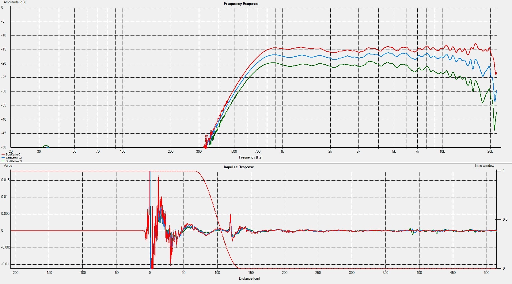

This is how the The Axi2050 measures on a pretty big OSSE horn with no plug.
Red is on axis, blue is 30 degrees off. The level is probably shifted (can't remember)

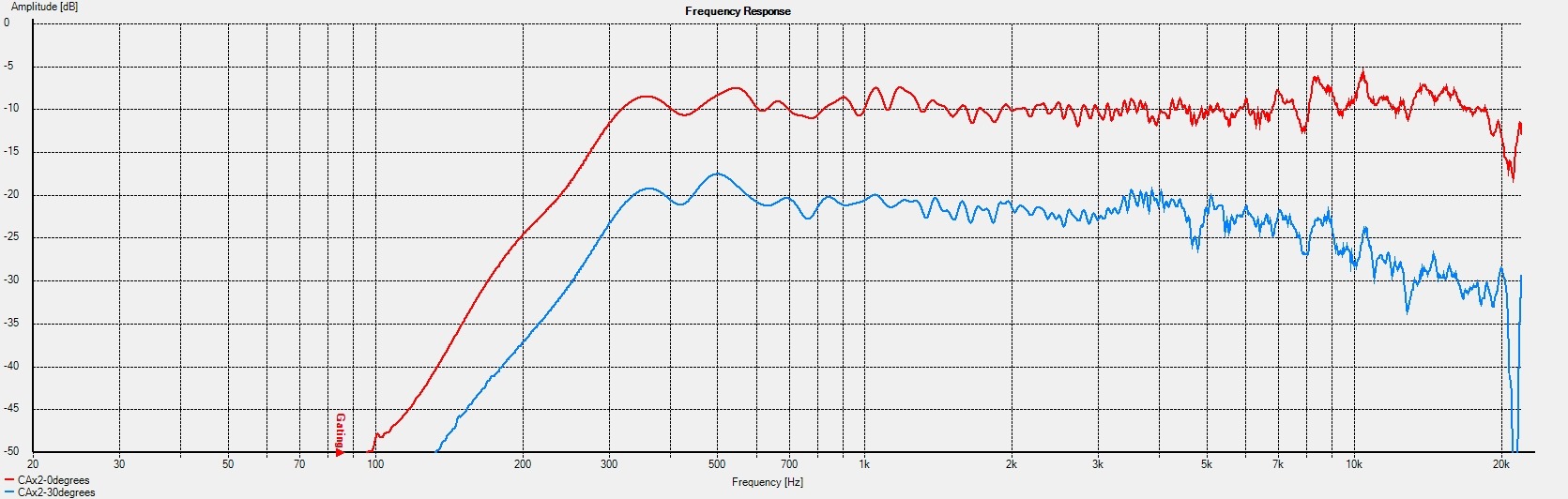

And this is how a BMS4550 measures on a 50% scaled version of the same horn.
Red is on axis, blue 22 degrees degrees, green is 33 degrees off.
Not sure how much of a valid comparison this is.
When listening to the axi , one could easily notice the change in tone when moving off axis.
On the 4550 - not so much, even though the graphs seem very similar.
I think the built in phase plug of the Axi2050 makes it behave less like an ideal 2" source which on simulations shows really strong beaming.

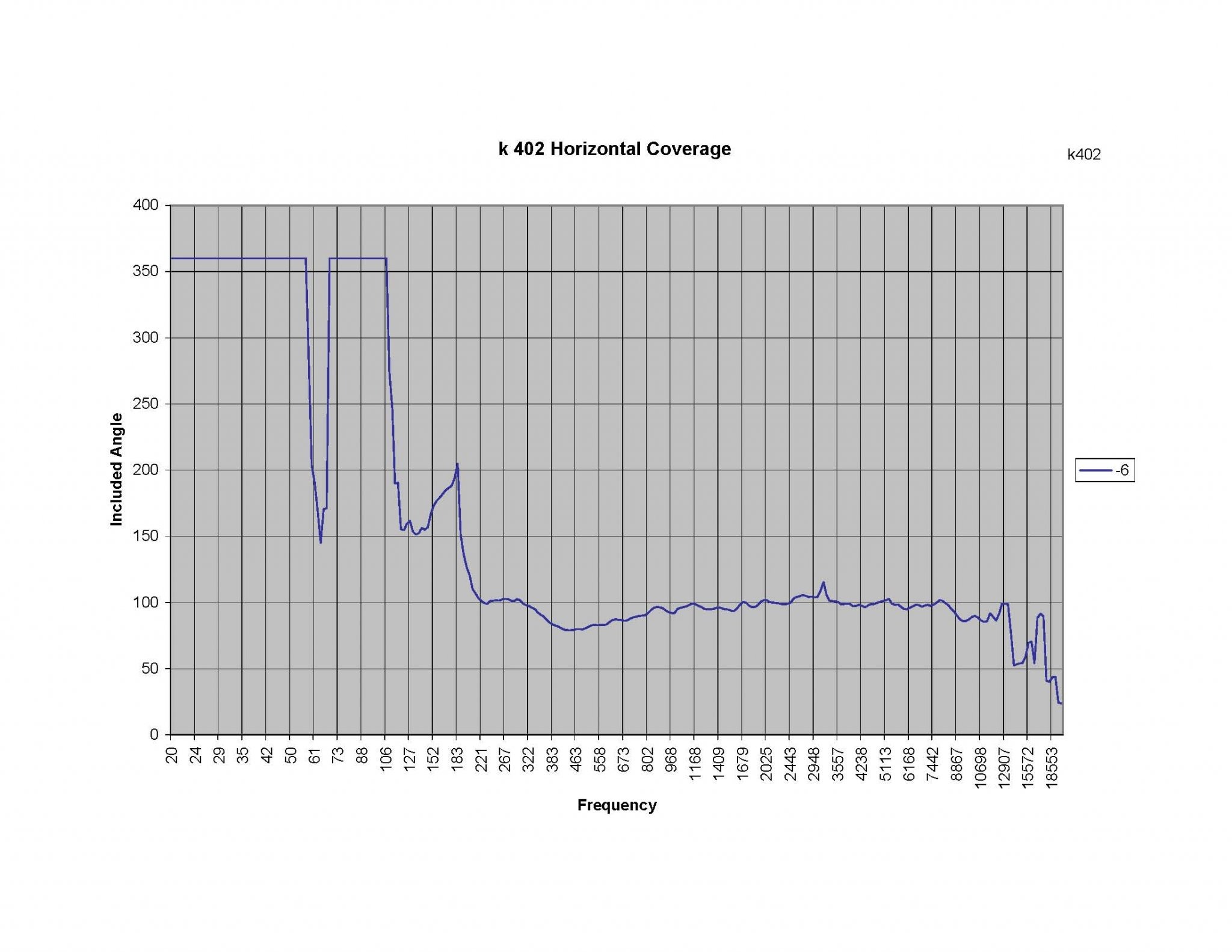

Chris,
Mabat did quite a bit of simulation work to assess what a "throat diverging lens" (TDL) may do.
To confound the issue even more, the K402 horizontal -6dB Coverage -6dB you posted in #218 has around the same pattern as the TAD TD-4002-K-402 with TDL you posted in #340.
While I have no doubt the TDL actually does something, since we have no measured polar response of the same horn/driver combination that show the difference with and without the TDL, we still have no objective data to compare to determine what that "something" is.
Art
Art has been informed as to what mistake he made in his assumptions when he made this comment. Suffice it to say say that he was trying to compare completely different conditions--apples to oranges--in the area he is focused on.
