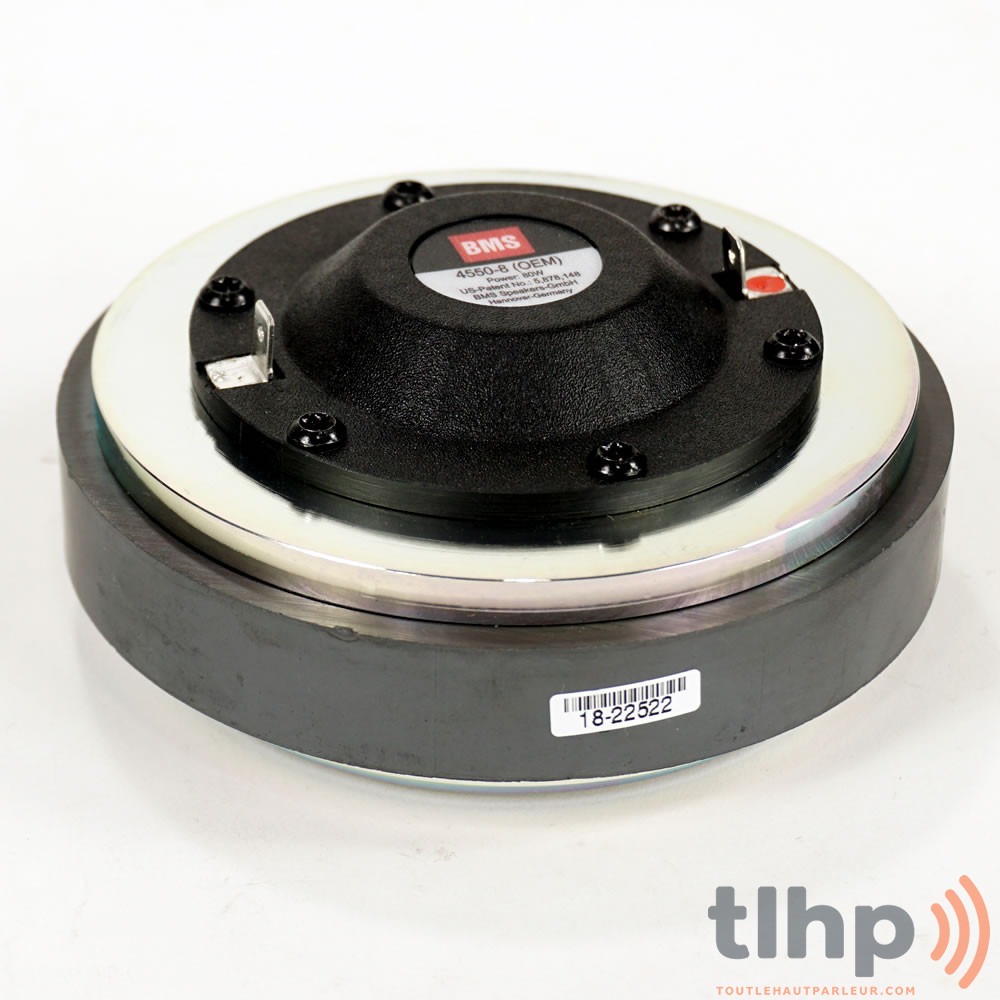

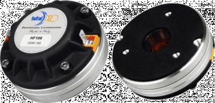

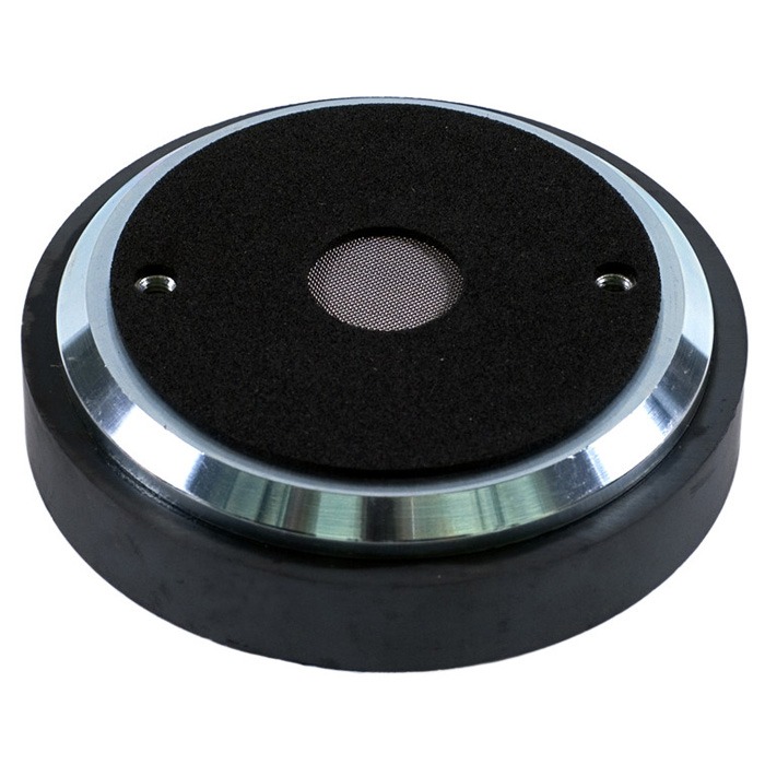

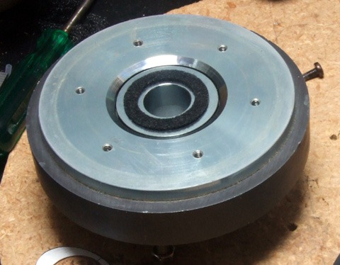

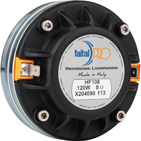

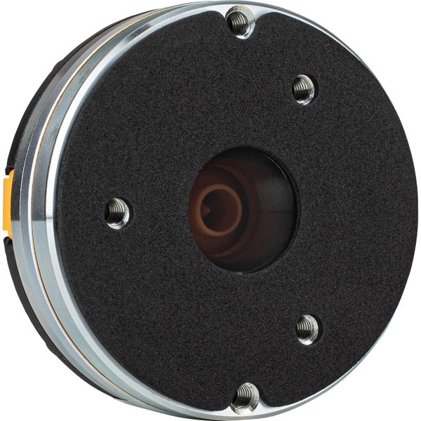

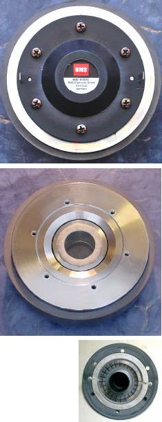

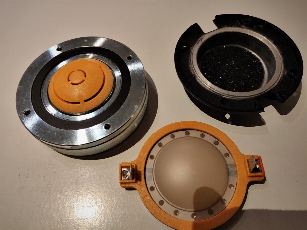

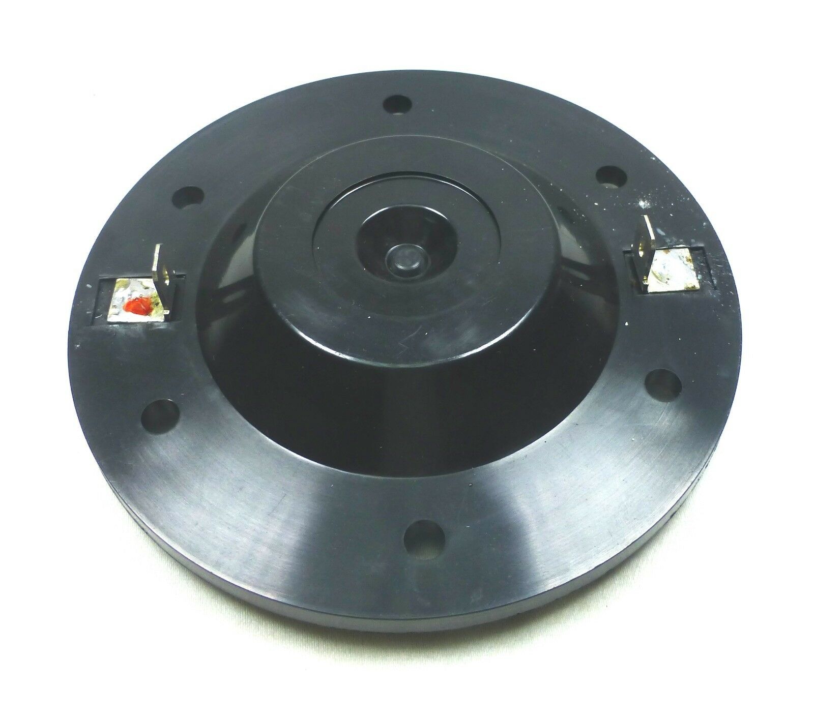

Had anyone the luck to listen to a Faital HF108 and BMS 4550 side to side as low as 900 hz cut-off please ?
Good question. I have similar question, but I want to use a cut off frequency between 1KHz and 2KHz (LR-IV) together with FANE's SOVEREIGN series, model 8-225 - go to
https://www.fane-international.com/downloads/FANE-SOVEREIGN-8225-DS141117.pdf
and Faital's LTH102 Horn
https://faitalpro.com/en/products/HF_Horns/product_details/index.php?id=903010110
Datasheets of HF drivers in question are here:
https://faitalpro.com/en/products/HF_Drivers/product_details/datasheet.php?id=502010170
https://www.bmsspeakers.com/fileadm...te/bms_4550_2011-04_hf_compression_driver.pdf

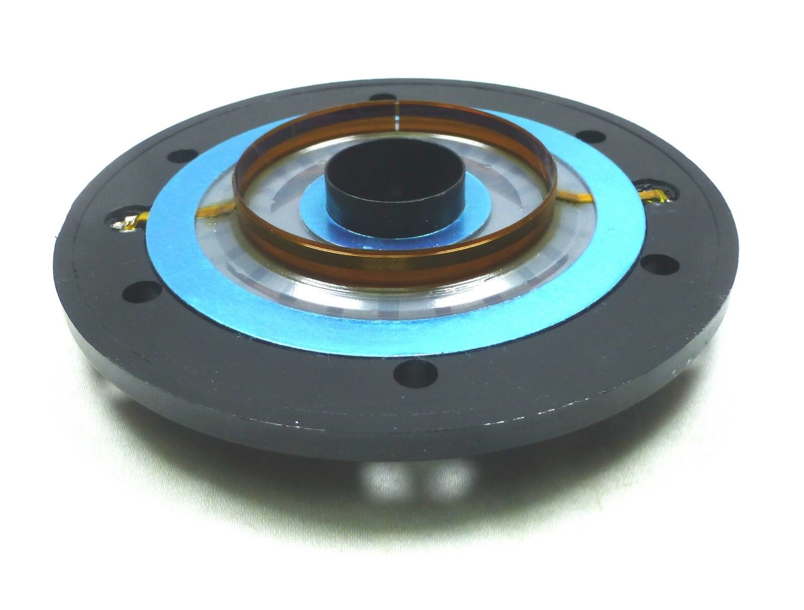

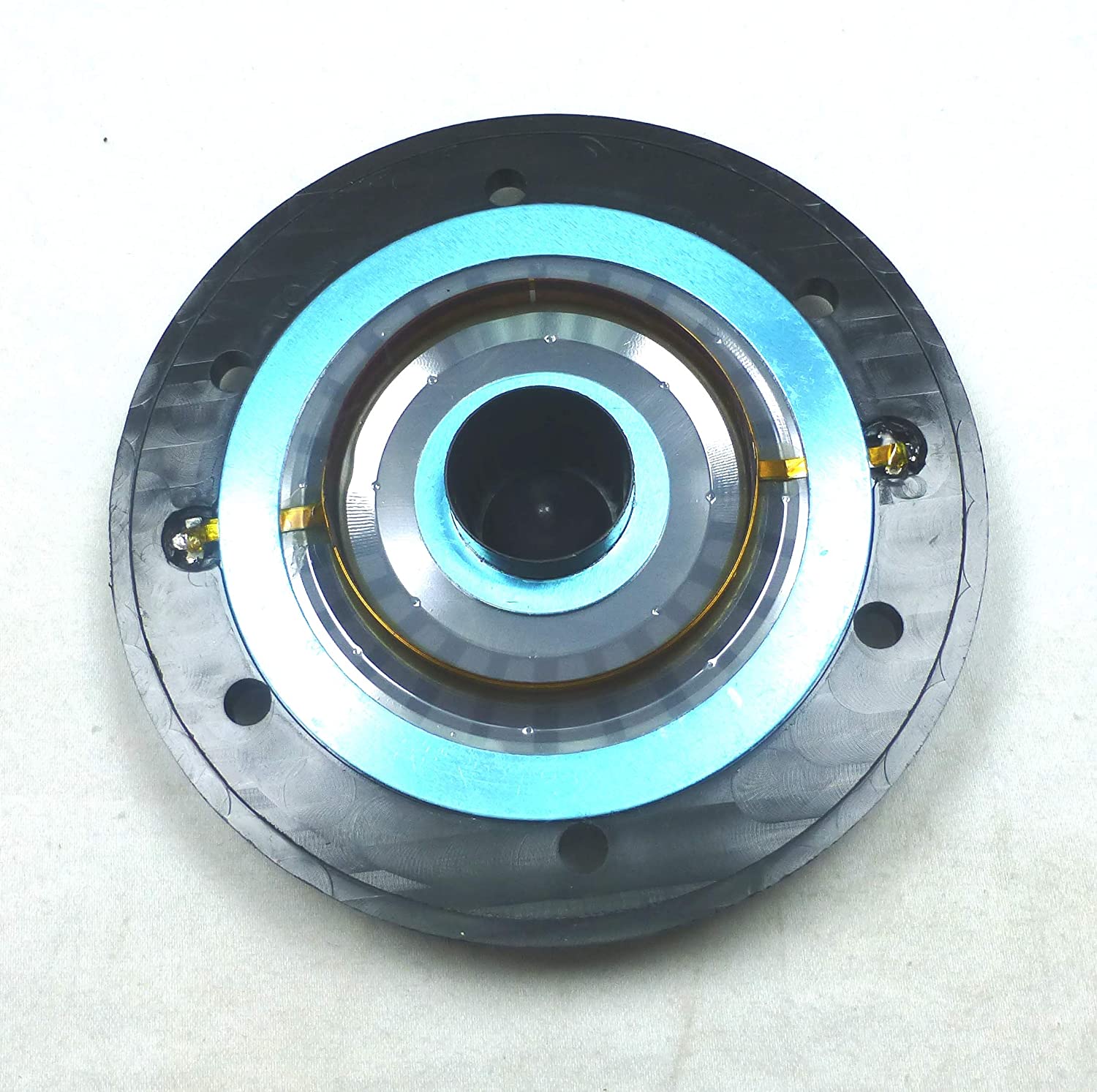

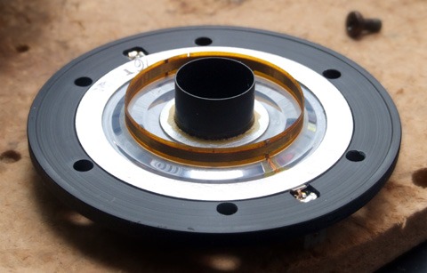

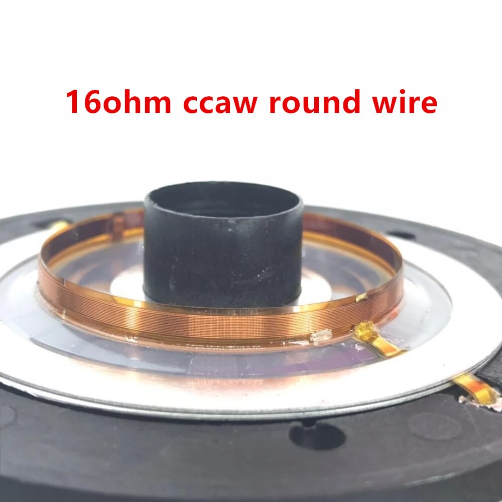

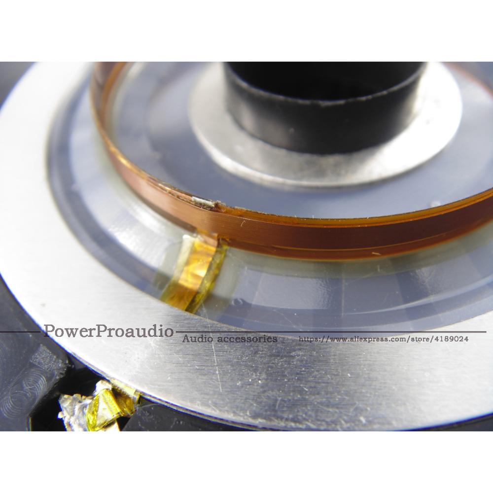

according the attached images (for compare differences concerning the internal features) there must be audible differences - but how would one evaluate the different sound character while a listening test ?

To date my favorite smaller format CD / Horn combination is the Faital Pro HF108r bolted on the STH100 horn. Next up is the HF111. Both of the Faital Pro drivers mention here have very flat smooth frequency and impedance in the utilize frequency band. we are talking a crossover point at or near 2.2khZ. This CD/waveguide package is much smaller and fits well in our home listening room.

I AB compared the HF108 and 4552 (ND version) and after testing many drivers I determined those two to be the best 1inch CDs I could find. The HF108 has a more pronounced and authoritative midrange with an ever so slight amount of squawk in the highs. The BMS 4552 has extremely smooth highs -- as good as any bullet tweeter and possibly any other variety of tweeter I presume. It is less suitable than the HF108 crossed at 900hz as the mids seemed a bit less authoritative. It would probably do the job just fine though and with some EQ likely quite well. I sold the HF108 as I find the CP755ND to be a stunning driver and the best of many Ive tested. I kept the 4552s as they are quite special too in my opinion.
