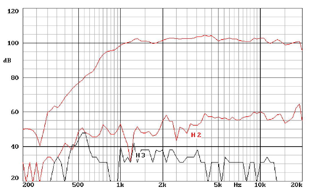

Looks like Beyma TPL150H
https://www.beyma.com/speakers/Fichas_Tecnicas/beyma-speakers-data-sheet-amt-TPL150H.pdf

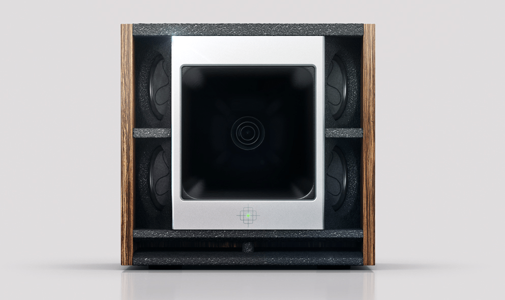

And the winner is...
Just thought I would throw it into the discussion for comparison for those who might not know these spectacularly good drivers.
(No offence or dishonesty intended Brett...).

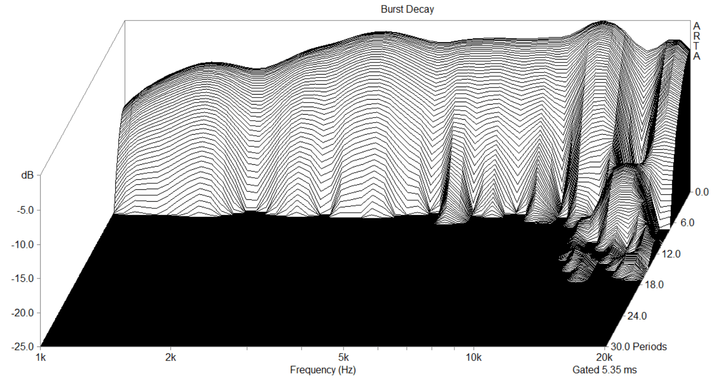

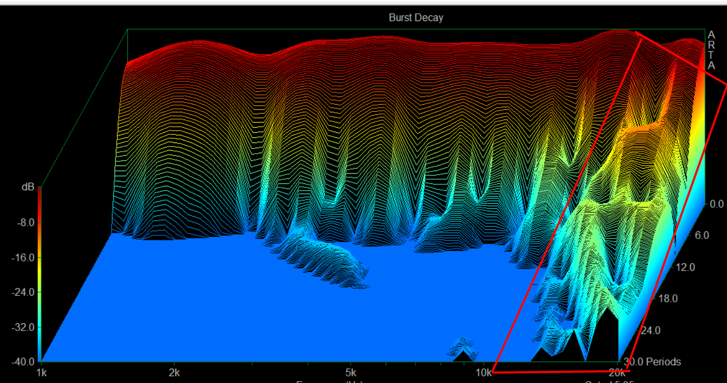

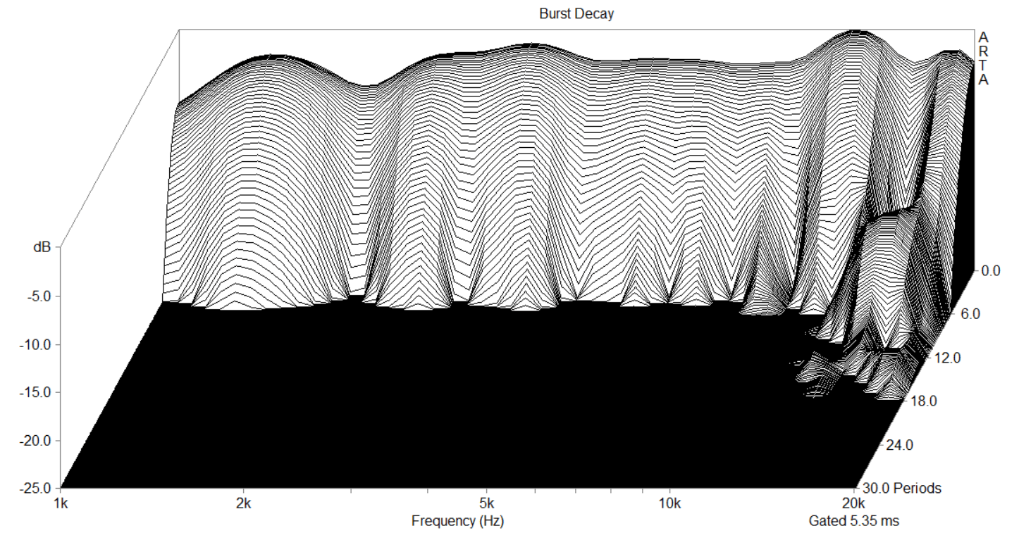

For good compression driver, look the HF decay. I believe this is related mostly with phase plug and other internal parts of the driver, some resonance somewhere. If there is not this kind of long decay for highs, or with any parts of the response, expect good sound I think. The rest is just matter of straightening up with EQ and use good waveguide to get polar response good. Do not use bad waveguide / horn that makes reflections and diffraction because they would be there no matter what drives it.
I've seen burst decay / CSD / wavelet plots on the forums many times, just can't find them currently to make a proper illustration Most drivers have these and mr. Gunness has his Temporal EQ thing fixing some of this as well, I believe. Anyway, here is my HF10AK in RCF H100 graphs illustrating it. Both are same measurement just different scale. The black and white image is to be comparable to some burst decay plots I found here https://josephcrowe.com/blogs/news/es-2000-biradial-with-various-compression-drivers

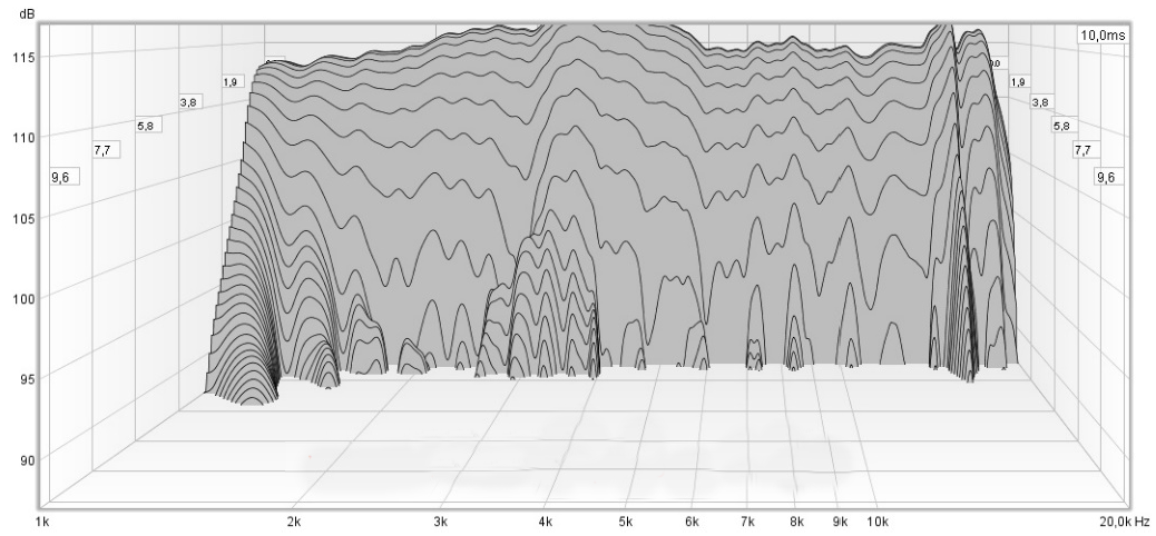

edit. found measurement of HF10AK in STH100 waveguide as well. As one sees the top octave, wavelengths ~< throat diameter, are defined by the driver and not the waveguide, at least in this case

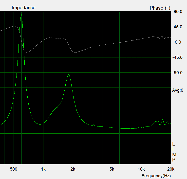

edit. Found some impedance measurement, I believe with STH100. Something resonates at the top. I'm curious which drivers don't have these. milezone, any chance you have measurements int ARTA / REW that could show the decau of the drivers you have?
