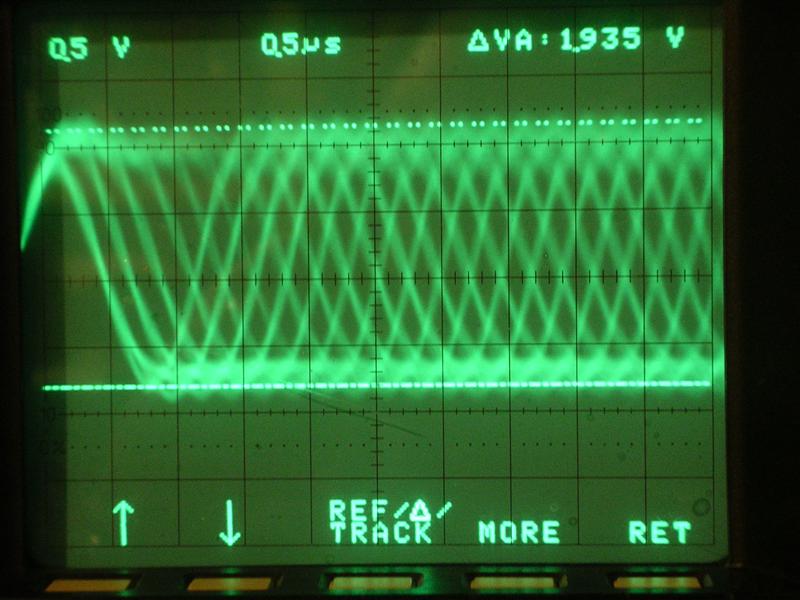

Hi Gaetan,
Your eye pattern diagram looks like a telecom (T1, T3 or optical) type. I have attached a CD eye pattern. The characteristics you are looking for are the same.
The spindle motor is controlled by the difference between the PLL and the system clock. So, you are right in that the clock in the CD is the reference. Understand that the clock in the CD is more than accurate enough for this purpose. The speed induced jitter from the CD data is magnitudes higher than the CD clock. So replacing the clock in the CD will have zero effect on the jitter from the CD data stream. It's effects are felt elsewhere in the system.
-Chris
