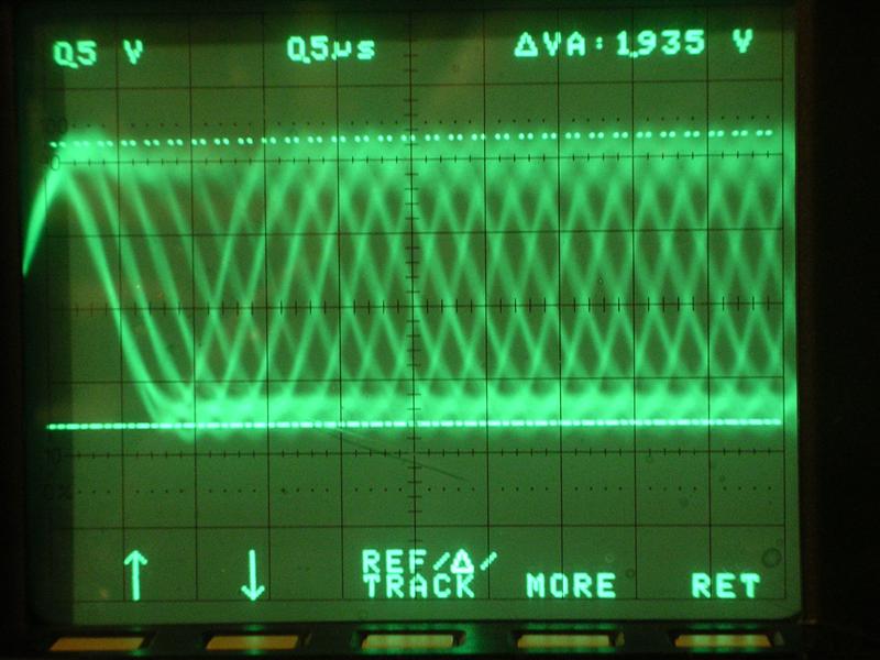

Guido, I've heard you mention pit-jitter. What exactly do you mean by it? Its something I haven't directly come across as a term and would like to investigate it. I currently think that jitter is most important at the DAC end - unless it can lead to erroneous data in a transport?
Also, I'm going to express my ignorance (if I haven't done already 🙂 )...
How do you look at the eye pattern?
Can it be done with just an oscilloscope?
(I assume its the data stream out of the RF amplifier on an oscilloscope, maybe without triggering so that it overlays itself on the screen to make the pattern?)

The only comment I'll make is that the amplitude can vary from design to design. To see this, you simply connect your oscilloscope the the test point marked "RF" or "eye". Set your 'scope for 0.5uS/div for time and start at 0.5 V/div for amplitude. Normal triggering.
Now this diagram shows what I actually see on a Nakamichi OMS 5 or OMS 7. Most other machines have more noise and some jitter side to side. So don't expect most other players to have this nice sharp example of an eye pattern. I have attached a shot of a real eye pattern. This one is an excellent example (better than average) from a VAM 1202 on the RF board. The make will remain nameless. At any rate, this is much better than I usually see on these. Normally, a KSS-210A type will have a cleaner looking eye pattern.
-Chris

Displaying the eye pattern:
"To see this, you simply connect your oscilloscope the the test point marked "RF" or "eye". Set your 'scope for 0.5uS/div for time and start at 0.5 V/div for amplitude. Normal triggering."
To get an even better view, you might want to use external triggering with the sampling clock. I'm not sure though, if it easily possible to locate the clock which is used to sample the eye pattern and then apply this as an external trigger. And maybe a trigger buffer might be required to avoid capacitive loading by the trigger cable and scope sync input?
Kurt

Hi Kurt,
That isn't necessary. The normal triggering works great. Doing anything else would only make the measurements more of a pain. If you need to go that far, the eye pattern is not stable enough anyway (so all is lost).
Normal triggering has always worked well for me on every single CD player I've run across so far. Now, thinking about it a bit... A trigger from an internal clock may give a "messier" looking pattern (high jitter). The clock is not directly locked to the data rate of the CD. To get around this problem, the data is clocked into ram using a PLL and clocked out using the system clock. The difference between the PLL and system clock generates the disc motor correction signal for speed. So if you use anything but the actual eye pattern you will not be synced properly. Therefore there will be lots of time scale errors.
