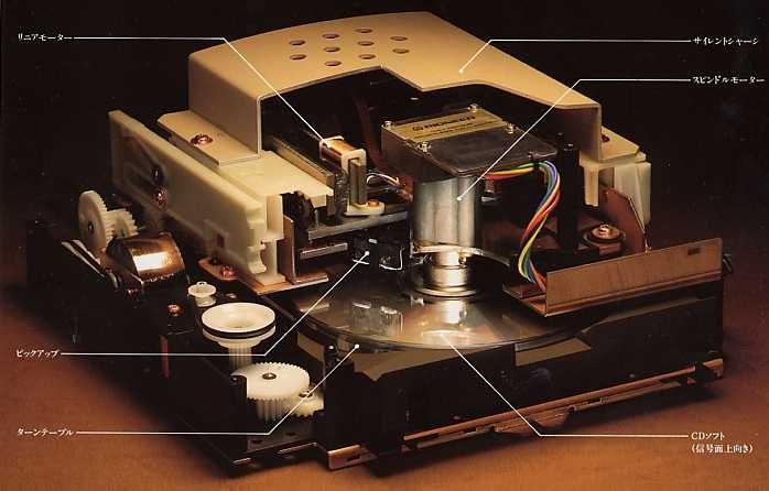

Nanook, you are right the Pioneer mech's do seam to sound better, than some others, yes there was a problem with the odd lens falling out but it wasn't due to heat, the problem was that Pioneer use a water soluble glue to stick them in, so as not to cloud the back of the lens with solvent based glue, what happened was that in high humidity areas the water based glue softened just like wall paper glue will let go in high humidity, this was rectified later with a better glue, were you live "windy dusty" sound like you will not have any problem. If it does , just clean it up and stick it back with the tiniest drop of super glue on the edge only and make sure it seats back down into the housing.
As for the reliability of the mech, sure some models like the cheaper 701 801 were built to a price, and weren't as robust, just like all other brands on the market, but the upper end models are bullet proof, my old PD77 (PD75) that I bought new in the late 80's early 90's has seen now out 3 new lasers that's how much use it's had, nearly 20 years old and the mech (PIC) is still going strong, sure it is a pain to set up 13 adjustments from scratch if your keen to start from the beginning.
I love the Pioneer Stable Platters but I have a small preference for the Teac VRDS.s And when re-clocked with a good clock can't be beaten easily for sound quality.
