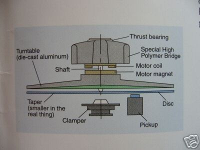

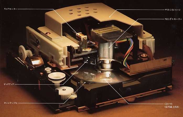

Below is the Pioneer upside down Stable Patter drive, ( note the linear drive laser motor) the platter is machined aluminium in this model (T-09)and it's face was slightly concaved so when the cd was press onto it you had virtually no cd edge (Flap).
The CM3.2 of the Teac VRDS that I have is similar except the other way around, it also has a great Sony KSS-151A Laser linear motor drive.
Cheers George

georgehifi said:
Also the Teac vrds systems always seam to sound better than other non full cd supported mechs to me and others, even without your clocks fitted, the only other one that has sounded as good that I've heard was the Pioneer Stable Platter system, again another full supported CD system. Cheers George
I like both the TEACs and stable platters but would like to mention that a well implemented Philips CDpro can achive similar or better quality as a drive.

Time for a sanity check!
Hi George, everyone,
1. CD's are not perfect. They can be off center and a number of other defects may present.
2. The system used for CD's is called "constant linear velocity", as opposed to "constant angular velocity". Can anyone tell us what this pivotal truth means?
3. The clamping system espoused by georgehifi to be superior to other methods adds a great deal of rotating mass to the CD. Agreed?
The system of CD playback begins reading the disc in the center at around 500 rpm, agreed? Then it may stop after the TOC is read waiting for the play command. As the CD is played through, often the motor must speed up and brake in order to keep the linear velocity constant. Agreed? Have you seen this term "constant linear velocity" anywhere before? Do you know what this means?
Anyway, near the end of a long CD the speed will drop to around 200 rpm (very roughly). If you want to read tracks back and forth in a mixed mode, the disc motor must accelerate and brake often. The higher the rotating mass is, the more energy is required to change the rotational speed and the more wear there will be on the bearings and the motor. The Pioneer examples even use a cheap plastic platter and a standard CD motor! I've replaced tons of them.
The only system that will benefit from increased rotating mass is a turntable. That's because it works on the principle of "constant angular velocity". In other words, it rotates at the same speed all the time with no change. A high rotating mass is a help here. Conversely, a CD needs to have it's speed adjusted at least on a per rotation basis. You do not want a high rotating mass in this situation.
Very simply .... A CD player ain't a turntable!!! You can't treat it that way.
-Chris

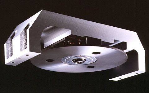

That's your opinion Chris, give me something that is stable and smooth and precise over something that is flapping in the breeze like a Frisbee, and I have never seen a trashed bearing in all the old s/h units I mod, they are built heavier duty to take it. As far as weight is concerned the magnetic clamping weight of the standard Philips/Sony system is almost as heavy as the lightweight clamping patter system of the Teacs and Pioneers.
As far as Magura's statement 8hrs a day 365 days a year, GET REAL, no Philips or Sony or any transport would take that for more than a year, except for maybe the professional studio Tascam CD701 transport
The broadcasting/recording industry still says one of the best most robust transports built, has been the TASCAM CD701 and guess what it uses the TEAC CMK3.2 VRDS mech.
On another note, except for me not a word has been said about the sound of these mechs, am I the only one who listens?
Cheers George
