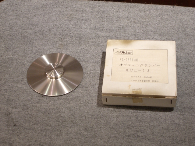

Because the compact disc is designed partly quite different (thickness, inner hole diameter, internal damping of material) is this statement in my opinion not the last word
A long thead I must read, but unfortunately not many helpful informations I have found.
Here a small collection of four transport mechanism, I have heard about:
1) JVC EXU-901A with Optical Pick Up JVC OPT4 (Optima 4) used in
http://www.xs4all.nl/~hansvt/pdf/brochures/KPS25s.pdf
GT-CD1 YAMAHA HiFi-Do McIntosh/JBL/audio-technica/Jeff Rowland/Accuphase
VICTOR CDƒvƒŒƒCƒ„�[XL-Z900‚ÌŽd—l ƒrƒNƒ^�[
http://www.phase-tech.com/pdf/CT-1_catalog1.pdf
http://www.phase-tech.com/html_japan/productspage_ct-1.html
http://www.combak.net/pdf/CDP-777Test.pdf
http://www.audioenz.co.nz/2005/images/remiyo_777.jpg
Reimyo cdp-777 image by crystalref on Photobucket

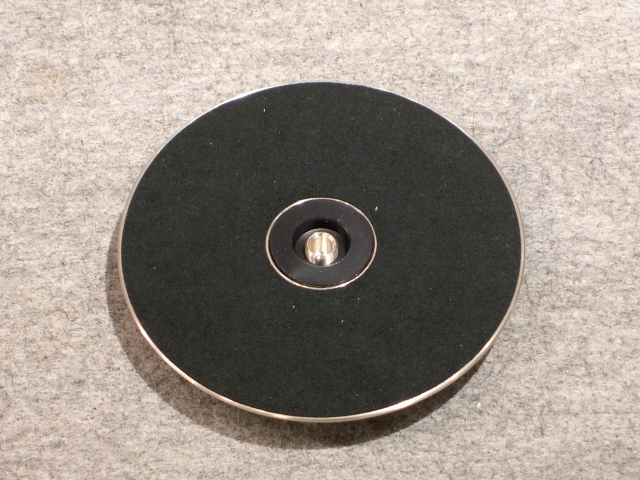

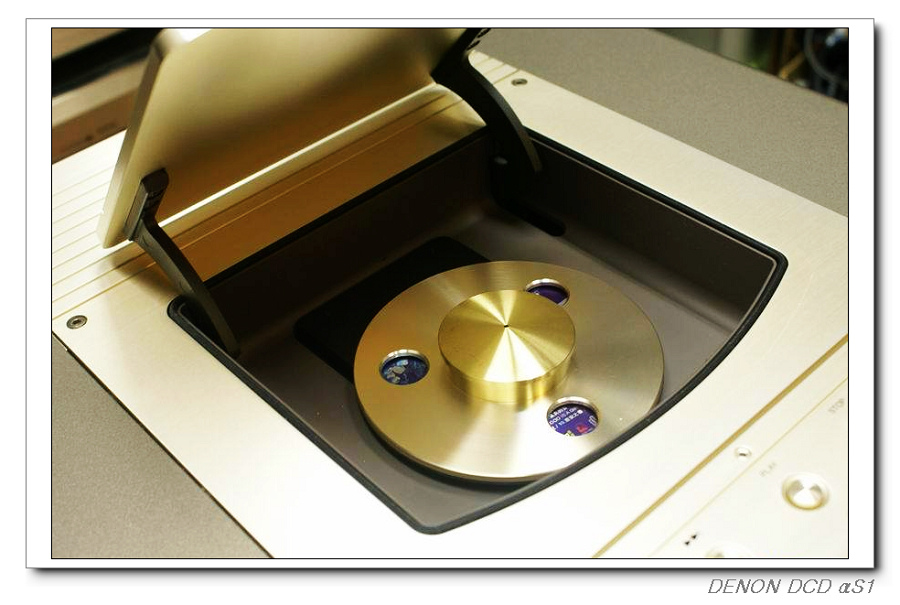

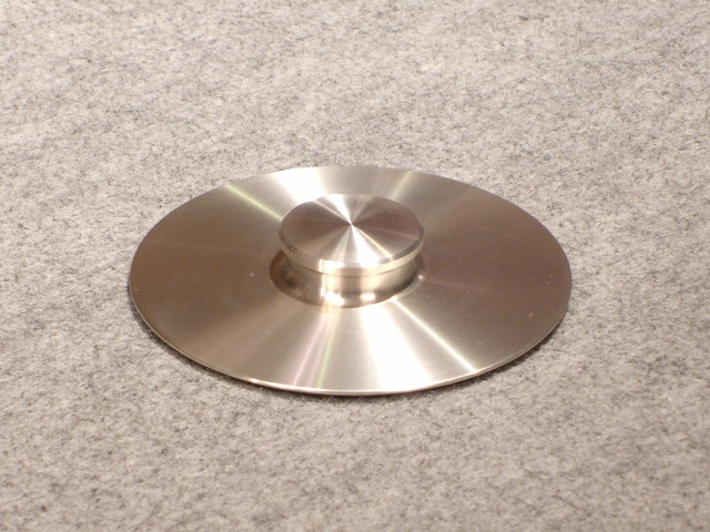

If the answer so easy, as you say, why uses some few ultimate cd mechanism heavy wights for stabilizing the compact disc while playing (CEC, Denon, Victor)? Other claims (mainly computer acessory brands), there are cleanest traces and stable eye pattern without this
