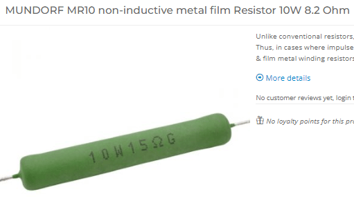

In the short run I will try experimenting a bit with resistors and/or simple networks. Can you say a few things (or point me in the right direction), what sort of specs for the resistor should I be looking at with my 2x20w into 8ohms (voltage source) amp? I calculated roughly that my hairline speaker wire (26awg 5m) presents around 1.5 ohms of resistance, which in turn "equalises" the FR by ca. 2db or so between the mids at 8ohm and Fr (resonance fr.) at 128ohm.
I would like to try perhaps and 8 ohm resistor, that should 1/4 the power available (5w), which should bring ca. 6db "equalisation" and go from there. What do I need to be careful about shopping for one? What is the power rating that is suitable? 5w, 10w, 20w? Do i need to worry about (parasitic?) inductance of a resistor? Does it make sense to go for high quality 20w mundorf resistor, vs something generic (in terms of sonic degradation)?

I wouldn't worry too much about anything except power handling at this stage considering we're talkng speakers.. and I'd get a few values of simple wirewound resistors.

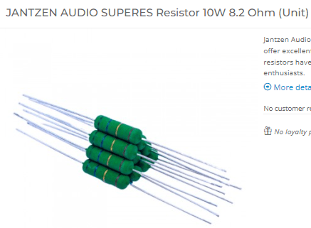

Is my maths correct when I assume i need 2-3W (say 5w) power handling spec for resistors between 2-8ohm, given that the drivers minimum impendance is 8ohm and amp's power rated at 20w into 8?I wouldn't worry too much about anything except power handling at this stage considering we're talkng speakers.. and I'd get a few values of simple wirewound resistors.
It doesn't hurt to get higher power handling than necessary. It is somewhat uncertain what they'll actually dissipate.
10w ok? something like these? Sorry for being anal, but want to make sure I'm not missing something obvious (to you, but not me).It doesn't hurt to get higher power handling than necessary. It is somewhat uncertain what they'll actually dissipate.
I have 2 ways I approach a situation like this. Either can be OK.
a) Use an oscilloscope to watch while I listen.
b) Make an educated guess, then monitor for signs of heating. Feel the resistor after listening to something louder than usual. Keep the resistor where you can see if it releases smoke. Keep it elevated from flammable surfaces.

So you are saying 12,5 W for an 8 ohm resistor, given that fostex are 8 ohm and the amp is rated at 20w into 8 ohm, correct?ROT for industrial power apps = resistor rating 2.5x min. power supply rating, so see no reason why it's not valid at audio power rated apps.
