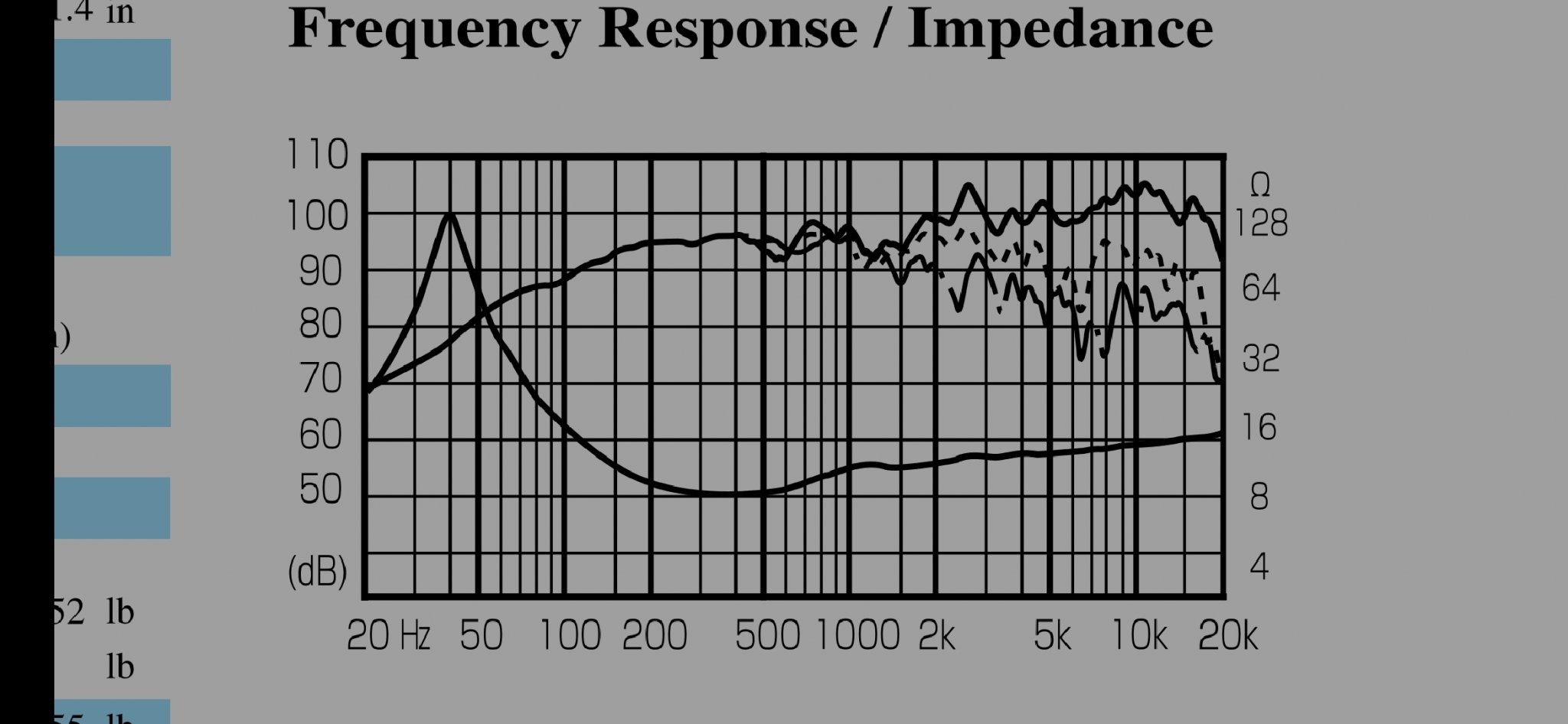

Thanks, but what are you refering to with IME and BW? If i understand correctly, simply adding a resistor (or this really thin wire which i have installed now) will cause LF shelving, which is supposedly worse than "tracking" speakers impendance? Here is the FR and IR plot from fostex doc. Fairly flat IR with very high peak at drivers resonance frequency. Havent seen an "in box" IR chart tho..Likely IME.

Not familiar with the ACA, tri-path, but again, the pioneer's amp designs will track impedance whereas just outboard series resistance causes broadband shelving, i.e. trading efficiency for a wider/flatter in room BW, so the (mid) bass response tracks the horn's gain BW, which usually means more real gain in acoustic efficiency where we need it most = less electrical power required for a given SPL.

Those TPA amps also don't have a high Rout i'm afraid. High Rout amps are now rare and not common availeble, as the trend in the mainstream hifi is class D (very low Rout amps) and multiway low sensitive speakers. Current offers of class A amplifiers are very limited and very expensive (Pass Labs & First Watt are the main brand). In the diy section there is more to offer. The easiest way will be a pair of ACA's in mono bridged modus. The Firstwatt amps are indeed also an option, but harder to source parts if you do a diy and expensive when you buy them build. Some amps like the Marantz PM5004 I work in class A for the first few watts and then go to class AB. I had success with my Marantz PM5004, but it's successor (PM5005) is a different beast and pure class A/B as the topology changed to current feedback.
not sure. i found that Pass' article in which he discusses the topic, i will go through today. I think he mentions 46ohms for fe206e (maybe similar to en version i have).Do you know how much resistance you need? It may be possible to use a fixed resistor.
But the "trick" from dave, using a ultra thin wire seems to be doing the work. Using 5m of 26awg solidcore wire atm.
