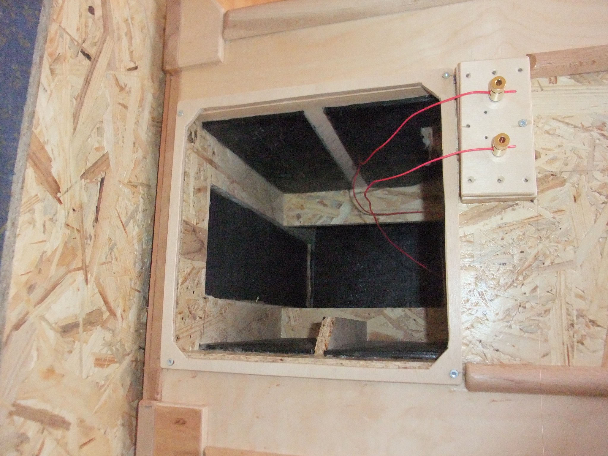

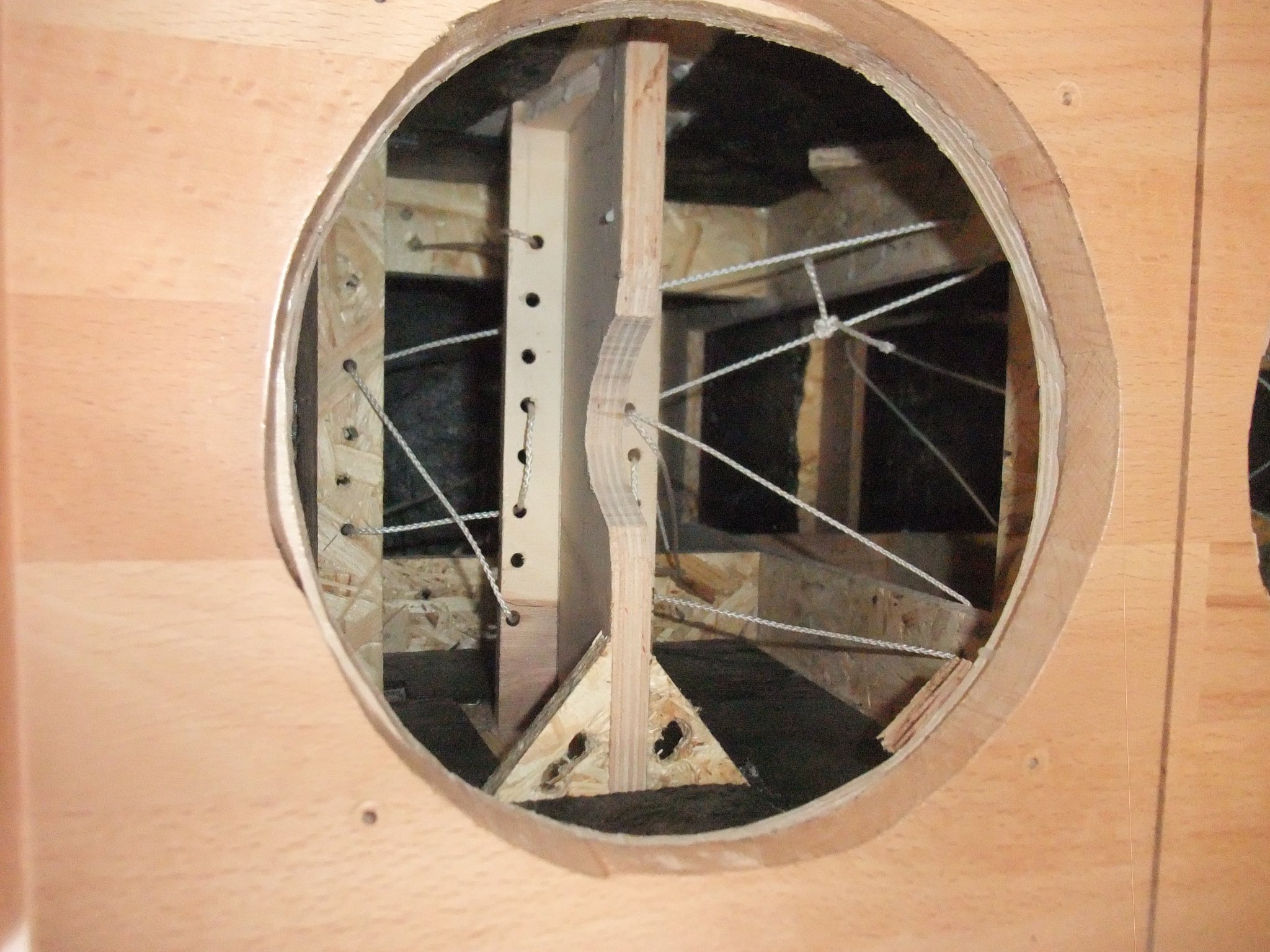

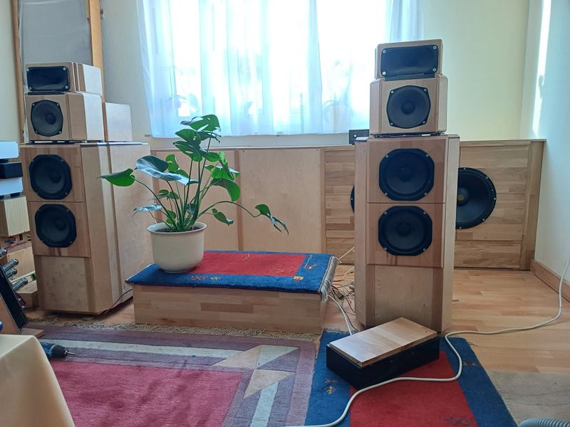

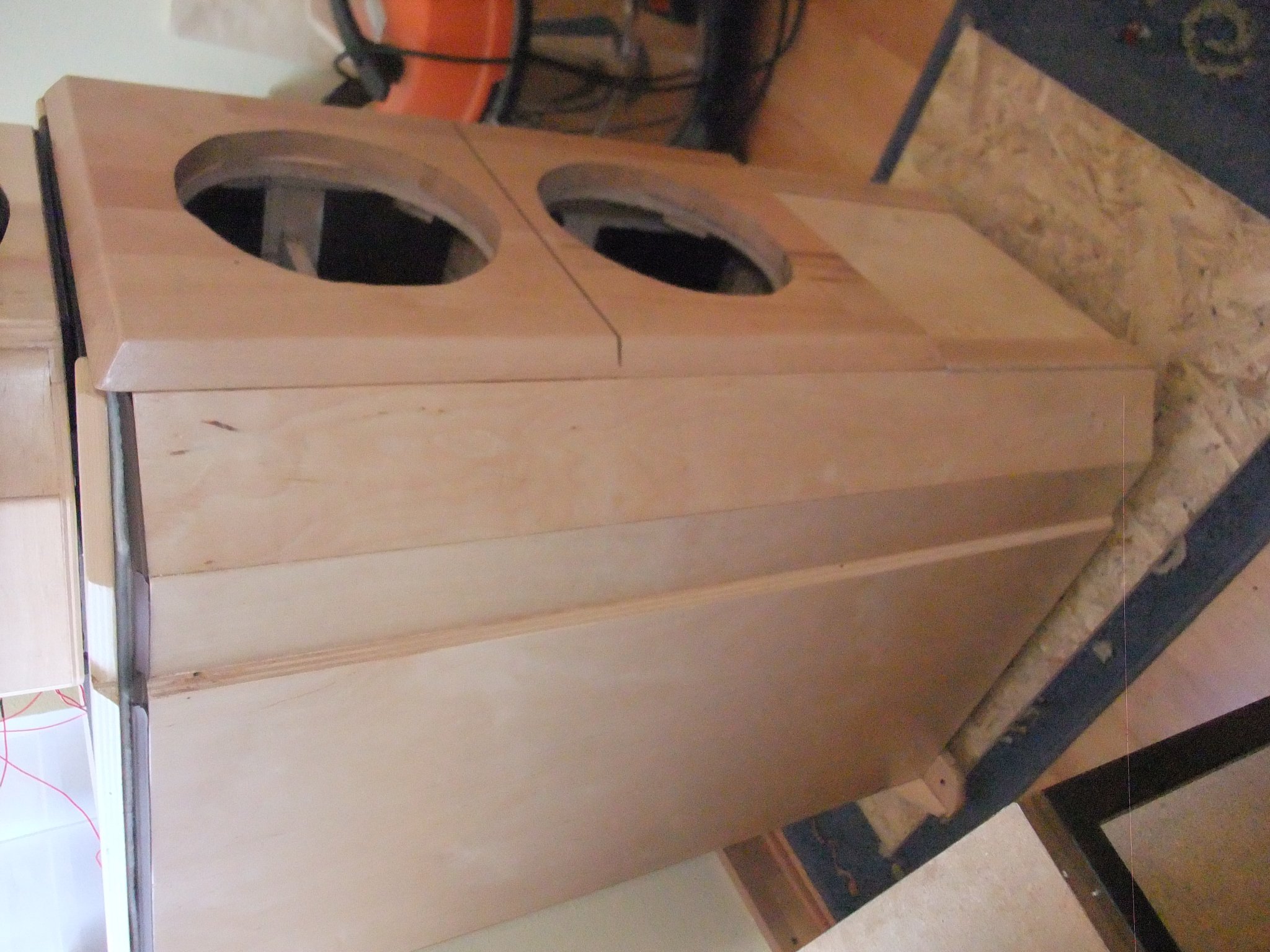

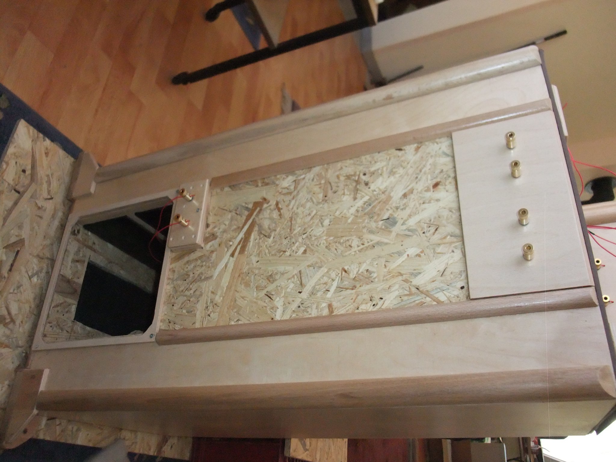

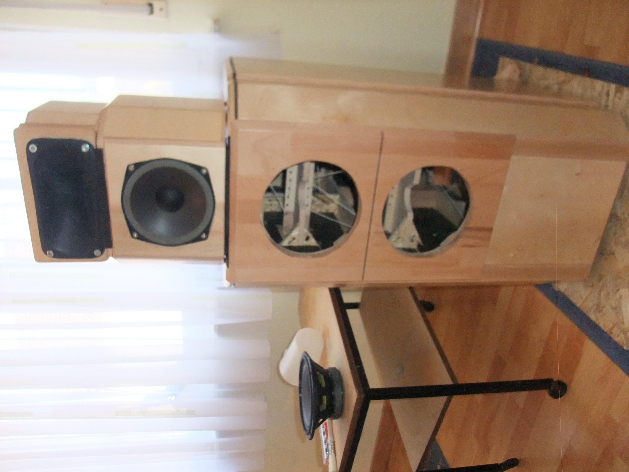

In this case I prefer a so called boom box alignment to get very loud area around the tuning frequency between 60-100Hz.Interesting suggestions and thoughts 👍
I would definitely skip deeper bass below 50Hz for better definition and detail in the upper mid-bass area. And this is also the reason I reopened this tread. I wanted to expand on the use of woofers today, where we no longer need very deep extension, since subwoofers can take over.
Pattern control with cardioid designs, might be the next step, since masking might drown benefits from better drivers - cant hear the subtle effects, when the room reflections "hides" the details - so to speak. - But that is a whole other story.
Due an additional high pass filter the whole frequency response is flat with f3 of approximately 45-65Hz (dependent of the volume for enclosure).
Perfect condition you will have, when no compression effect occurs on the vented area.
Therefore it is absolutely necessary, that the surface of vented port is at least 50% - better 100% - i. e. the same Sd value of surface area of the cone resp. diaphragm from the used driver resp. transducer, normally given in square cm. This is only possible with a boom box alignment.
check out this URLs:
https://web.archive.org/web/20230521074300/http://www.wjjhoge.com/Electroacoustics/bb4/bb4.html
https://www.andyc.diy-audio-engineering.org/vented-box/index.html
https://www.diyaudio.com/community/...4-alignment-wanted-for-fostex-fe83nv2.394690/
https://www.diyaudio.com/community/...fer-using-a-cap-instead-of-a-resistor.273701/
check out the pictures in post #5 under
https://www.diyaudio.com/community/...oofer-precision-devices-pd2150-inside.197034/
the last image show an example for such a BB4 vented box equipped with a Fostex 12W360 and first image in post #1 under
https://www.diyaudio.com/community/...rom-magazines-voice-coil-or-klang-ton.404044/
datasheet of this driver you will find in post #166 under
https://www.diyaudio.com/community/threads/best-woofer-50hz-300hz-hi-eff-maybe-15.158170/page-9
an example with two 8' drivers from Fane - go to
https://www.fane-international.com/downloads/FANE-SOVEREIGN-PRO-8225-DS141117.pdf
are in the attachment; excellent driver, no compression effects are to note; tuning frequency approximately 55-60Hz, volume without wood plates and sand filling: 80 L
