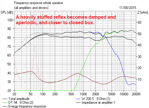

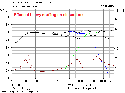

As you introduce more of the stuffing in the box, the air gets stiffer
and the spl of the driver goes down. To produce the same spl like
with the unstuffed version, you need to increase the force to compensate
for the loss. Modeling programs do show how the effect of stuffing
decreases the spl and Qtc by lowering the Qms ( Fs peak lowered in magnitude).
Actually Lojzek, I have looked inside, and even built a few reflex speakers. You usually carefully place a bit of light BAF wadding or eggcrate foam near the sides in a reflex to control the midrange leaking out through the port in reality. Not to affect the bass.
The theory of reflex (aka Helmholtz Resonance) says let the air move freely from the bass to the port. 😎
You CAN heavily stuff a reflex, but then it's not a reflex anymore. It's an aperiodic or damped reflex. Closer to closed box. FWIW, to damp the port you insert drinking straws! It can sound very good, and might even be the answer here.
But back on topic, acstcwrfrmn. I built a 30L box with a Qts 0.33 Reflex Driver and stuffed a sock in the port for giggles. TBH, it really didn't sound half as good as a proper old unobtanium Elac closed box driver in 30L.
But I don't see why you couldn't take a chance on some high Qms 8" reflex driver in 30L of closed box. After all, you just cut out a reflex tube and lower the bass coil value appropriately if it doesn't really win a cigar.
