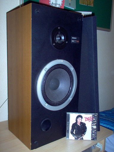

Just to show off my latest 8" + 1" reflex, it has that lovely old efficient and cheap Sony corrugated surround woofer I enthuse about with the transparent cloth dustcap. Mylar tweeter. BW3. It's almost a PA woofer, and sounds fantastic. I'll talk about it elsewhere.
acstcwrfrmn, I think you should give up on the closed box idea for now. Unless someone has a brainwave. Just turn the bass down when you listen to Toccata and Fugue on your 30L reflex. :D
