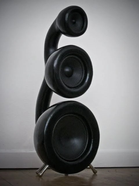

I could also make a larger profile/waveguide for the KEF midrange, to fit with the wider cabinet. Or maybe make 3 bowls with the KEF in the middle and 10" on top and bottom.... almost like this....
https://ikeahackers.net/wp-content/...AAAAZjM/MNagXja034g/s1600/IMG_0470-772277.jpg
