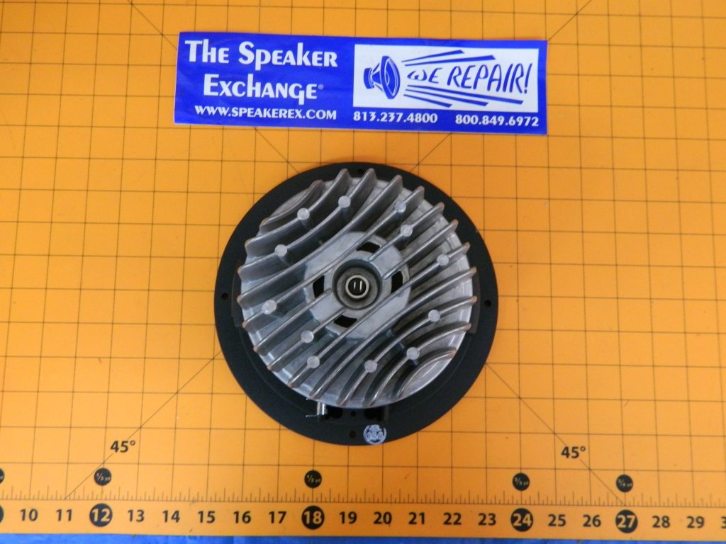

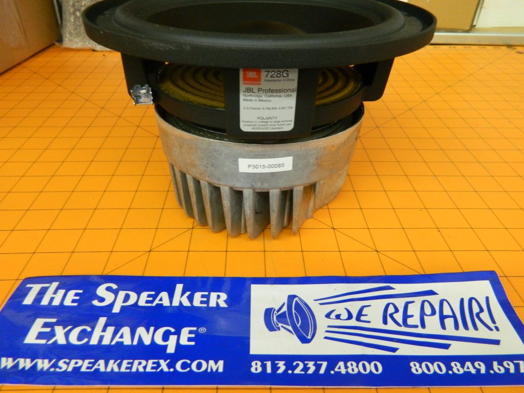

I just saw that the JBL 728G has become available from speaker exchange:
https://reconingspeakers.com/products-page/jbl-5047951x-model-728g-8-woofer-for-lsr708i/

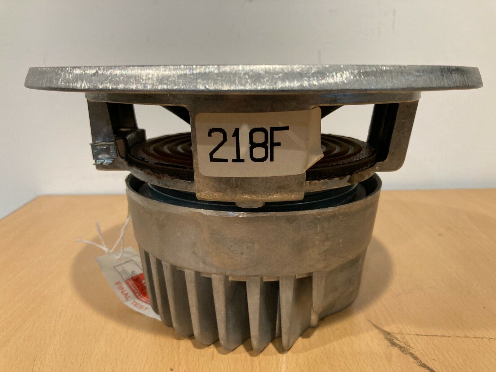

At the time that I was looking into a high excursion high performance 8-inch woofer for a two-way, this was my dream device. T/S parameters were only published for its predecessor, and it was assumed they are very close in their specs:
218F:
728G:

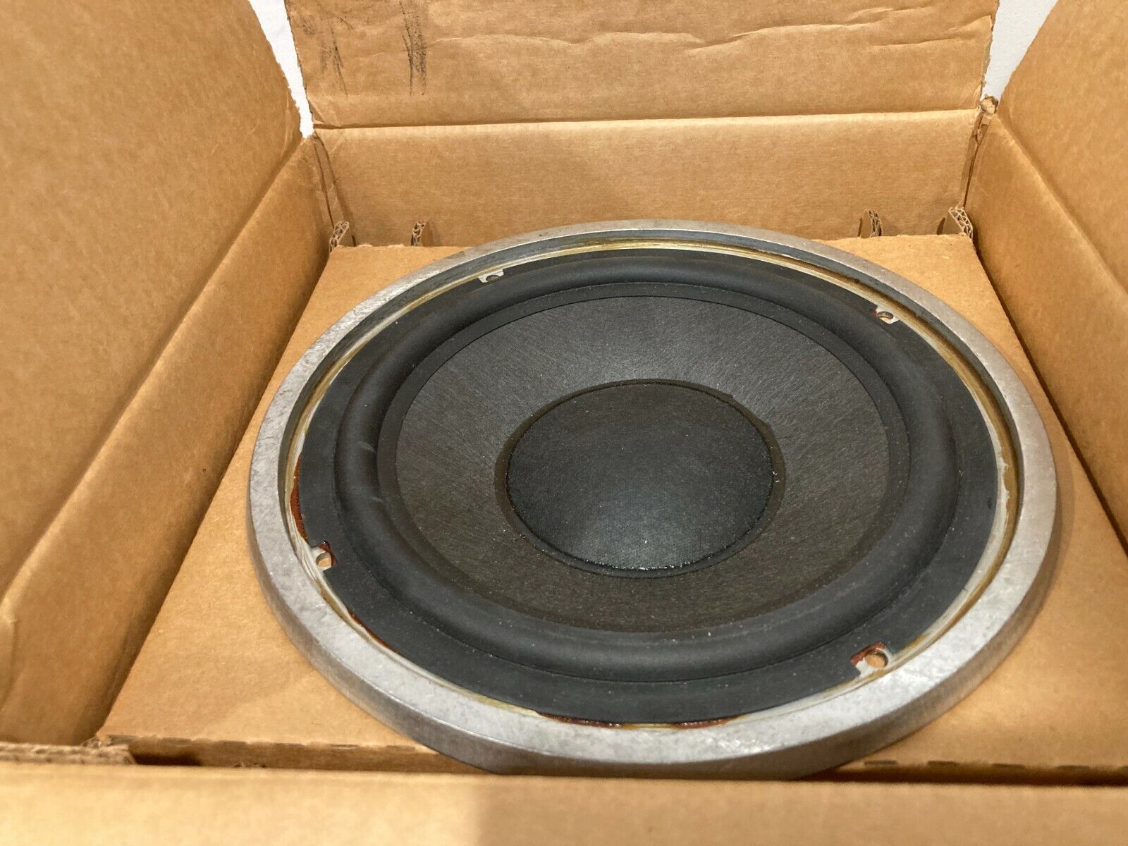

Judging from this ebay pictures of the 218F, basket is the same, but diaphragm material was somewhat changed from reinforced paper bulb to some coating of sorts:The specs of 218F are:
fs: 45
Qts: 0.38
Qms: 4.2
Qes: 0.42
Vas: 26*
EFF: 0.55
PE: 200
Xmax: 15.7
Re: 1.8
Le 0.15
Sd: 0.215
Bl: 6.1
Mms: 31
*(must be liters, despite they say imperial cu ft, which does not make sense at all)
218F:
728G:
Seems like a very stiff suspension, with a Cms of just 0,31mm/N. To me, that means that you won't get bass below around 125Hz from this driver, without a ported cabinet. That means, I'm out 😊Celestain CF0820BMB
