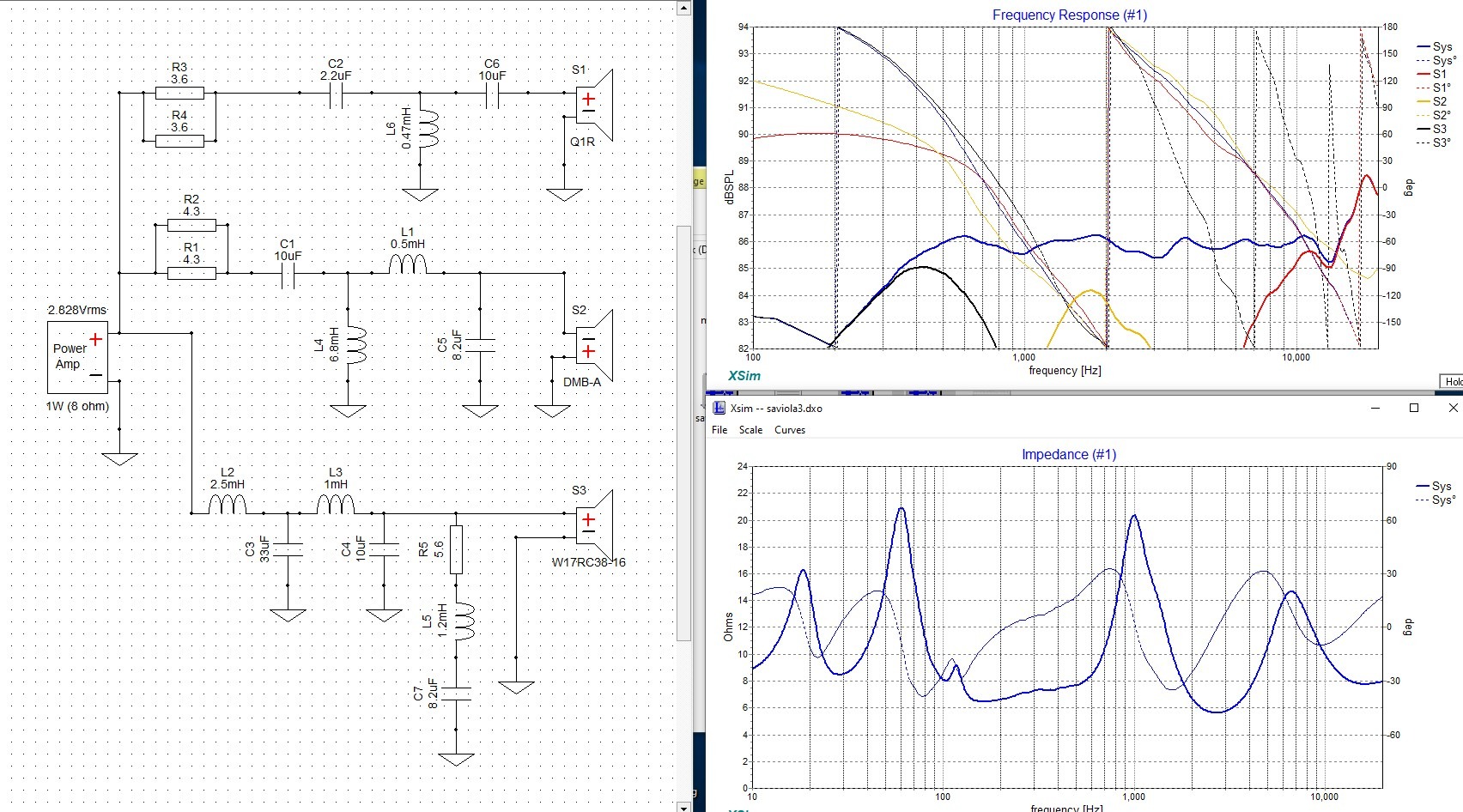

I can reccomend one very cheap and relaxy sounding driver https://www.madisoundspeakerstore.com/approx-8-woofers/silver-flute-w20rc38-08-8-wool-cone/ . well made driver, I have 6.5" 16ohm paraleled for 8 ohm, its my current speakers for everyday for a two years right now, nice sound. PMC like : )
Mid=HiVi DMB-A
tweeter= HiVi Q1R
It was hard to pair drivers and getting it in perfect phase, as you can see on picture a bit complicated crossover, but final result is very good! Step files I have made later so plase pay attention a bit since I didn't made speakers for seccond time, migh be some wrong dimensions on front and eventualy some other bugs! If sound is too bright replace mid and tweet resistors with e.g. 3.8/3.8 + 4.5/4.5 ohm, example. I'm added some pots to fine adjust dynamic. : )
Mid=HiVi DMB-A
tweeter= HiVi Q1R
