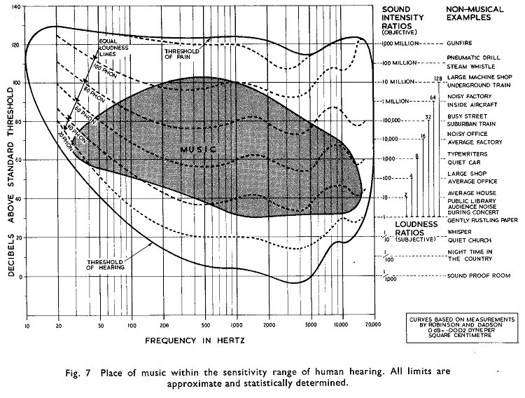

Anyone who listens to music at constant 110 SPL is stupid and risk damage his/her ear drum permanently. We all agree that no one does that.
Music is dynamic. The average listening level in a typical domestic room may be about 65-75 SPL. But there are peaks of a few to a few tens of mini seconds (ms) that can reach 110dB SPL. That's what we mean by "ability to play loud without distortion". The dynamic headroom may be more important to some listener than to others. There is no need to argue about that.

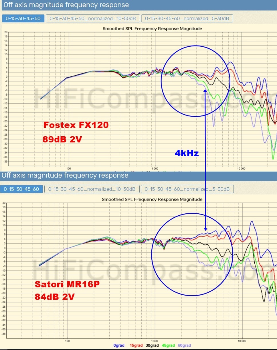

The thing I hate with 5" woofers is the deep cone thick surround roll needed for high excursion. It deteriorates upper end off-axis response smoothness very often, seen as response wiggles between 2-4khz. Heavy moving mass might be a caveat too.

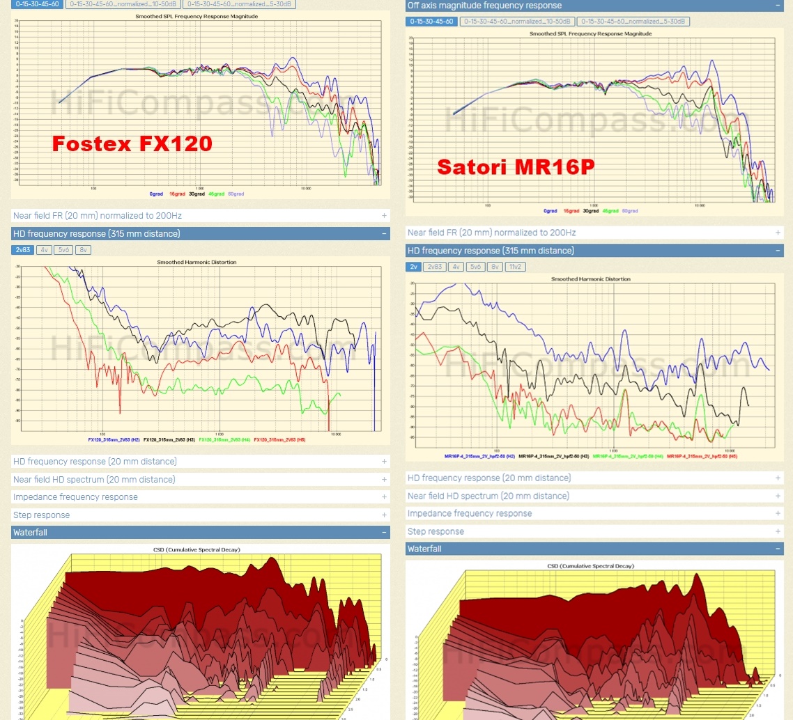

Please remember that Fostex has 5dB higher sensitivity, and distortion was measured at certain voltage, not dB level. But yes, Satori has better motor.
The most striking difference is off-axis response behaviour from 2kHz up, for the benefit of Fostex. A midrange is often asked to be crossed at 300/3000Hz, even 4-5kHz and shallow slope LR2. Satori has rapidly rising directivity right above 2kHz because of it's deep cone and thick surround roll, which will make troubles in off-axis response - unless crossed LR4 around 2kHz like any modern 2-way speaker.
I haven't heard either, this is just speculation, but I would choose Fostex for a 3-way!

Hard-pressed paper cones for midrange has been tried in the Jenzen SEAS ER and SBA 61-NRXC and both drivers need either notch filters or 4th order crossover to deal with cone break-up. The Satori MW16P is an unusual driver in having a frequency response all the way to 15 kHz, like a full-range driver. Waterfall plot suggests modest cone break-up and a driver suitable for low-order filters. Doing 15 kHz doesn't suggest using it as a full-range driver although I admit it has been heard with good results from a two-way having a point of crossover around 10 kHz. Quite remarkable.
But the Satori MW16P has rising HD2 below about 600 Hz. It is not in the league as the other midwoofers I am considering in term of distortion. So the Satori MW16P is good choice for a midrange in system using low order crossover. It does not meet my need for low distortion in the mid bass.
The upper midrange cone breakup is in most midwoofers and not difficult to remedy.
Besides, Satori costs twice as much as the SB Acoustics 5" AL cone.
