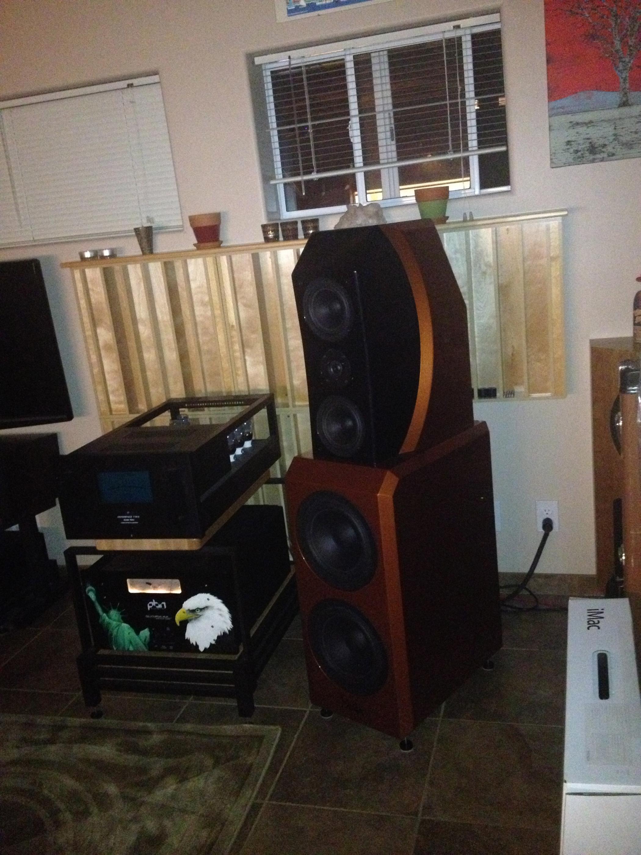

I am "re-doing" my active three ways, currently with 8", 5" and 1", to 10" SB Acoustics and will keep the XT25G tweeter. I have a Peerless 5 1/4" mnid in the form of 832873. Peerless 832873 HDS 5-1/4" Woofer 299-126
While I'm generally happy with the 832873, there are two problems; one the truncated sides which will cause grief when trying to route the hole, and, two, the desire for something "better".
I am asking for opinions on the "best" midrange in that size and price range only. "Best" for me is low distortion and ability to play loud without distortion. I don't care about "warm" or any other subjective-like term; I only want clarity in reproduction. It also needs to cover from roughly 280 - 300 Hz to 3,000 - 3,500 Hz. Please only post if you have direct experience with a driver, having used it, or having seen and heard it used in a similar situation to mine?
