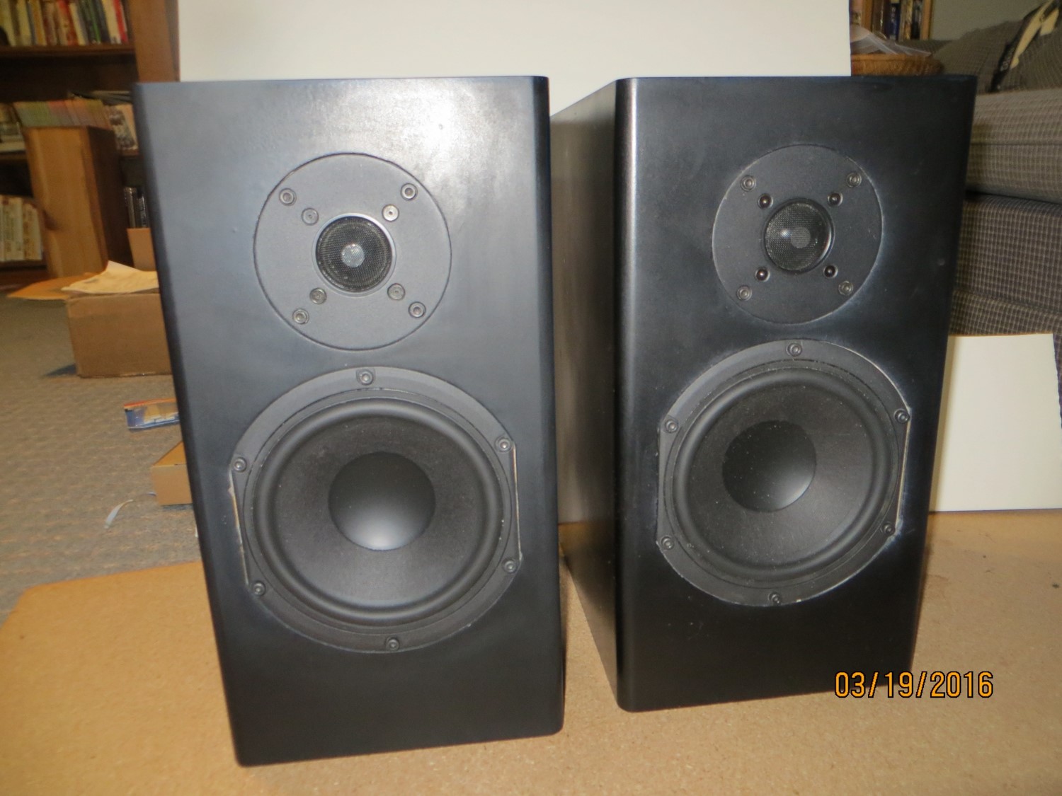

Considering manufacturer's spec are mostly unreliable, Zaph's data is much welcome. The Q(ts) is higher which is good. The Fs is higher slightly which is ok. The most encouraging is:
But some warning too:
The frequency response shows a rising about 1 KHz, but a broad dip between 2.2-4.2 KHz. Will a LR4 at 2.8 KHz be good enough to handle this? Any first hand design, listening experience concerning this issue of the Aurum Cantus AC130/CK50?
John "Zaph" Krutke said:Class leading non-linear distortion.
John "Zaph" Krutke said:The only real downside to this driver is a ragged top end that would require some work to hammer into a target slope. It's too bad they didn't use the cone from the AC130F1, it's one of the best cones made aside from the Scan Speak Revelator.
When I built my 6.5" bookshelf using the Peerless Nomex 830875, I found it necessary to use a notch filter around 5 KHz. The crossover was a 2nd/3rd order passive. The notch filter is needed to make the woofer cone breakup inaudible.
The crossover for a modest DIY bookshelf speaker project
I wonder whether the notch filter can be left out using LR4 crossover and the Aurum Cantus AC130/CK50.
