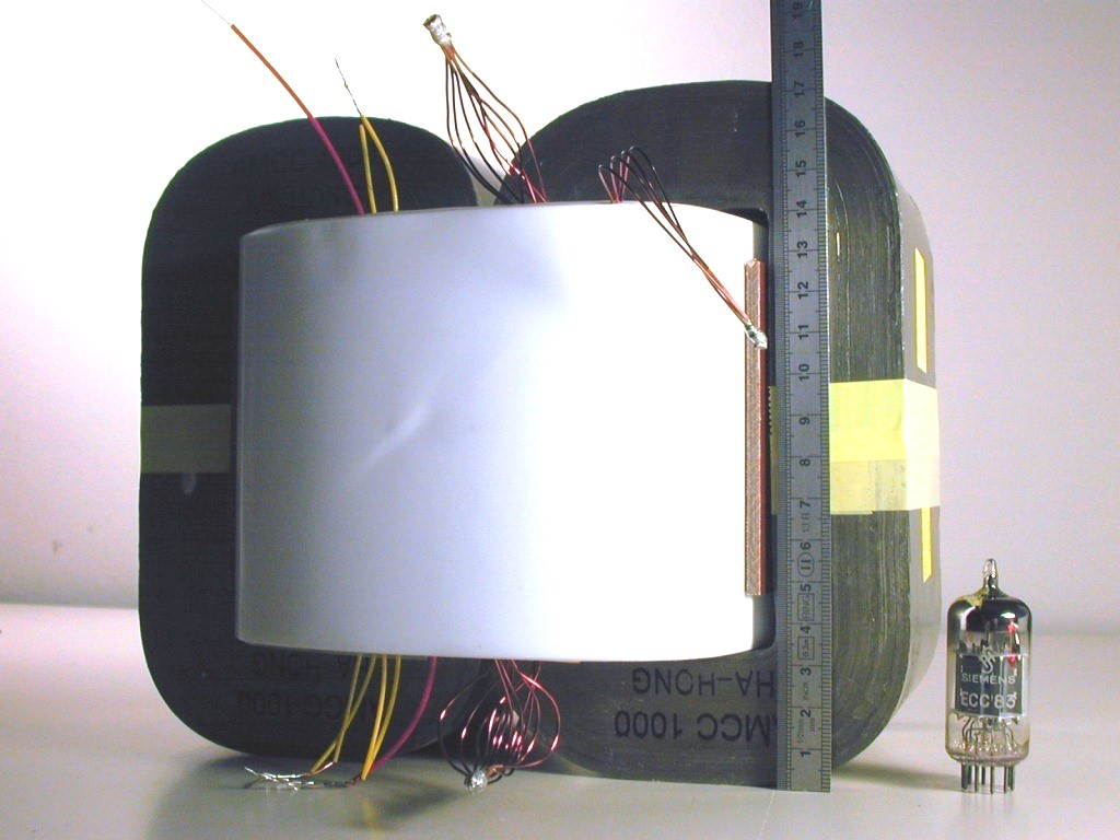

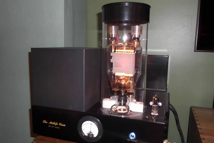

I built my Midlife Crisis Amps with the Monolith S-833 OPTs, Summit series. Amorphous double-C core, teflon inter-winding insulation, weigh 62 lbs each! I've attached a picture taken during their construction, before strapping and potting.
The amps sound incredibly good. Seemingly unlimited power, clean sound top to bottom - will shake the nails out of the walls on Metallica and make you cry on Perlman. I can't think of a better review for the Monoliths than that...
The OPTs cost a small fortune but I will have them for the rest of my life, and then my son will have them for the rest of his life. Small change when you look at it that way.

Are you sure they are amorphous? They told me they only do GO SiFe for single ended output.
If these are the ones, and I believe they are, then yes.

That is a bit perplexing... my application was for much lower voltage handling when I asked. Ward even gave me a pretty good explanation why they won't do amorphous for high power handling.
If you look at the picture I posted above of my transformers in the process of being built, you can see the code AMCC1000 on one of the cores. These are Metglas amorphous cores:
http://www.elnamagnetics.com/wp-content/uploads/catalogs/Metglas/powerlite.pdf
All the way at the bottom of the table is the AMCC1000, the largest they offer.

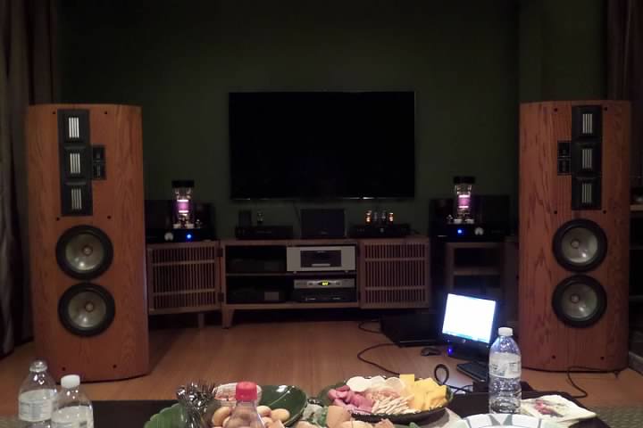

May I ask what speakers you are using with these (monster) amps?
Nicely worded...
These. Infinity RSIIb, circa 1985. Gutted and rebuilt with external passive crossovers, Cardas copper litz wiring and new midrange driver diaphragms from Apogee Acoustics.
Picture from an audio gathering I had in November.
Thanks for clarifying.
