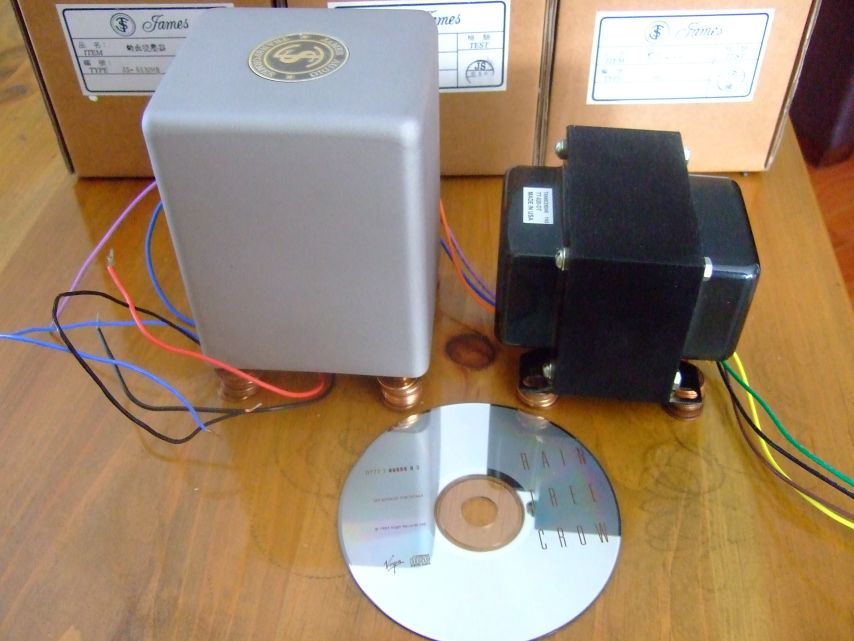

Yes, mine are the SA08S, with end-bells. I can't imagine any reason to encapsulate them, unless you live in a log-cabin, or a beach hut.
The Sowters sound really fine, and they always inspire confidence with the build quality. Absolute perfect alignment of all the laminations, perfect finish. They are tested at 2500V, to boot.
Their 65kHz of bandwidth in a 25W-handling design seems as good as you could want, and leaves room to try muscle-300Bs or higher voltage SE amps. The primaries in mine measure 81 ohm dc.

I think most people choose encapsulated for aesthetic reasons (though personally I'm not sure personally that a plain metal box is more attractive than an open frame + bell ends), or possibly for the possible benefits of increased damping. I’d nev r thought of it as a means of climatic protection, though in e.g. SE Asia, it might well be a very good idea!
Are the Sowters’ vacuum impregnated with varnish? My Border Patrol interstages aren’t. At the moment they have thin paper in their air gaps- this slightly wider spacing gives them an almost constant primary inductance up to 35mA dc current. But it’s possible to dis-assemble the core and remove the paper- this increases the inductance at lower current (I keep meaning to do this for my 6N^ drivers which operate at 16mA- removing the paper would increase inductance from 49 to 95 H).
Border Patrol did a lot of listening tests with various designs, and found that the un-impregnated transformers sounded best to them. Does mean they act a bit like a very low efficiency speaker ....

Could you give us an idea of the sound quality of the James OPT compared with the Transcendar please?
I haven't had the time to try James output transformers. The other day there was an ad on Canuck Audio Mart, the fellow was selling James transformers and I went to buy a pair since the price seemed right. How right? To this day I think that Mr. Patrick Turner is the most honest transformer winder on this planet, for one simple reason – he doesn't hide what's inside his transformers: wires, insulation, iron, layers, strategies etc. No other winder does that, period. If shipping charges from Australia were not brutally expensive, I'd own a pair or two of his transformers (I still might if the time is on Mr. Turner's side – long you live old man!).
On one of the websites it's said that James JS-6132 weighs 5.2kgs (it turns out later that the actual weight is 4.8kgs...) and the dimensions are 106/96/130mm. I then checked those dimensions against a similar (5.2kg) transformer that Mr. Turner has for sale and concluded the following: James trafo with enclosure and potting compound is still smaller than Mr. Turner's transformer of the same weight without enclosure and potting compound. Smaller diameter wires? I thought... Still, not far off and the price was nice and the sale was local and...
Once inside the man's basement - I was shocked. Ten plus amps, all with James transformers, many many boxes full of James and other transformers, a room full of electronic instruments, boxes full of tubes... Talk about a kid in a candy shop... The man told me how ten years ago he ordered two thousand pounds of James transformers from Taiwan... I was looking at what was left. I knew then it was now or never again, so I – in addition to two output transformers – bought two James chokes and a power transformer. Now that the initial euphoria is over I'm still positive I've done the right thing. Double C-core, relatively heavy, reputable engineers... No, I'm not throwing my 20W Transcendar pair away, it simply shines in plate-to-plate FB circuits (EL84, 6V6,), in Tubelab Simple SE, and in 2A3 circuits...
