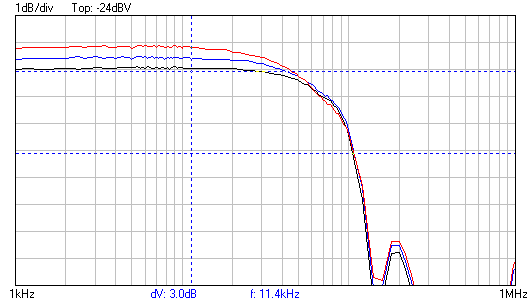

Understood. Not too concerned about LF because of separately powered subwoofers. I went ahead and purchased the lower current (90mA) James Audio JS-6123HS because of your input. The 5K primary tap is listed as 18-52KHz @ -2dB, so although maybe not perfectly ideal, it seems to be a good compromise between price and quality.

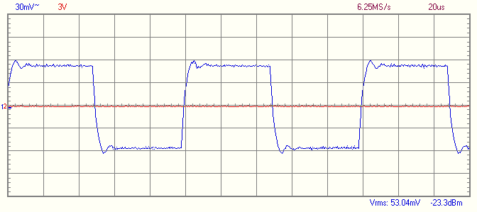

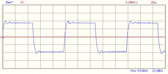

As you can see in the (6123HS) 10kHz SQ picture, resonance below 100kHz causes some ringings (in the output signal upper and lower horizontal lines). These anomalies occurs distortions and discolourations in the music.
If possible (most manufactures hide frequency measurements) choose such an output transformer, which is free from resonances (at least below 100kHz).

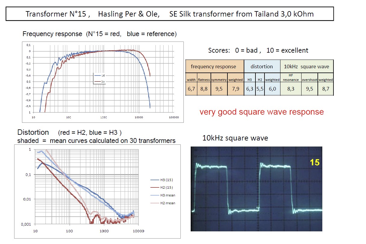

I think that AN Trans152 is an average model, thus Silk transformer looks better. 🙂
ETF 2009:
European Triode Festival - ETF2009 Shootout
http://forums.melaudia.net/attachment.php?aid=1228

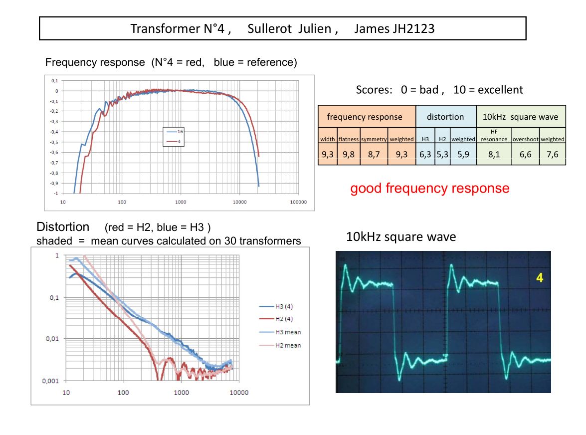

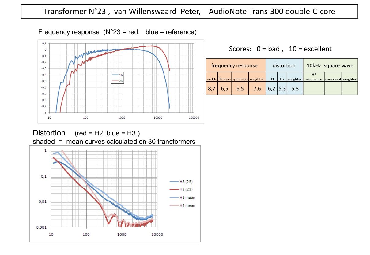

I'm not convinced that this comparison is realy correct in every respect. For example some of the transformers has not been examined by scope (for example AN300), thus its 10k SQ score not evaluable. Upper frequency limit was 20kHz. If 20-100kHz contains resonances, it's not visible on this picture (only 10k SQ pic shows these types of faults).
IMHO James frequency response and distortion score is better, than AN300's, but 80kHz resonance is visible in 10k SQ picture. It spoils the evaluation.
