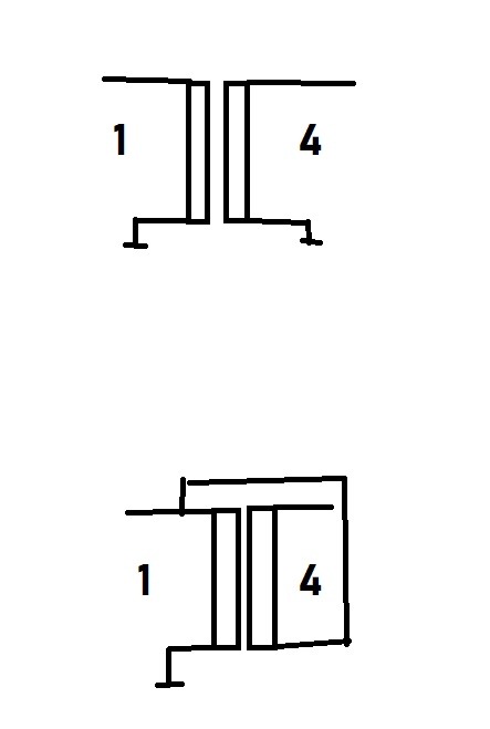

Just a thought: Have you tried wiring the SUT as an autoformer? With a little luck you could get some extra gain (1:5 instead of 1:4) without any sonic penalties.

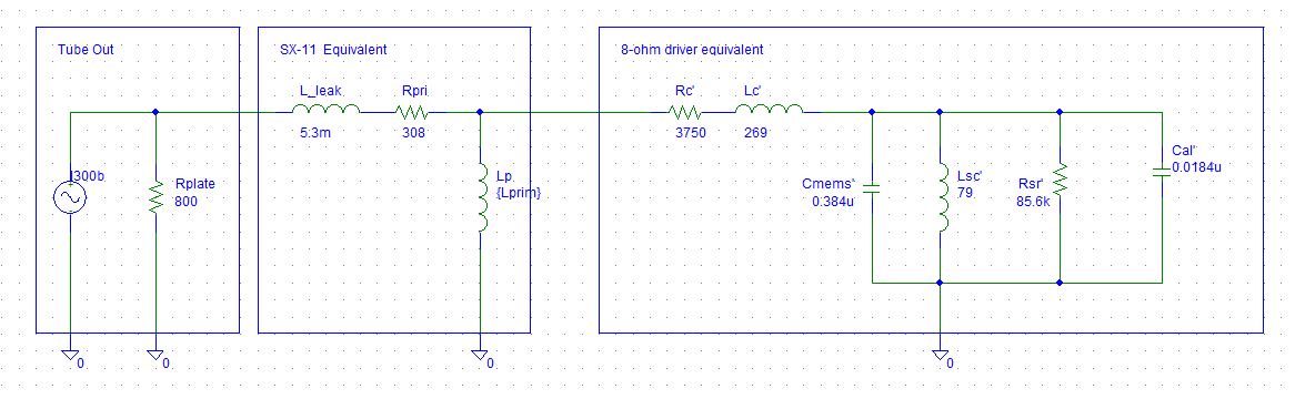

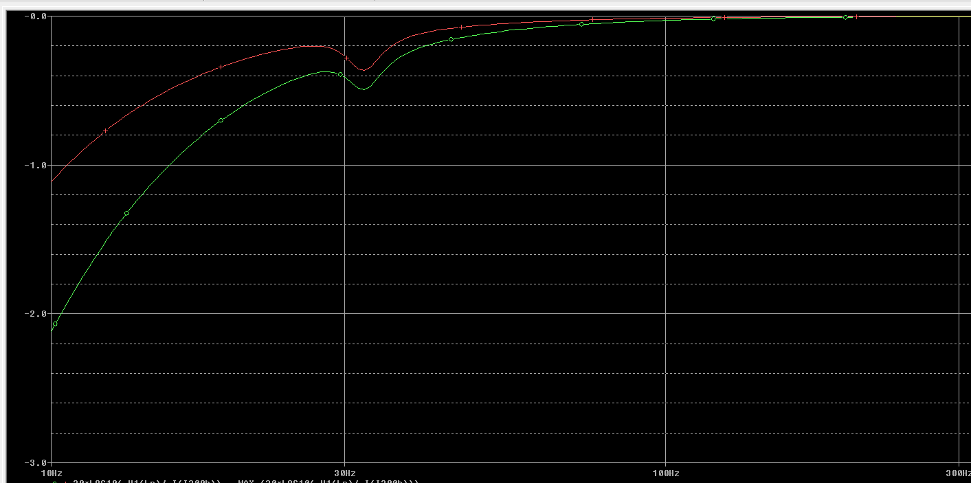

@audiowize I simulated both the MM S-11 (FeSi, Lp=37H) and the SX-11 (Nanocrystalling Lp=24H).
Although the SX-11 cutoff frequency is higher than the S-11, it's still pretty good with a -.5dB point at 22.5Hz and -0.6dB at 20Hz.
The S-11 attenuates only -03dB at 20Hz. I am wondering if those 0.3dB at 20Hz really make a difference to the ear.. 🤔
