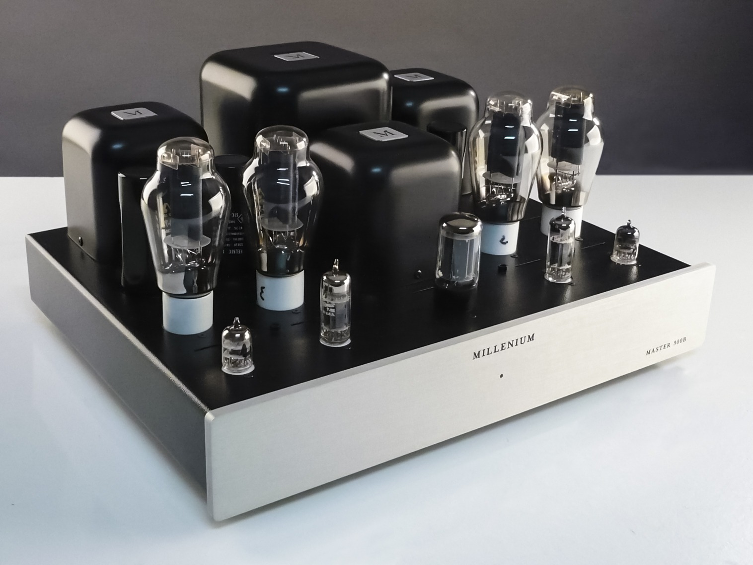

After some s.e. I switched definitely to pp
This one is on the road ( as other) since 2000
