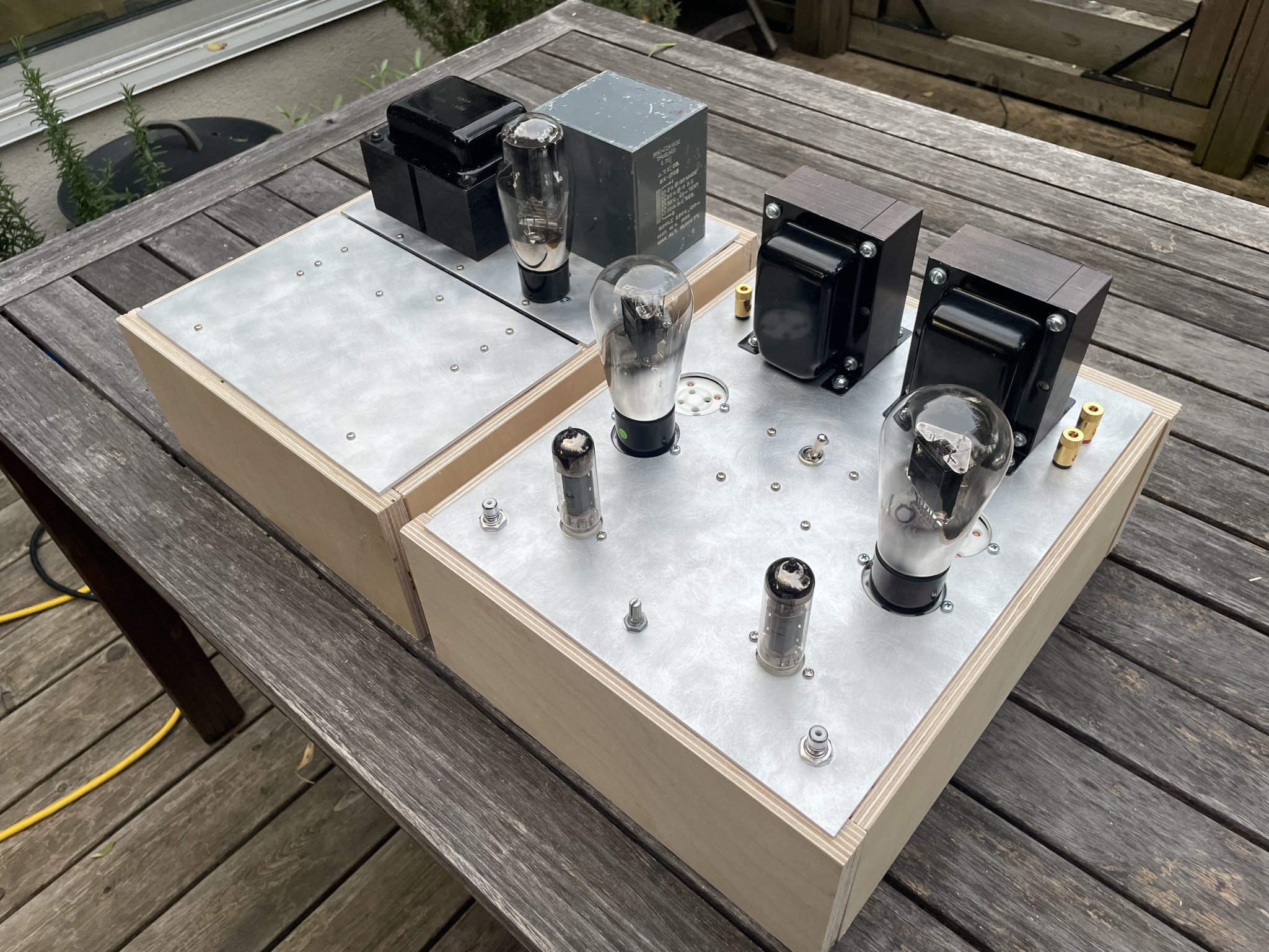

I have installed two sockets on a couple of amps. One was on my 30 to EL84 or 6V6 amp, and the other is my current build, which is a 45 or 46 amp with an SV83 pentode driver. Attached is a photo of this amp. With regular directly heated pentodes run as triodes, it is fairly trivial to install different sockets in parallel, with their own respective circuit because the filaments are usually all 6.3 Volts. The tube that is plugged in will work. With DHTs it is also doable, but somewhat more complicated because the filament requirements vary. I have a switch on my 45/46 amp that changes a pair of resistors on the Coleman filament supply to go from 45 to 46. They are both 2.5 Volt, so it is relatively easy. Changing voltage complicates things more.

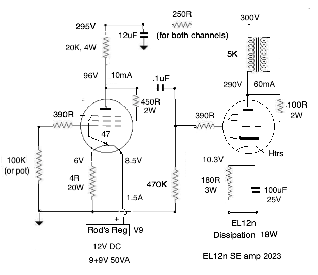

Here's a draft of my 47 > EL12n amp. My daily amp. Excellent tonality, not quite a 10Y > 2a3 for micro-detail but close and much cheaper.
