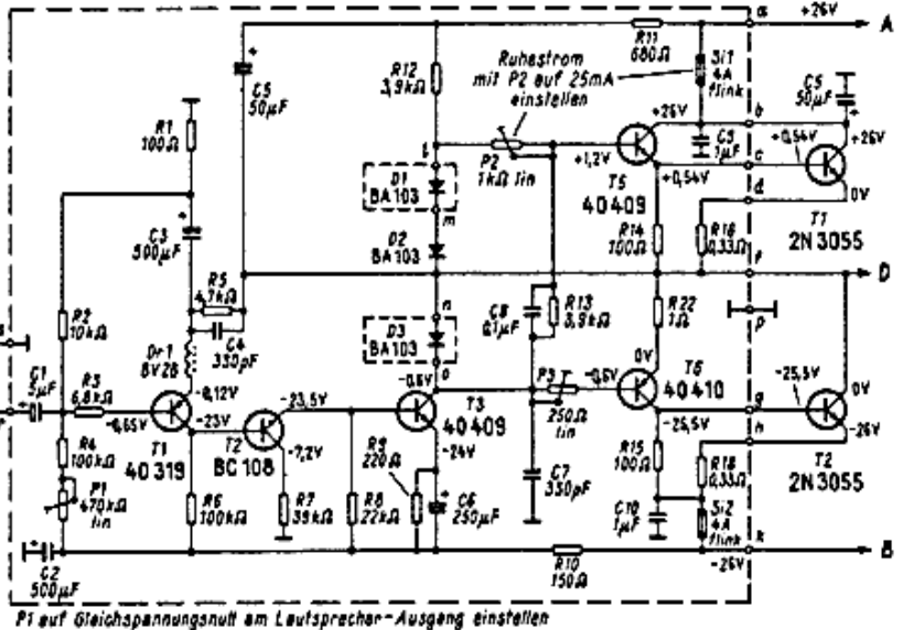

Another classic that uses 2N3055's is the Klein + Hummel OY studio monitor. It was quite modern 52 years ago: fully transistorized, partly active crossover (active between the woofer and the rest, passive between the squawker and the tweeter), amplifiers with DC coupled outputs. See Sonderdruck Funkschau 1968, Heft 8.

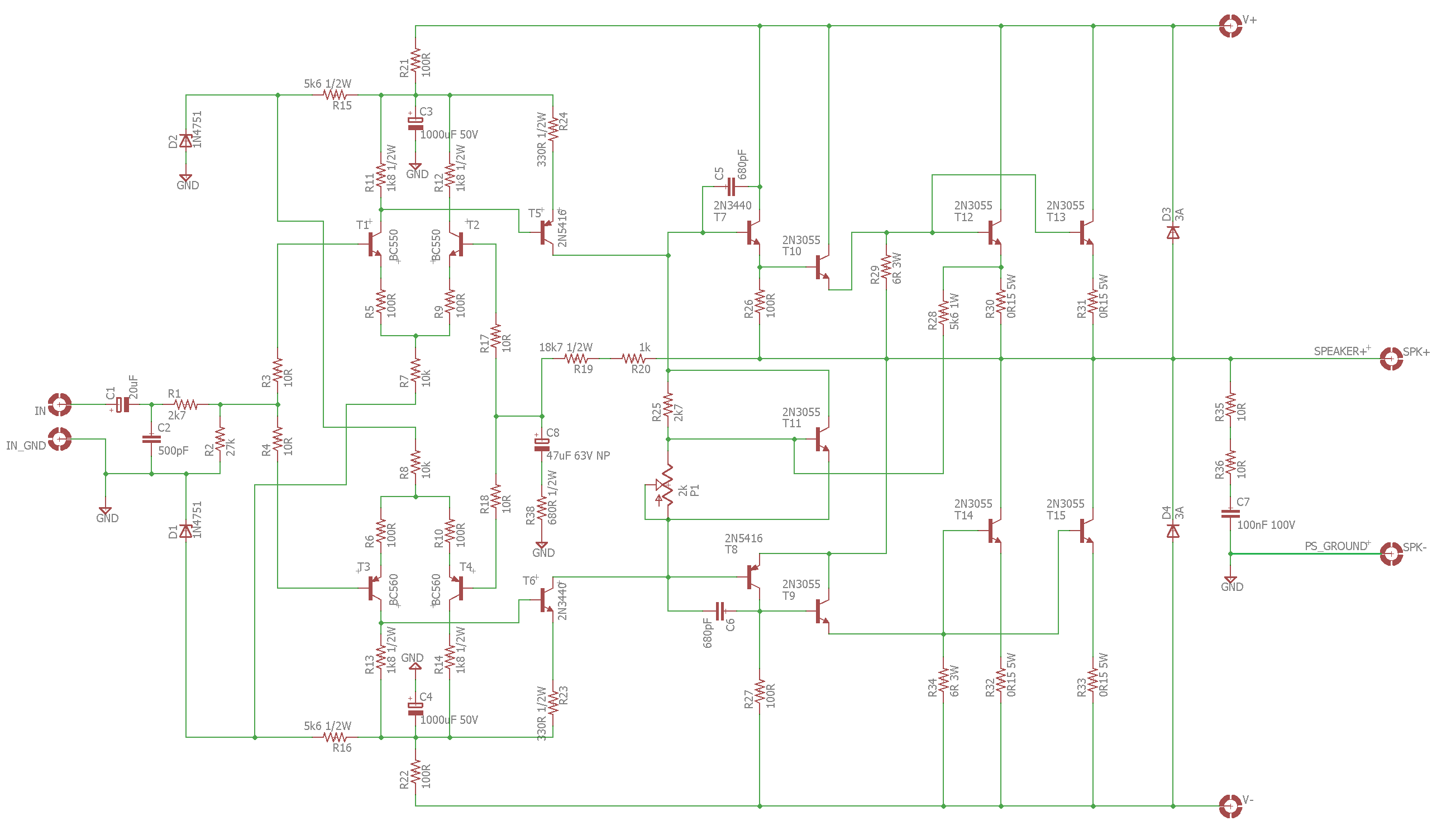

Here is more about German amp, from Russian and East German sources. Even though it's using 2N3055, it seems to be decent amp.

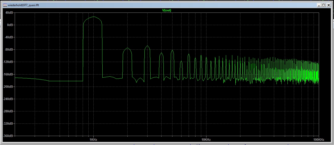

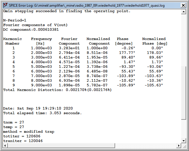

Spice sim attached.
42V rails might be too much for these transistors, but it can do +/- 35V.
With 35V rails, and R2/R4 at 2k5, it can do nice 40-50W amp, with Thd 0.001
Sorry but I only see an overly complicated typical simulated-only amplifier, which to boot lacks in important areas, such as the Class B "biased" power transistors.This is an amp that I actually designed with Toshiba Power Transistors, but the circuit works also good with 2N3055.

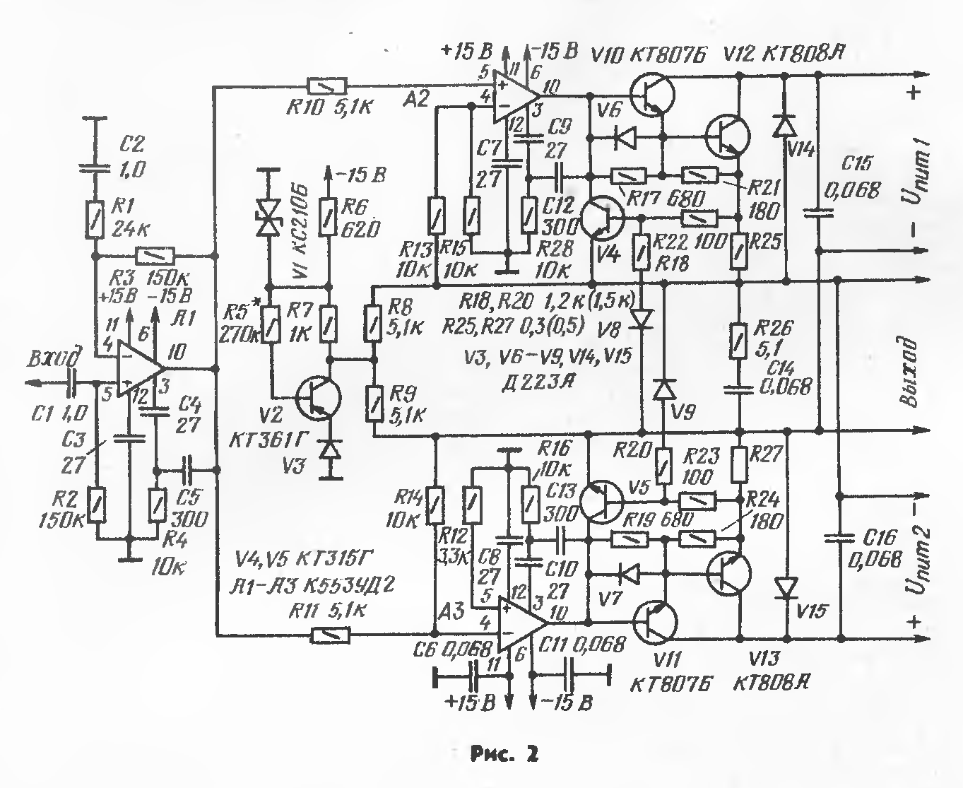

>author of the wiederhold prototype. Sukhov and Ageev developed the topic
Where?
GDR "Radio Fernsehen" published it in 1977.
USSR "Radio" in 1978.
Czechoslovakian "Ameterske Radio" few years later.
Haven't seen anything similar published in "Radio" before 1977.
Where?
To complicated for you?
I find it slim and elegant, but never mind...
By the way, the power transistors are "biased" in class C 😉
> Wiederhold.
> He's from East Germany. and he is the author of this amplifier from your post.
Yes. So Wiederhold "developed the topic", not "Sukhov and Ageev".
They just followed. 10 years later.

Hello, I'm looking for the best 2n3055 amplifier project. I have a lot of this transistors so i want to use them. The project should be modern and the amp should have good parameters. Thanks!

Surely not the best?
2N3055H's were good in their day, but barely managed the audio frequency range. Using 2N3055(H) as a driver is going to be quite slow, and 680pF Miller capacitors will be quite slew rate limiting.
If Bedini was concerned about second breakdown - a good reason to specify "H", BTW (especially in Class A) - then modern faster devices can match or outperform.
