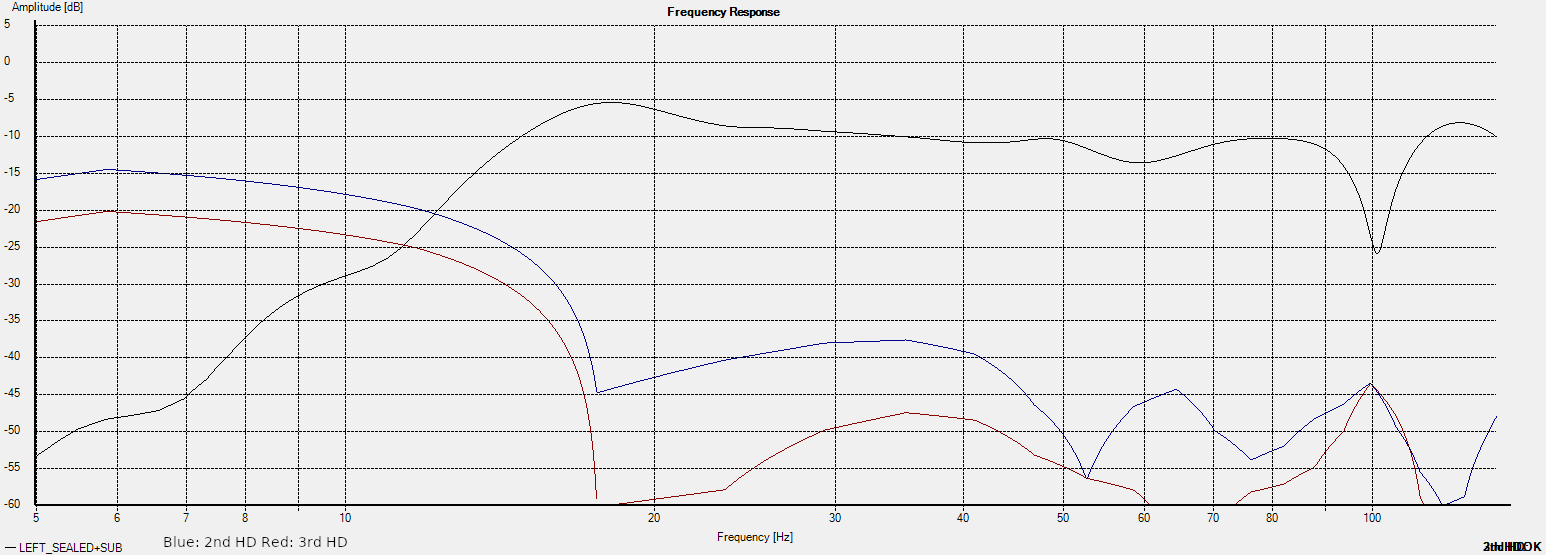

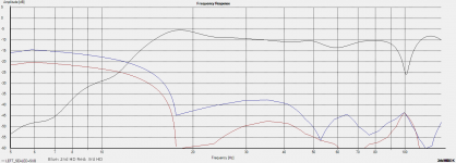

These days it's more about DSP and processing than the inherent Thiele-Small parameters. Harmonic distortion is not a problem, see attachment.

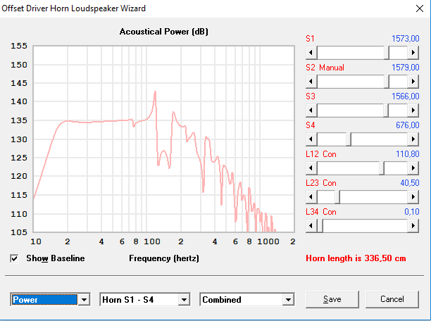

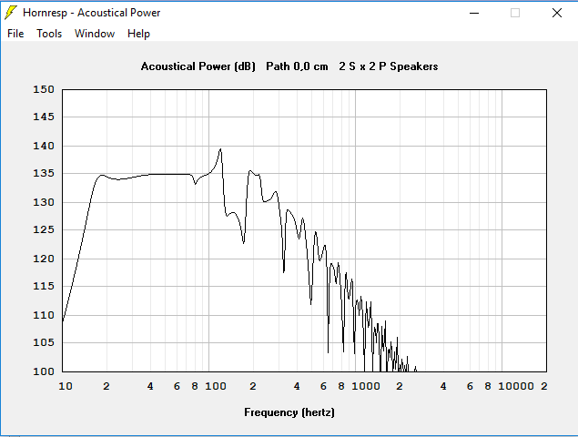

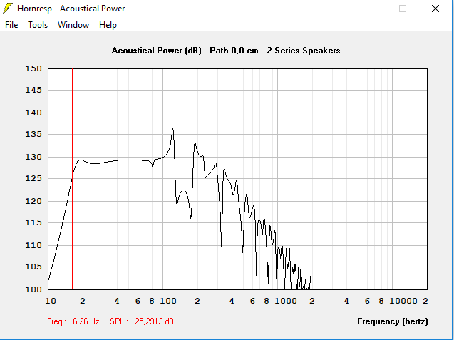

For a cheap solution I simulated a mass loaded off set driver QW sub, with JBL GT5-12 (around 100 $). Dayton Audio RSS315HFA-8 12" Reference HF Subwoofer will also work. The box is 150 liters, 2 of these in corners give a respectful output, ca. 125 dB at 16 hz. My friend has build one and confirm it's validity.
Cheers
1 driver pr box. JBL and Dayton are better than Peerless for this design. More x-max and stronger motor (BL). Can't really compare a 12" to a 18". Here is the same type of box just bigger (365 liter) with TC Sounds LMS 5400, which is a beast, with more than double the x-max over JBL / Dayton and of course a lot more expensive.
