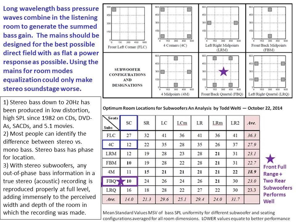

Can I ask about the issue of being able to locate a subwoofer or IB located away from the main stereo speakers? What crossover frequencies allow subs to disappear.
Have you researched maintaining stereo woofers in your room, like a front/back quartal configuration, versus summed mono woofers?
1) Stereo bass down to 20Hz has been produced in low distortion, high SPL since 1982 on CDs, DVD-As, SACDs, and 5.1 movies.
2) Most people with normal hearing can identify the difference between stereo vs. mono bass. Stereo bass has phase for location.
3) At frequencies below 80Hz most people with normal hearing cannot isolate the physical location of the woofer. (80Hz is THX standard)
----Expert listeners can isolate location of woofers down to 60Hz by focusing on impact harmonics, port noise, upper harmonic distortion.
4) Not being able to locate the subwoofer is a good cost simplification, but summing low bass into mono degrades true stereo recordings.
5) With stereo subwoofers, any out-of-phase bass information in a true stereo (acoustic) recording is reproduced properly at full level, adding immensely to the perceived width and depth of the room in which the recording was made.
6) Irregular room shapes can have an effect on even the subwoofer frequency stereo soundstage.
7) Geddes: "The mains should be designed for the best possible direct field with as flat a power response as possible." Using the mains for Room Equalization can only make the soundstage worse.

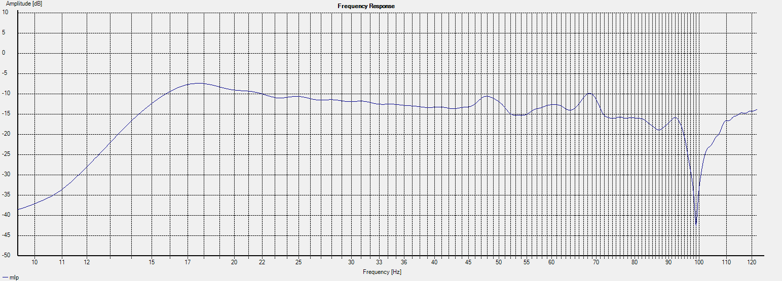

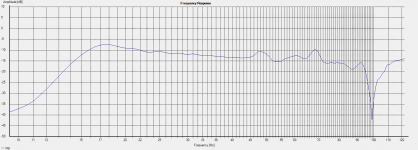

In my experience, Fs is quite an irrelevant parameter. For example, this driver has no problem playing down to 16 Hz at 110+ dB SPL levels in a domestic setting, yet has Fs of 40 Hz. That's more than a whole octave below Fs! For ULF, it pretty much comes down to volume displacement Vd.
If you simulate a "supersub" like Dayton Ultimax and a high Xmax PA sub, like a B&C, you'll find that their sensitivities around 20 Hz tend to be similar, around 86...88 dB/W, but the low Mms, low inductance, high BL PA driver has way more sensitivity in midbass. That gives the illusion of not being able to go low, but in fact exactly the opposite is true - the "supersub" is not able to go high. Many "supersubs" really struggle above 50 Hz, as seen on Databass website.
Attached is the FR of the cheap 18" driver linked above, in-room and properly EQ-d
