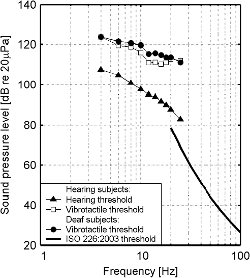

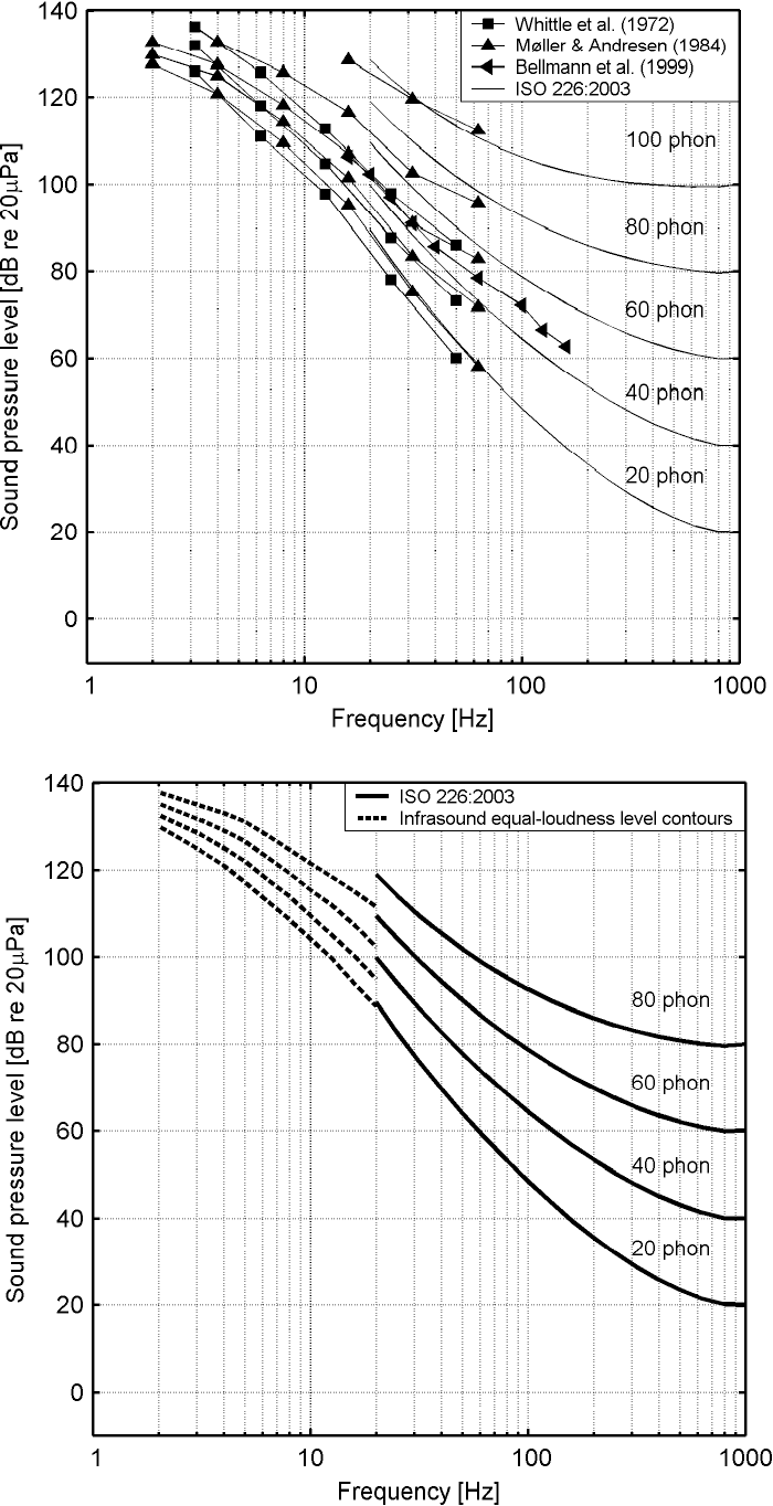

Ah, interesting. Actual research shows audibility at realistic levels for live music, that infrasound is heard far before it's felt and that as the sound level approaches that of music playback, the lowest frequencies draw closer to parity with midrange and, most interestingly, small increases (once above background body noise) sound significantly louder than the rest of the audio band. So, if you can reproduce the lowest frequencies at musically important levels as encountered in real life, they contribute to the listening experience.
This research, however, is SPL based. Other papers (that I can't find the article for at the moment, frustratingly, and that I had saved on my dead computer, not this one) indicates that the ear starting at 100Hz and significantly below 40Hz becomes dominated by particle velocity level over sound pressure in the sound intensity equation. That PVL sensitivity at low frequencies produces nerve impulses upwards of ten times the intensity such that, in one case, the in ear canal sound pressure sensor was registering negligible readings at the bottom of the transducer sweep while the probe on the nerve was showing some of the highest readings of the run. So, the contour curves may not be wholly representative given that they are only derived from sensors measuring only half of what's going on at the lower bass frequencies.
It's too bad the shills for speakers that can not reproduce low frequencies have had so much sway in what's taken as common wisdom in this hobby. Just earlier I was reading an article from '51 by Klipsch that touched on the 50Hz argument (and another of that vintage that put it up as high as 200Hz!) and the fallacy of it. All these decades later and people are still the same figuring if something's hard, it mustn't matter. It strikes me as intellectual laziness.

.......That PVL sensitivity at low frequencies produces nerve impulses upwards of ten times the intensity such that, in one case, the in ear canal sound pressure sensor was registering negligible readings at the bottom of the transducer sweep while the probe on the nerve was showing some of the highest readings of the run. So, the contour curves may not be wholly representative given that they are only derived from sensors measuring only half of what's going on at the lower bass frequencies.....

the vibration perceived from the body, everybody know this intuitively but the ear PVL, I never knew about that aspect. This is gold, will research more on this.
