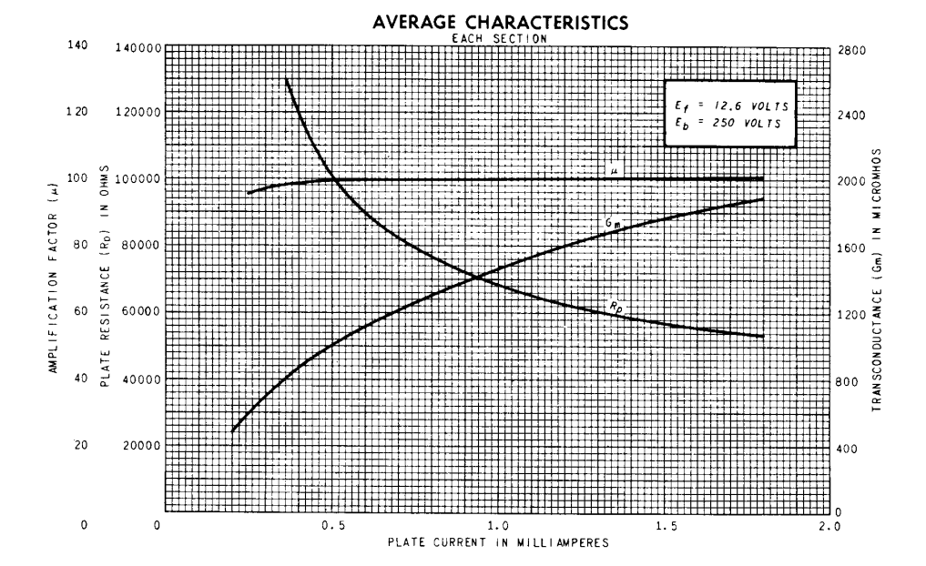

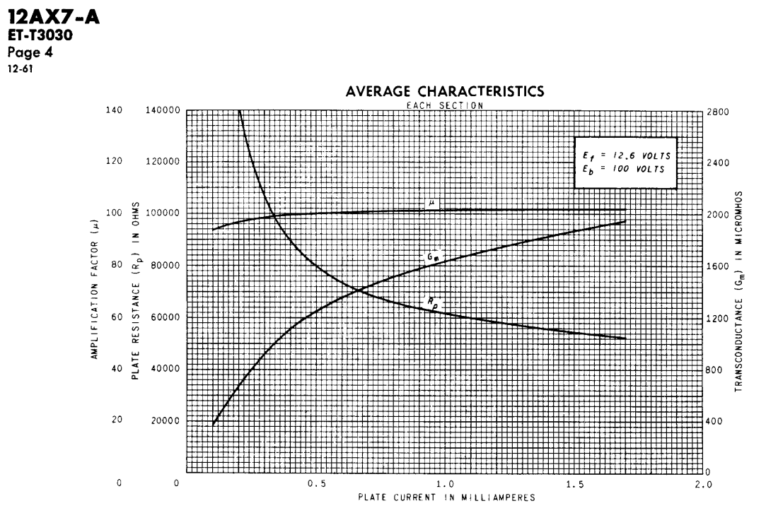

For 12AX7 and ECC83 types, linearity is generally better with higher plate voltages. Of course you will bias the tube to compensate for the different operating point(s). Usually you'll be using cathode bias, so at higher voltages you can increase the value of Rl (the plate load resistor) and the value of Rk (the cathode load resistor). The larger plate load resistor helps reduce harmonic distortion in the triode's output. (Rp is that much greater than rp, making for a flatter, more horizontal load line.)
The rp or Ri (internal plate resistance) will go higher with higher plate voltage and with lower plate current.
The tube constants (rp, gm and mu) are in a dance together, sort of like E, I and R in Ohm's Law.
12AX7A with Vp (Ea) at 100V:
12AX7A with Vp (Ea) at 250V:
See how the internal plate resistance is higher at 1mA Ip with 250V Vp, and lower with 1mA Ip and 100V Vp?
Conversely, gm is lower at 1mA Ip, 250V Vp, but higher with 1mA Ip, 100V Vp.
rp and gm go up and down, but mu stays pretty much the same, but varies less with 250V on the plate of the 12AX7A.
But it does change a little, depending on operating points chosen.
In the bottom graph in Post #90 (250V plate voltage), the mu trace is flatter than in the top graph (100V plate voltage).

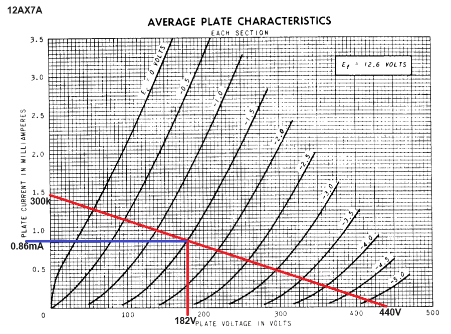

Yes, that's one of the "secret sauces" ARC used in the 70's to make their SP3 sound better than their competitors from the 60's, the like of Marantz or McIntosh. The topologies are generally similar, but ARC ran their B+ at 440V instead of the 250V or so of the other guys.For 12AX7 and ECC83 types, linearity is generally better with higher plate voltages...
Of course you'll need to replace your tubes often, but if you're an owner of ARC gears, you're familiar with this. 🙂
Why would you need to replace tubes more often if the operating points are well chosen?
12AX7/ECC83 is a high impedance device. It has very high internal resistance (rp or Ri). That means it wants to drop a lot of volts across itself.
Granted, the plate dissipation of 12AX7 is low at only about 1.2 watts, but that shouldn't be a big deal.
Let's say you have a B+ of 440V.
Choose a 300k ohm plate resistor.
Bias the 12AX7 to Ip of 0.86mA.
That means 258V will be dropped across the plate load resistor Rl. Make sure you choose a 2W rated resistor for that.
440V - 258V = 182V on the 12AX7 plate.
182V(0.00086A) = 0.1565W plate dissipation. Not anywhere near the maximum.
For the needed cathode bias of 1.5V, you'll choose a Rk of 1.744k ohms (standard value of 1.8k will be close enough).
Load line for that:
That should be a pretty linear spot, and as long as the power-on voltage spike isn't crazy, there should be no problem for the 12AX7 with its max plate voltage spec of 330V.
Right?
Load line for that:
Right?
