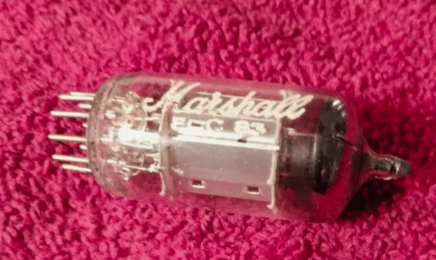

here are some examples:
notice that this tube says "marshall" on it. well, theres no such thing as marshall tubes, yet it says marshall.
it is, in fact, an EI yugoslavia ECC83 (aka 12AX7) nickel plate. marshall bought it and wrote their name on it. for those who are unable to indetify these tubes by sight, most european small signal tubes have the manufacture codes etched in the glass or stamped/painted on the bas between the pins, tho the stamping rubs off.

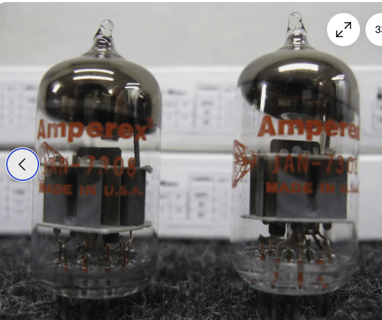

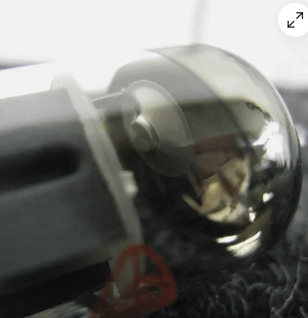

here we have 2 tubes braded "amperex 7308" with "made in usa." it is neither.
these are neither amperex, nor are they made in the USA. these are soviet 6n23p or 6n23p-EB, cousins of the 7308. see this getter construction? this is called "UFO getter" or "upsde-down UFO getter." exactly 0 usa or amperex tubes used this construction. moreso, it is exclusively soviet/russian.

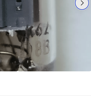

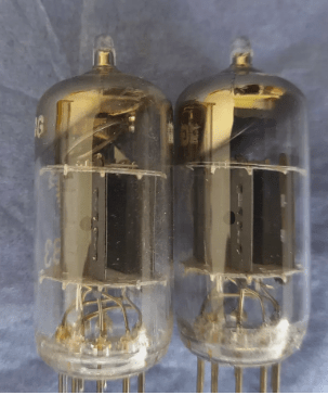

heres is valvo ecc83
notice the getter construction and manufacture D-codes in the second line
very early philips 12AX7 also had tilted getter, and so do some matsushitas, so manufacture codes can be very helpful.
