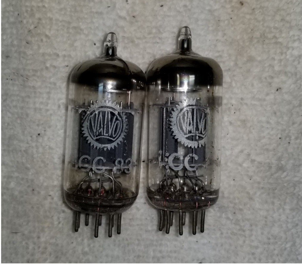

my friend, thats the whole point of the jj E83CC. you see, the jj E83CC frame grid is a direct copy of the tesla E83CC frame grid, which is a direct copy of the TF ECC803S frame grid.I did not know Tesla and Telefunken made frame grid 12AX7s.
to make it a little wackier, the jj ECC803S is a copy of the tesla ECC803S, which is a long plate 12AX7 and bears no resemblance to the above frame grid lineage.

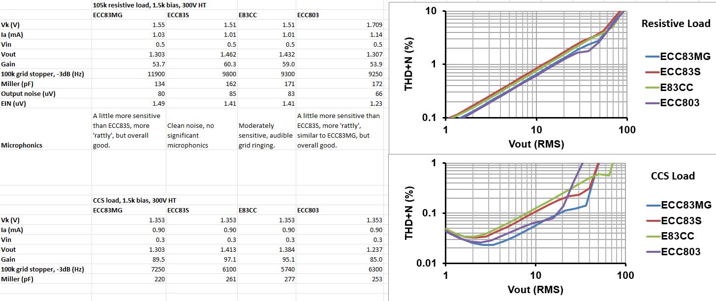

Has anyone submitted the JJ to a curve tracer. I don't have any of them to hand anymore, but did test the Tesla's and was surprised how much more linear they were compared the some USA long plates. There was a lack of matching in the Tesla's between the the two triodes / samples.
No, mine is real. Stepped from -4 to -0,5This was a Tesla E83CC. in 0.5v increments. Was your curve generated in the quick test function; I've never used that part of the software much. The curves in yours look similated.
In addition a quick test of the same tube.

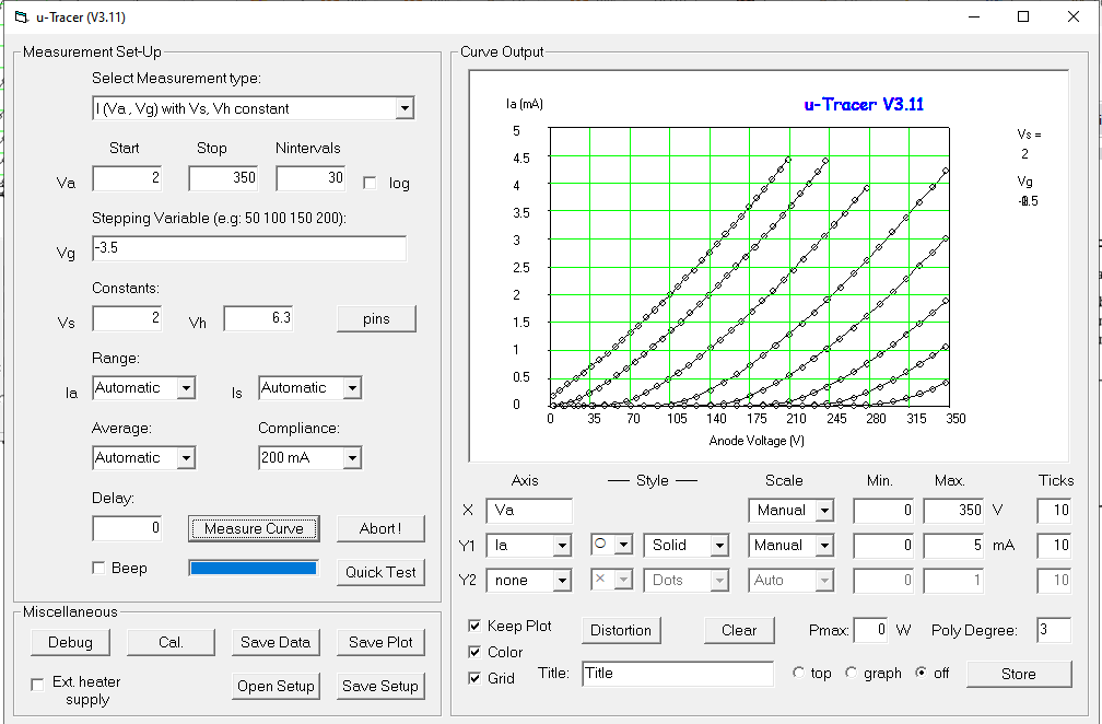

Guess I haven't figured out how to use all the features in the software. How did you get it to produce curves in different colours like that ?
I used default settings , I may come back with the setup file for this measurment ( it's on a seldom used winXP computer)

This is ( i think) a copy of the setup file used
This stupid webserver does object to the suffix .uts
I will instead open in a decent text editor and cut-and-paste the contents

I would absolutely love to see your measurements, the test setup configuration, and the equipment you used to arrive at this conclusion 🙂Both tubes have very low distortion unlike most other 12AX7s

Someone kindly sent me some JJs for distortion testing; here are the results. Distortion is consistent with other ECC83 brands I have tested, falling right in the middle of the range, e.g. these JJs are lower distortion than Mullard, higher than Sovtek.I would absolutely love to see your measurements, the test setup configuration, and the equipment you used to arrive at this conclusion 🙂
They are clearly labeled Valvo. May have started life in the Philips Heerlen factory but emerged as Valvo tubes.
they are clearly labeled/re-labeled and re-branded valvo, yet they are just as clearly not valvo.. LMK if youd like to know what they are.
