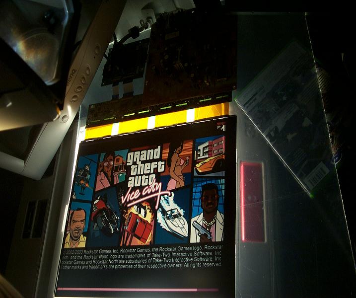

In Action
Here's a picture of it on the screen. As you can see there is only 1 long horizontal pcb on the bottom, and it is very easy to move around. This lcd is hard to screw up. I got a question about the filters tho. there were 3 on the screen 1 kidna clear, another looked like a mag lense, and the last one was very white. Which ones should i use? i know the white one is reflecting most of my light. Im not sure what each does.

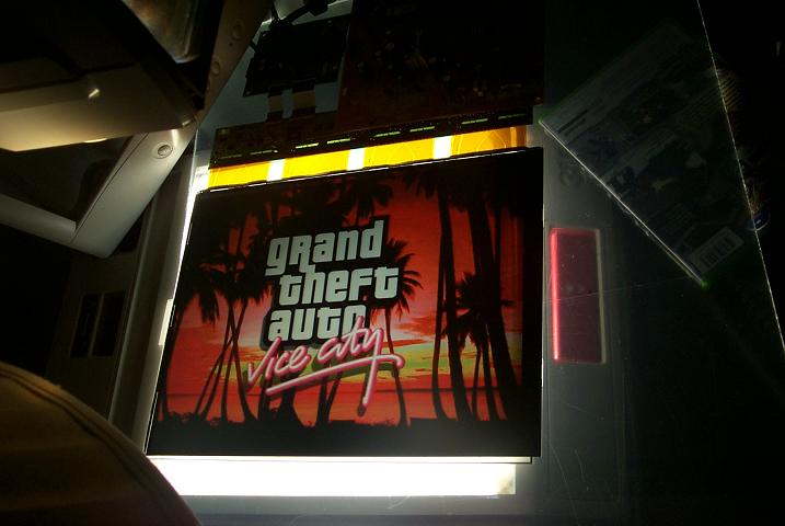

1 more

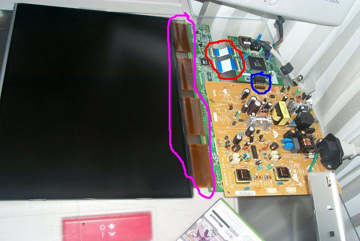

VF:
here's a picture of the circuit boards:
The board connected to the LCD is circled in purple,
then that is connect to the controller(?) where I circled in red (it took me 1/2 an hour to figured out how to disconnect those small ribbons....u just flip the tab up lol), then the controller is hooked up to the main power board where I circled in blue. It's pretty simple, so Im not gonna list all the steps to rip it open. Feel free to ask if u have questions tho.
Im still not sure about the filters...the one in the front is a polarizer, the whitish one in the back is a reflector, but I have no clue what the one in the middle does, and if any of them are needed for the LCD to operate correctly+ safey without damage.
