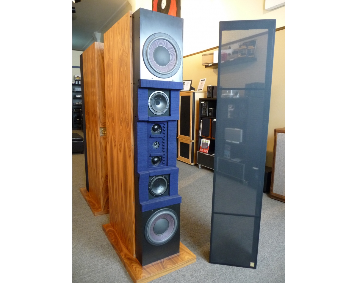

This is precisely what I was getting at when I said that most people hear an improvement when a baffle is covered in heavy felt or foam... Assuming the mid and HF balance is maintained, most people hear an improvement... But why? As Dr. Geddes points out, sound travelling along a baffle should be unaffected by whether the baffle is hard or soft, reflective or absorbtive.
remember these?
Yes, Dunlavy's speakers. I never had a chance to hear them. Today, we have both Wilson and Vandersteen using thick felt or foam on the baffles, although Vandersteen seems to be limiting it to just Tweeters in their latest designs.

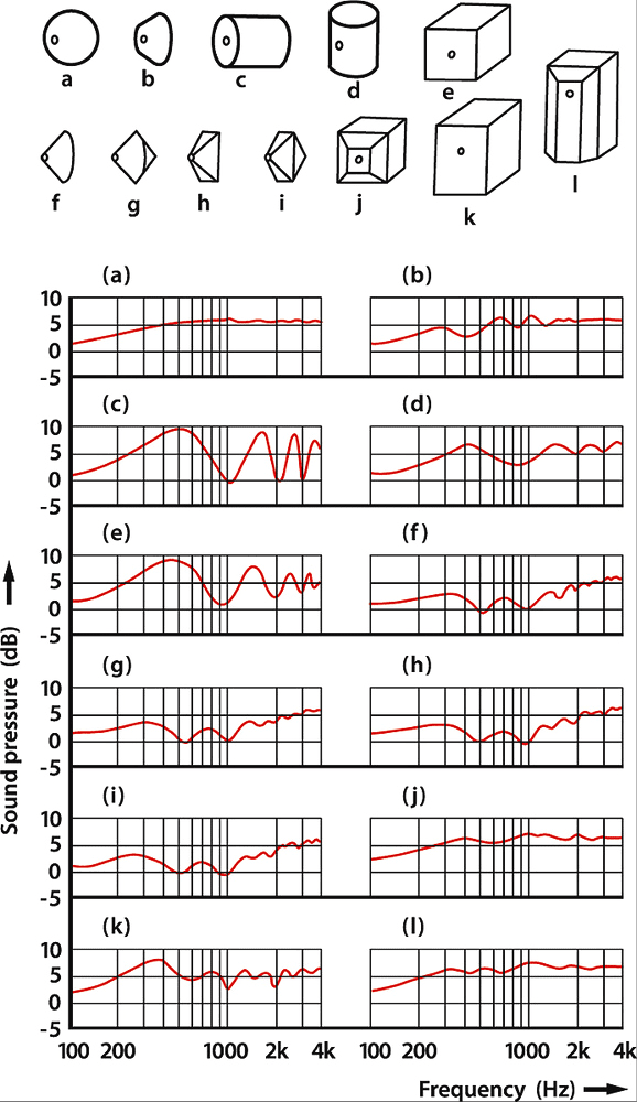

These graphs tell me:
The more baffle the more influence on the FR.
F G H I are not practically possible as a driver is bigger then a point. (a circle)
A is best, but the bigger the driver the wider the and more influential the baffle.
D is the best when more the 1 driver (or many small) is used and could be improved with rounded edges on top and bottom. Smaller drivers have less width and least baffle in this design and will have the best off axis response (less directional)
But what we hear is the combination of direct and indirect sound these measurements are on axis. A and D will be best by far in the horizontal off axis response as they are rounded baffles.
D with a line of small drivers will have the widest horizontal and most narrow vertical off axis response and is great to match to a line tweeter like a ribbon, AMT or planar.
A and D also hold pressure best. (most pipes and buckets are round/cilinders for that reason)
PVC pipe is great for a strong and light speakerbox.
A is best but only usable with a FR or coaxial driver, and otherwise D with rounded top and bottom. (vertically stretched A)
... and yet "K" (rectangle with the driver in a non-symmetric location) is very good, and it is also one of the easiest to build. "L" is even better than "K"... since we most always use a thick baffle anyway, the beveled edges of "L" are not too difficult with a decent table saw.
I believe that there is something going on with narrow baffles, something that is beyond the diffraction effects.
IMO asymetric placement is a bad practice as it fixes the on axis response but destroys off axis response. On and off axis response should be similar.
D and L (with a minimal flat baffle to mount the drivers) will be similar on axis, but D will have better horizontal off axis response.
