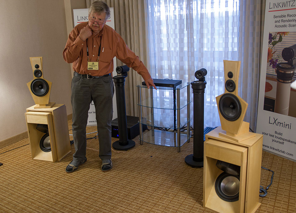

Anyway, I was thinking, we all know the picture, like the look from the top of the baffle, where tweeter is in the middle of the baffle, and waves are emanating from the center, and once waves reach the edge of the baffle, diffraction happens, especially if the edge is sharp, so the picture shows more new waves (not good) coming from the edge...everyone knows this. Everyone knows rounding of the edges is important.
But I have the gut feeling there is more to it. High frequencies bounce of the flat surfaces. While in above mentioned pictures, there is nothing showing in between the tweeter and the edge happening, what if there is some bounce going on. I have no data on this, just a gut feeling. Hence if the baffle is minimal, less bounce, off course, even minimal baffle is rounded. Both SL LX521 and Nao Note II have minimal baffles, yet rounded, and both measure impeccably well, both on axis and off axis. Its a pity Nao Note pages are down, I remember there were some nice polars presented.
Both speakers image well.

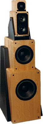

true, all true, but somehow people still make slim boxes around mids and tweets for reason

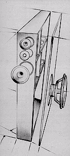

this is from web...
Many people who do their own speaker projects separate the woofer from the rest of the system, putting it in its own box. Often, people also bi-amp the system, using a separate amplifier for the woofers. This greatly simplifies crossover construction and gives you more control over bass. The mid and tweeter should be at roughly the ear level of the listener (when sitting) so that the sound doesn't seem to come from above or below. You could build a box that was 4 feet tall. This just means more work and wood, but build the speaker you want. It is cheaper and simpler to build a large sub box with a separate much smaller bookshelf sized speaker. Another option which is very popular with manufacturers is to make a single, thin, deep box with a side firing woofer, as in the NHT 3.3 above. The front of the box is just wide enough to fit the mid and tweeter, and the box is just deep enough to fit the woofer on the side. The necessary volume for the woofer comes from the box's height, which is tall enough to allow the mid and tweeter to be at ear level. Since the box is thin, there is no wasted area (or wood) in the box. NHT, Klipsch, and Definitive Technologies are a few of the companies that design speakers like this.
