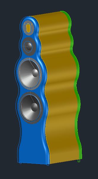

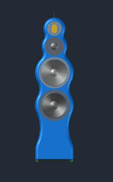

What are the benefits of minimising the baffle size (and rounding the edges) compared to a traditional flat, rectangular baffle? The assumption is that I would be using an active crossover/DSP so have free range (almost) on crossover order and frequency.
Context -
With the availability of CNC cutting and flexible wood products (Flexiply) it is possibly for DIYers to make fairly complex baffles and cabinets for sealed/BR traditional (no open baffle) speakers.
So, as an example I have attached a picture of a potential 3 way design with passive radiator (or double woofer) that could be made using CNC and flexiply. What would be the differences, compared to a traditional rectangular baffle, in terms of dispersion (i.e. off axis sound), soundstage and or instrument spacing (if any) or any other attribute (subjective or objective) of sound (understanding that driver chioice has a lot to do with it).

When the baffle is minimal, the reflections will be strong (in this style). Maybe some will be close enough to the driver to benefit from precedence effect. The rounding you show is not much.
This has nothing to do with it.
Generally just does bad things. Smaller baffle pushes up the baffle step frequency so the on axis sensitivity is lower over a larger range of frequencies. The drivers have to work harder to produce the same SPL -> more non-linear distortion.
Also for drivers like that dome midrange, because of the size of the faceplate, when you make a minimum size baffle it is going to approximate a circular baffle that is perhaps 3 times the diameter of the dome. This is very bad as it achieves near worse case baffle diffraction effects.

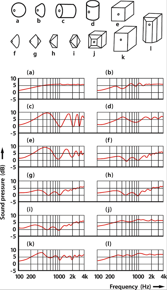

With baffles there are some considerations to make:
1) chamfering the edges spreads out (in time) the soundreflection from the edges (as shown in the earlier graph),
2) unequal distance to edges (from the driver) spreads out the soundreflection and will affext the frequency curve less (if done right),
3) Baffle diffraction, The size of the baffle will determine what baffle support the bass will get from the baffle, the smaller baffle - the less support.
To test the planned baffles effect on the frequency curve there is a nice peice of software:
Home of the Edge
