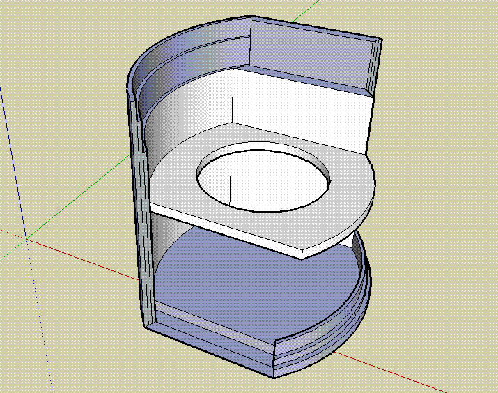

The material is pretty thin and very flexible so I think it's a good idea to either strengthen it as much as possible using multiple layers and bracing. I used quite a few layers of fibreglass, sand and fibreglass resin and fillite powder with fibreglass resin before applying a 10mm layer of felt to the inside. Effectively, I built up lots of sealed layers inside the cabinets.
I can actually stand on the sides and bounce up and down without any movement (that took some courage to try though 😉 )
I think applying some kind of resin or water proofer is a good plan because I guess bendy MDF is pretty good at absorbing moisture because of its large surface area plus the MDF isn’t that hard (compact?) compared to other MDF I’ve used.
One thing I'd like to try is applying resin to the outer layer and then a layer of soft silicone or similar followed by other internal layers to give structural rigidity which should isolate the outer skin nicely.
From what I can tell there isn't any appreciable resonance and I don't get any type of MDF signature colouration, certainly not compared to other speakers I built. I think the project was successful, well, within realms of any goals I’m likely to be able to achieve anyway.
All I need to do now is stop listening to them so I can finish painting them 😀

I used bendy MDF for my main speakers, (pics in the UK diyfest thread somewhere). Firstly I tried using two layers separated by about 2cm, then filling the void with expanding foam. Unsuccessful as the foam failed to fill the gaps properly. Then I rebuilt them and filled the void with dry sand, but that didn't seem to reduce the resonance that much. For the third, and final attempt, I used one layer, smooth side in, then rendered the outside with 3/4" sand and cement render, with added PVA for grip and crack resistance. That was finished with faux aluminum chequerplate flooring vinyl, resulting in a completely dead box.

Here's what I know about high end car audio installers: If they are willing to used kerfed plywood to create a curved panel to use for an enclosure, they are either lazy or prefer to do things the wrong way.
I have used kerfed panels many times in the past in my line of work, but I've never used one for a speaker. Curved panels are best made with thin solid layers, glued and built up to the desired thickness.
Layers have bettr damping properties than either voids (kerfs unfilled) or inconsistant material (kerfs filled with gunk)
How's that? 🙂
But John, where did I state that the tape I watched showed the installer using plywood? Go back and reassess the post. I never stated such.
In fact, the tape clearly shows the installer using MDF, making individual crosscuts with the table saw, making a loose fit, then mixing and applying Bondo before using a brad gun to attach the kerfed piece to the frame. Then he neatly scraped off the excess Bondo that has bled out from the squeezed cuts.
If you did not see the tape you could not begin to understand just how solid, and neat, the kerfed wall would become. The job was Very Professional and looked a million dollars. Plus it was rock solid.
I'm a firm believer in using bondo filler for kerfed cuttings. I can't think of a better means of engineering a solid rounded wall, and I stand by my assessment. clearly the fellow making the tape was a genuine expert.

I think I can begin to understand. This subject isn't over my head, friend. Without bragging, I think it's fair to say that my knowledge on box construction methods is extensive.
I meant kerfed material, be it plywood, MDF, whatever.
A better means to "engineer" a solid rounded wall would be the method I described above.

Regardless of the car audio. John, are you talking about laminating either wiggle board or 1/8 layers of plywood?

Thin plywood or thin hardboard. Depends on the radius of the bend how thin it needs to be. I bent 5/8" MDF for a baffle but that was a pretty large radius (maybe 6').
1/8" hardboard can do a very tight curve and it's ~$7 per sheet.

Hardboard is Masonite - High density fiberboard (HDF).
I'm not crazy about the density of wiggle board or the typical luan plywood. 1/8" door skin (luan) is not bad but expensive.
Best results from hardboard IMO. First building the "frame" of the box (front sub baffle, back, top, bottom and the intermediate braces) provides the form to bend the material around. Taking the time to build a reverse frame, to clamp each layer on, makes tight glue joints if you don't have vacuum bag (I don't).

I almost always build a frame for a vacuum lamination, because I end up veneering it in a 100% of the cases.
