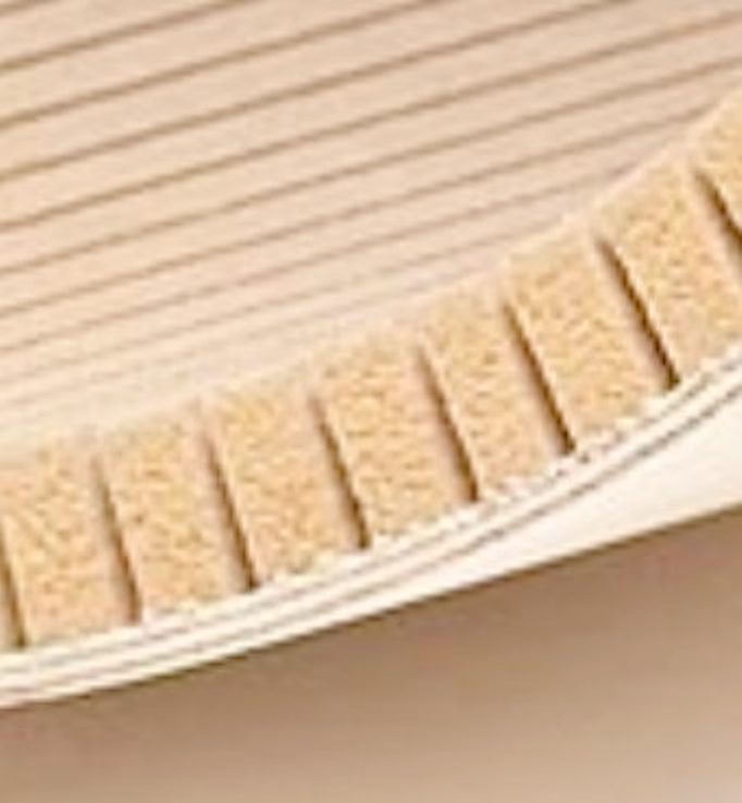

What it is is "kerf" cut lumber. I do it whenever I need to go around corners with my clients jobs when they come up. But I do it on my table saw. Fortunately, my vacuum system picks up almost all the dawdust.

In US it cost about $120 for a 19mm 4x8. It’s a good deal for me because I am not looking to do 1000000 kerf cuts on the table saw. Uniformity of the bend is very good and as you noticed the outside is birch ply, which makes veneering a bliss.

The outside plywood layer is 5 really thin laminations, making the bend much smoother on the ouside. Avoids that "segmented" look you'll get with kerf cut regular plywood.

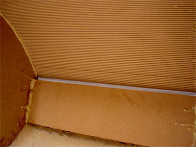

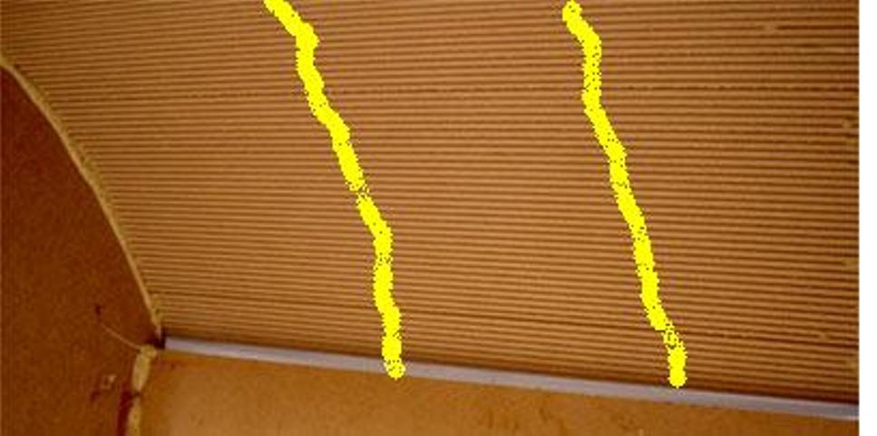

When I've used kerf cuts before (not for speakers), I ran beads of construction adhesive across and into the cuts to create points where it's solidly glued.
No need to completely fill IMO.
Like this:

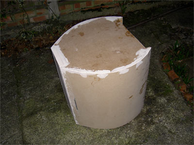

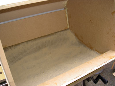

I used a mixture of sand and fibreglass resin to fill in the cuts but there are various other layers of materials inside that layer too. The outside of the cabinets is pretty dead but the outer layer of bendy MDF was really only designed to be something to attach the veneer to and to build up the other layers on the inside. the fibreglass resin also soaked into the MDF layer which I guess adds strength.
The pic shows the first layer of sand and resin.

That's one good way to do it. Never thought of that. The way professional auto sound installers do it is to use Bondo type filler to fill in the kerf cuts. You mix up the compound and apply it inside the cracks while it is flat and then apply the curve. Once the curved side is attached, you can either scrape off the excess, or smooth it out, like with the sand and fiverglass above.
