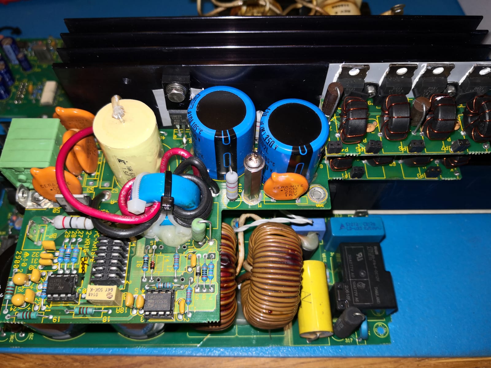

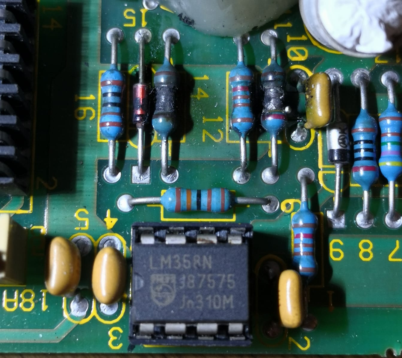

Hi I have a Sorensen / Xantrex 600V power supply which had a short across STP4NB100 and it took shunt resistor (17) and 2 other resistors(11, 14). Photos attached.
The problem as always the schematics are unobtainium.
I would really appreciate if you could help me to identify the resistors
Regards Jack
