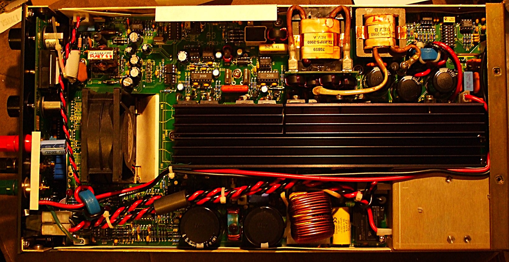

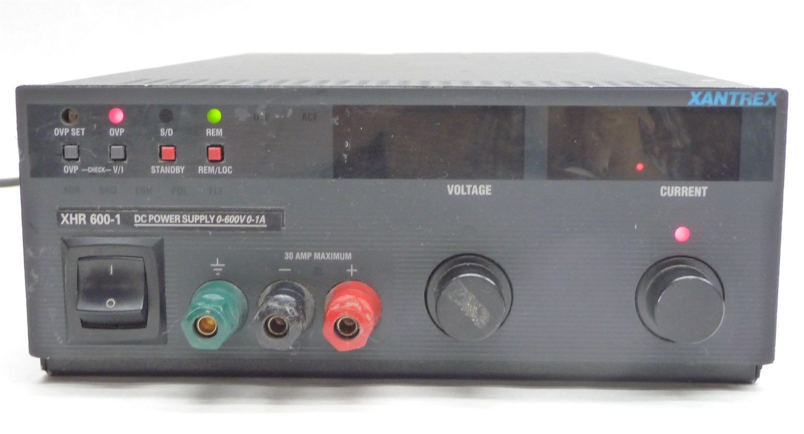

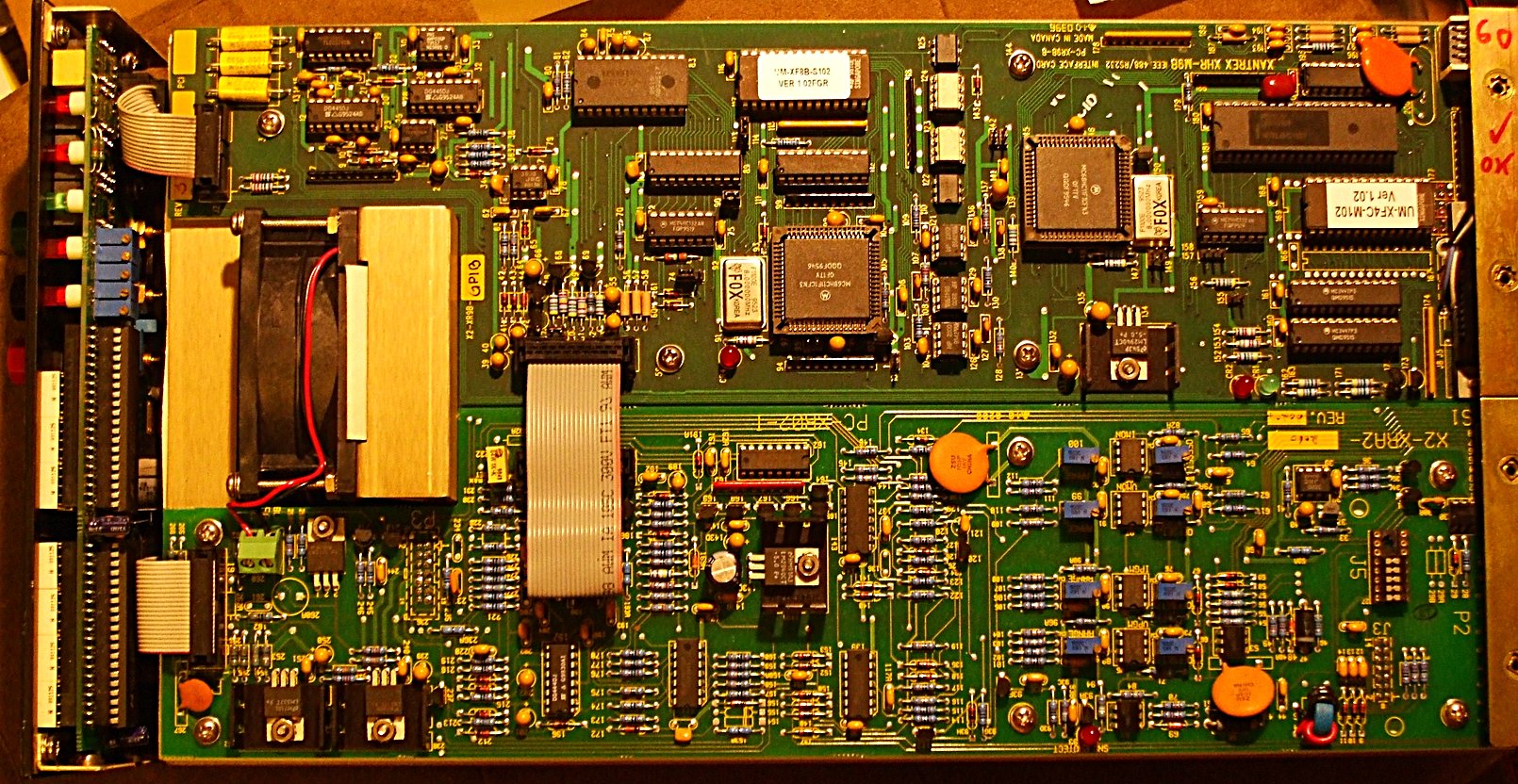

I'm trying to fix a Xantrex XHR600-1.7 that just blinks (dimply) the displays on power up. I've checked the current sense wires and the dip switches (set to factory default) to no avail. Any hints?

If it has the RS-232 or GPIB option board (M9B marked on back), un-plug the two ribbon cables inside going to that board.
Make sure it has the outside sense lines connected from the bigger J2 SNS- and SNS+ terminals to the smaller output connector SNS- and SNS+ (on back) respectively. No other jumpers should be connected on J2. (if so, record positions, then remove)
Switch SW1 on the back should have just positions 5 and 6 ON. Sometimes an inverted DIP switch may have been used that has ON and OFF flipped, so try the mirror image also. (can also check the DIP switch to see if its markings agree with the back panel markings)
On the PCR02-I control board inside, socket position J5 should have jumpers from 1 to 16, 2 to 15, 3 to 14, 4 to 13 and 5 to 12.
Bottom side, Main board: check the AUX power supply fuse in front corner near the two wire (red and blk wire) connector, 0.5 A 250V Fuse.
Make sure there is NO small plug in relay board (remote turn-on option) behind the front panel ON/OFF switch. IF so, remove, and re-attach Red and Black wires to power switch directly. Reds on one side of DPDT switch, and blacks on the other side.
When powered up initially, does the internal fan come up to speed?
Do any Red LEDs stay on, on any board or the front panel? Like OVP. Sense protect... Press the Standby button, then press to release. May free up a Standby condition. Make sure the Current Knob is set upward some, above 0, so that current limiting does not prevent output V from coming up.
J3 connector on main board (bottom side, just the solder pattern is visible near the small electrolytics. This is the AUX power supply connector to the control board back side. J3-pin 10 is AUX Gnd. J3-8 is +18V (unreg.) and J3-12 is -18V (unreg.) J3-6 is +5V. J3-1 and J3-2 are an isolated 9V (un-reg.) supply, J3-1 is the positive, J3-2 is the neg.
Be careful not to short any of these AUX power terminals while testing!!
In the PFC section between the two BIG 400V caps, there is a 6.3 Amp Fuse, F300, check this (while powered down!!)
There is a connector cable (Red/Blk wires) from near this fuse over to the earlier AUX power fuse: P301 to P2 This has about 312VDC on it when operating. This is the output of the PFC section. DO NOT SHORT while testing!! Can access back of Nylon connectors for pins. Red is +, BLK is -. Use EXTREME CAUTION!!!! while probing anything in this supply while powered up. HV 312V from PFC all around, and eventually 600+V near the output capacitors and xfmr section.
Any sign of work having been done on the supply? Any burned looking components? All ICs are in sockets typically, so one can re-seat these carefully (powered down, disconnected).
What controller IC is used in your model? Will either be a UC3524 chip on main board near the Mosfet row, or a small plug-in daughter board on the chassis edge with UC3875 chip. Make sure daughter board is plugged in fully and bolted with an insulator sheet between it and chassis.
Additional J3 terminals on main board, bottom connector solder pattern (signals from control board) (same conn. as AUX power):
J3-11 is Cntrl Gnd (0V reference), J3-13 is Cntl (-11.9V on working unit), J3-9 is S/D shutdown (-15V on working unit), J3-7 is OPTO RTN (-15V on working unit), J3-5 is AC FAIL (-9.1V on working unit)
Hopefully all this will help localize where the problem is.
One strange problem I saw once was the T2-AUXX-FMR xfmr in the AUX power section was not inserted fully into the main PC board. A corner pin had just a solder bridge connecting it to the main board, which had cracked. Re-soldering the pin from top xfmr side fixed it.
Make sure the current sensing resistor near the output connector is OK. (these blow out easily if the supply is shorted)
There is a small Mosfet on the heatsink near the output capacitors. This turns on whenever output voltage is above the V set point. Make sure it is not shorted from S to D.
Make sure the output capacitors are not shorted. Similarly any other big capacitors like PFC. (after allowing for the Powered-Down!! unit to fully discharge capacitors. Could use a shunting discharge resistor for safety.)
Could also check the various power Mosfets on the heatsink to make sure they are not shorted. (while Powered Down!!)

I just bought a rather dirty and crusty looking Sorensen DCS 600-1.7 power supply in "not working" condition on Ebay. We will see what turns up in a week or two when it gets here.

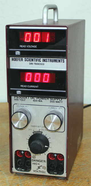

A little more complexity than the Hoefer!

Supplies like these are a dime a dozen in my industry. Seriously, we throw a ridiculous number in the "trash" (you don't want them, at my current work they are in BSL-2/3 labs). If you do purchase one of these supplies, there is a chance that they are contaminated (both with biologics and/or with salt). The buffers used in these reactions are usually moderate to high conc salt solutions. These get splashed everywhere and are a disaster waiting to happen. So when you receive one, open them up and thoroughly clean the insides. First with deionized water and then with 70% alcohol (the % is important here, no more-no less). These things are treated like rubbish and abused heavily, I don't want someone getting sick because some stupid lab didn't follow proper decon protocol.
Very interesting!!

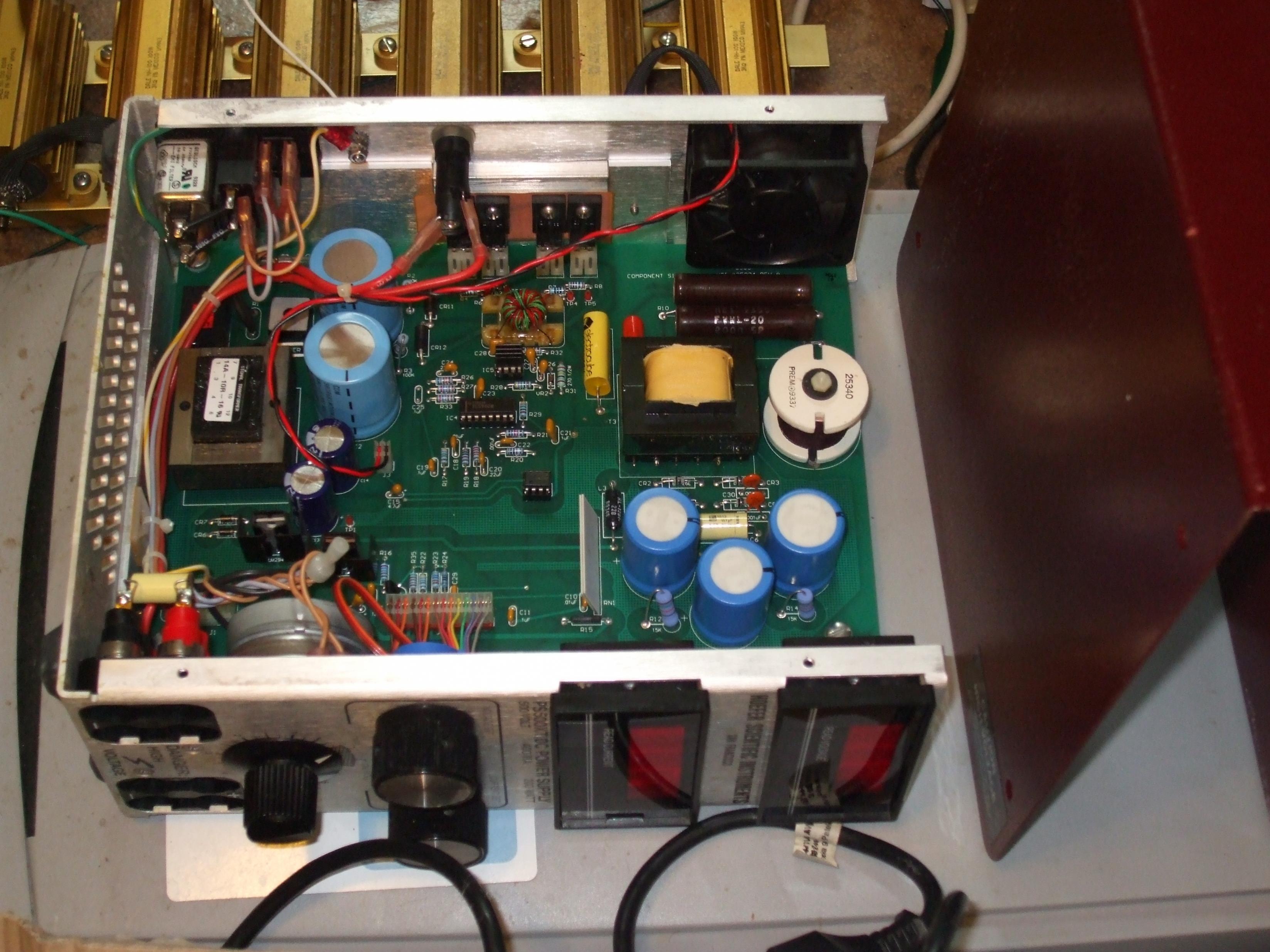

In another thread on power supplies, I had mentioned the Biotech type Electrophoresis power supplies, such as the Hoefer unit above, with a question mark as to any hazards. One responder said these had to be thoroughly "cleaned" by any lab before they could be sold on Ebay. But while that may be proper procedure at many places, there are always going to be dumpster divers who pick them out of the trash and list them on Ebay.
I have alcohol washed any obvious splash or streaking from the units I purchased off Ebay. But looks like this should be more EMPHASIZED for these electrophoresis type supplies. Fortunately, the Hoefer unit does not have any vents on the sides or front, just bottom and back, where air exits through a fan. If the bench somehow got flooded with liquid I suppose the inlets on the bottom could suck in the mess. Front knobs would be an obvious site of contamination, and older units often have grimy knobs. Certainly clean those. Could replace knobs if too far gone.

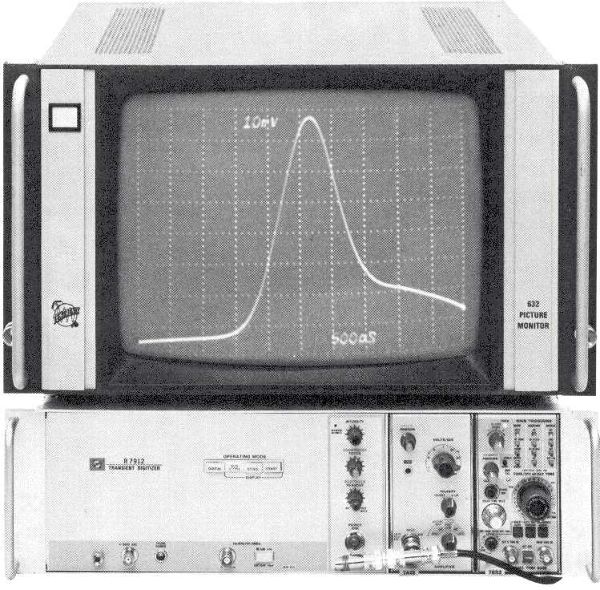

This brings back some memory of a Tektronix R7902 high speed storage scope I bought used (cheap) a long while back. The sellers said it had been used for recording single shot "nuclear events"!! Racks and racks of them for sale. I hadn't noticed any glow in the dark issues, but it is in storage now a long time. Still works good. Uses popular 7 series plug-ins, but came with a direct deflection plate access Vert. plug-in for BIG signals up to 1 GHz. They were like $20,000 new at the time, but I paid around $50 each for two of them. To think that they only got used for a single trace once! "Like new"
Correction: that was a Tek R7912 mentioned above, not R7902
Some info on the unusual Silicon Storage Target CRT "tube" it used:
154-0698-00, Tube 154-0698-00; Rohre 154-0698-00 ID42420
and the full transient digitizer:
Transient Digitizer R7912 Equipment Tektronix; Portland,
This thing put out a raster scan signal image of the storage target, and a GPIB digitized version to a minicomputer or PC. It didn't look too inviting to hobbiests without an obvious "CRT" so was a hard sell on the surplus market, but actually it was real easy to use with a monitor. Storage mode: 500 Mhz BW with a 7A19 Vertical plug-in, 750 Mhz with a 7A29 V plug-in, and 1 GHz with a direct access plug-in.
"In this Digital mode, the R7912 operates as an analog-to- digital converter with an effective clock rate of about 100 GHz." (this was back in 1973 !!)

Still looking:
Sense lines are good.
Nope
Nope. The display LEDs blink dimly @ ~1Hz with numbers on them.
No change. No LEDs on.
All of these are toggling from zero to ~4vdc. Again, it looks like the LV supply is trying to come up and shutting back down. supply
Fuse good.
U3524.
Short movie of the front panel blinking: http://www.fastbobs.com/movies/ps.mov
