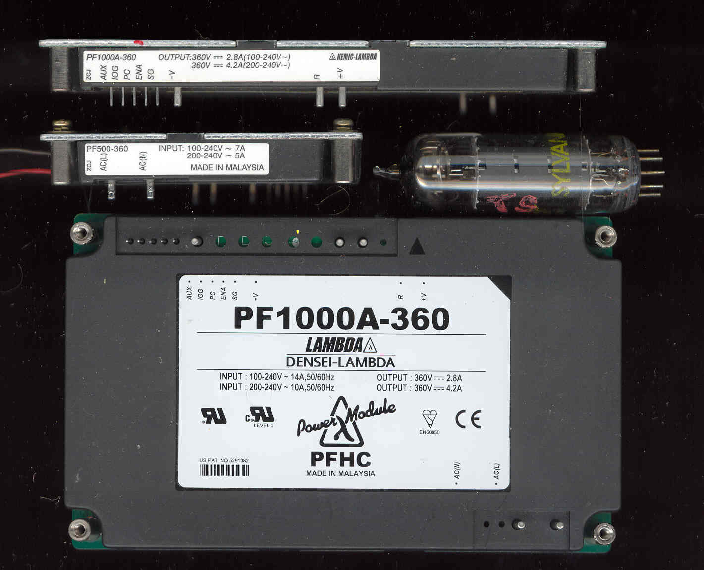

Just a couple of these $40 Lambda PF1000 units off Ebay, and you can run 2000 Watts 720V (360V+360V) on an extension cord from the laundry room.
(low EMI, sinusoidal current draw using PF, power factor, correction) But I think any HOA would allow a welding/dryer outlet in the garage/lab anyway.
Would need a big 240V : 240V-240V industrial xfmr to provide V isolation for the PF units still.

Or use two Xantrex XHR-600-1.7, those are PF corrected, and isolated.

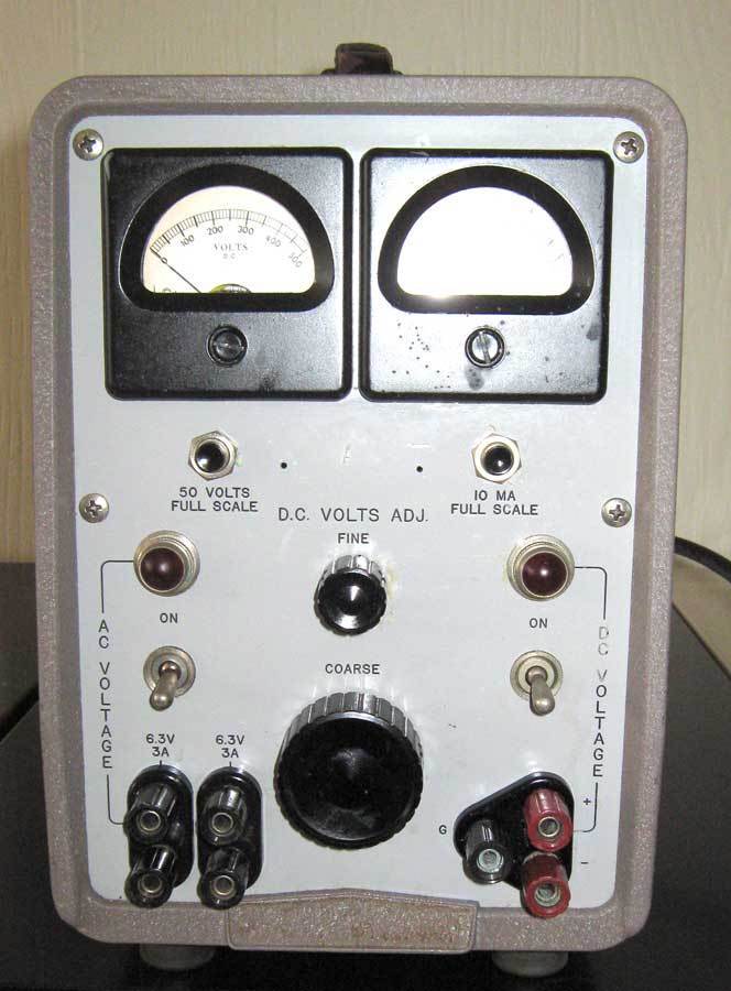

I agree with everyone else - older, regulated, HV supplies are a staple of hamfests - hard to justify scratch building one, unless funds are really, really, tight.
I got one of the heathkit lunch pail types for about $75 or so - looked new, provides 0-400 HV, - bias, and 6.3 volts, and had a pair of like new RCA blackplate 6L6GC as the pass tubes. Reselling the pass tubes might well cover the cost of a hamfest acquisition. One of the years at Dayton, I went up to Fair and grabbed a NOS Kepco supply for about $50.00 that goes 0 - 200 volts, has current limiting, some more 6.3 volts, and had a new GE 7581A in the pass tube spot.
