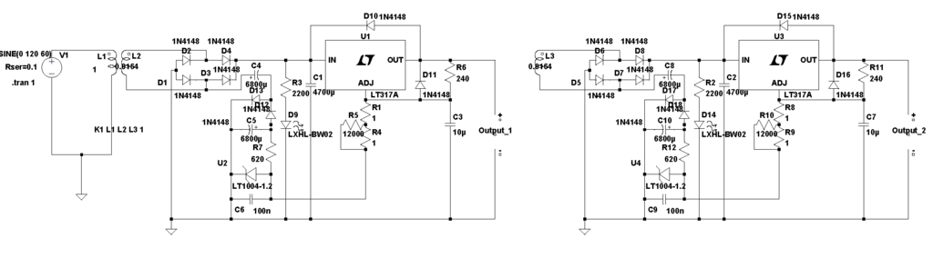

So after some input from others, I have decided to stick with LM317 despite its limitations for the main outputs of the psu. I am using a voltage reference to drag the adjust pin down -1.225 instead of a zener for more stability. In spice it seems to work ok. Here is the schematic.
As you can see, the circuit is duplicated twice off of the same transformer, giving me a little less range per output than I originally wanted, but that is the transformer I have to work with (20vct or ~13.2v per output after rectification). The only thing not shown in the model is the output switch. Its a basic psu. Still need to calculate worst case scenario for heat.
All comments and suggestions welcomed! I will now start to work on schematics for the other sections of the bench psu - panel meter supplies and digital output supplies.

You have made the simple 317 look so complicated you have forgotten smoothing capacitance.
Look at the 317 datasheet. Simple circuits !

Indeed!! My specialty is obfuscation 😛😉
Thank you for the catch. I will revisit the datasheet and see if there is anything else I have forgotten. Sadly, it reminds me that modeling in spice is no substitute for experience - the v. out was smooth as a baby's bottom, in real life the ripple with any appreciable load would have been unusable 😱

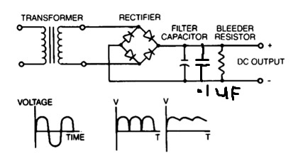

You have two 20vac 2.8A transformers 56va. I would use them to there full potential. Make two separate power supply's, simple unregulated. Bridge, bulk capacitor 10,000 to 12,000uF and a .1uF across that. You now have roughly a 24vdc power supply of decent power for experimenting with audio amps. Some audio power stuff can be powered with a single supply and some needs two supply's for +-. Now you can do both.

Make two identical power supply's using your 187E20 20vct 56va transformers.
transformer>bridge rectifier>capacitor> bleeder resistor.
capacitor 10,000uF minimum and a .1uf for noise. 10K uF is plenty for most things. But if you use this for an audio amplifier remember that bass notes as in sub-woofer will suck the power out of a power supply. My current audio amp 6 channel class D is powered by an unregulated 24vdc power supply with 100,000 uF. I did not build this supply it came this way.
Bleeder resistor. 20vac x 1.414 = 28.28vdc
28vdc x 10% unloaded = 31vdc
add a little for high line 33vdc.
We want around 1/4 W dissipation.
I = P/E .25w/33vdc = 7.5mA
R=E/I 33vdc/7.5mA = 4.36K
4.7K is very popular size
You might get buy with a 1/2 watt, but get a 1W.

Awesome, thanks bob. I will draw up something today and post it. The bleeder resistor is just there to drain off the caps, rendering the system safe after a period of time. Got it! Thanks again for clearing that up for me 🙂
