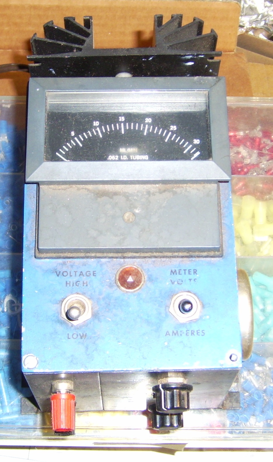

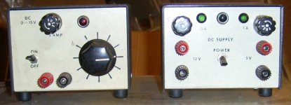

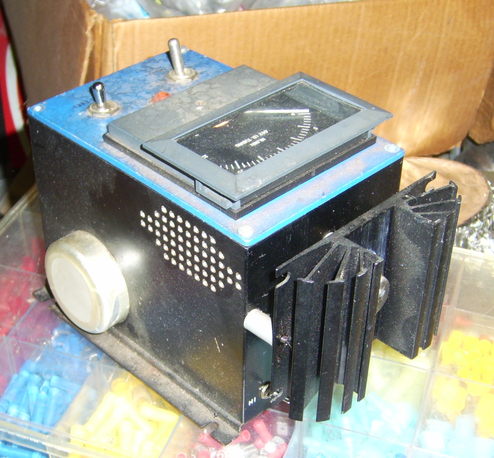

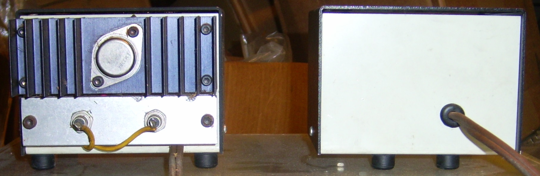

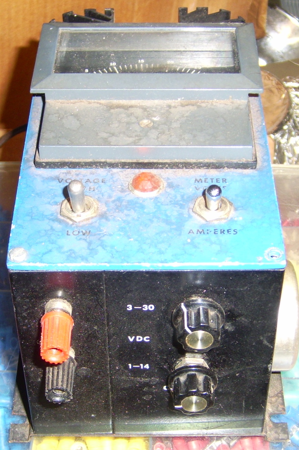

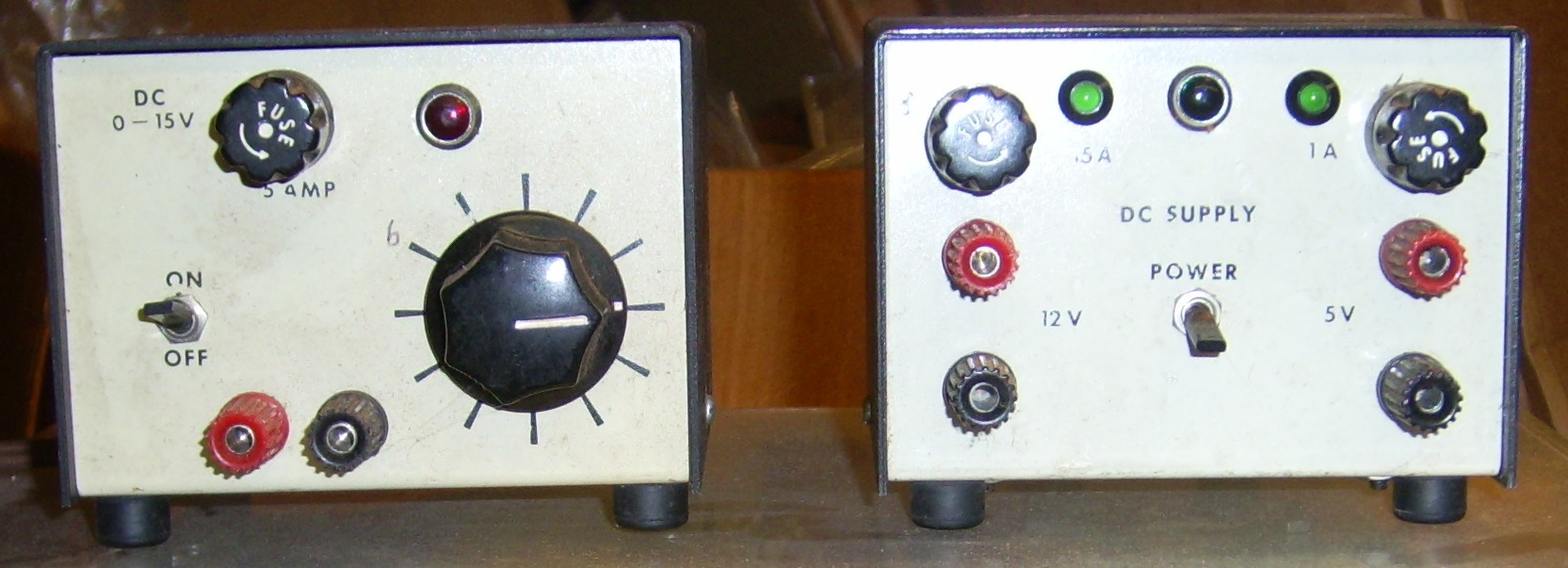

Here are some pics of power supply's i have made. Mostly with surplus components when transformers were plentiful and cheap.

Those are pretty nice units from salvage parts, Bob!!
