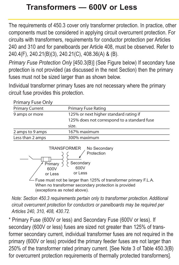

See pdf, the first paragraph on the first page shows transformer fusing codes. ($%^& file to large, i sent jpg instead).
You have a 56va transformer with a 2.8A secondary so code says fuse for primary must be 167% maximum. 56va / 120vac = .467A, or look up mfg spec for pri current.
.467A x 1.67 = .779A
Closest digikey fuse without exceeding .779A is .750A
My selections.
voltage rating AC 120/250.
.750A
Mounting type holder.
I do not see any mention of time delay fuses being a problem in the pdf so select slow blow. This leaves only 13 choices, match a fuse with a fuse holder you want to use.
Each transformer should have it's own fuse. Notice in the fuse code chart that small transformers can have up to 300% maximum current. This is for inrush to prevent nuisance tripping. Your small transformers will use this spec.
These are the maximum fuses you are supposed to use by code. If you have nuisance tripping from say a huge capacitor on the secondary and lots of inrush, code says that is your problem! You may not increase the fuse size. You would have to limit inrush by adding resistance on the secondary. So do not go hog wild with lots of capacitance. I think the author did a good job with using 4700uF caps for 1A out, only slightly overkill. For 1.5A 4700 to 6800uF will be enough.

I was going to do a primary current check but i can not. If you go with LM317-N max current limit of 3.4A worst case x our 1.5 current factor for bridge rectifier = 5.1 amp that the transformer will see. But this is as far as we can go. The voltage will drop at 5.1A so we no longer have 20 vac out so we can not easily work back words to the primary current.
So bottom line is, we have to live with the primary fuse values and if there is a problem with nuisance tripping we have to fix it in the secondary. Of coarse if you want your primary fuse to blow on a current limit you can use a lower value.
