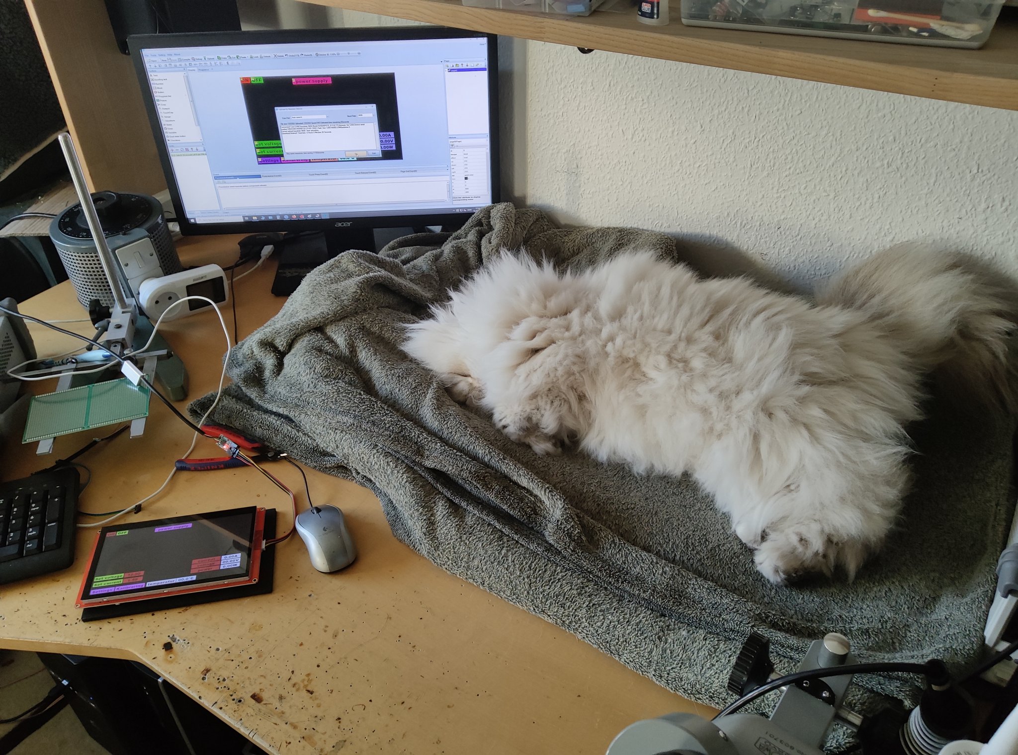

The teensy 4.1 (i now get its name, its very small)
And the nextion 7 inch touch display.
Stil missing dac8830 for Analog control.

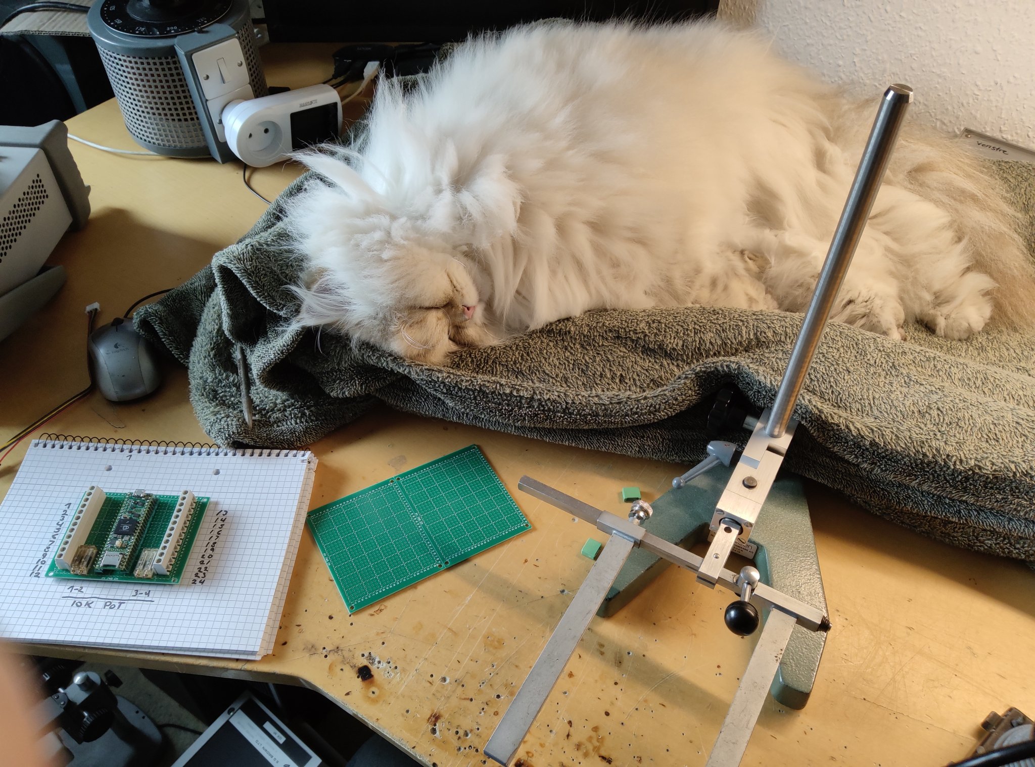

I started layout on prototype pcb for teensy, terminals for easy connection, trimpots as Voltage dividers, converting psu 0-5 volt into 3.3 volt, which teensy sadly only accept. Maybe i should go with resistors instead.
Next up soldering, and the try to produce a nice gui interface in nextions editor.
All psu control will be through display, but i am unsure about control, a rotary encoder gives you much more accuracy,
Ive been comcidering sliders, coarse and fine, but it dosent feel right, Weel teensy has plenty of ports so rotary encoders can be added later on.View attachment 1434838

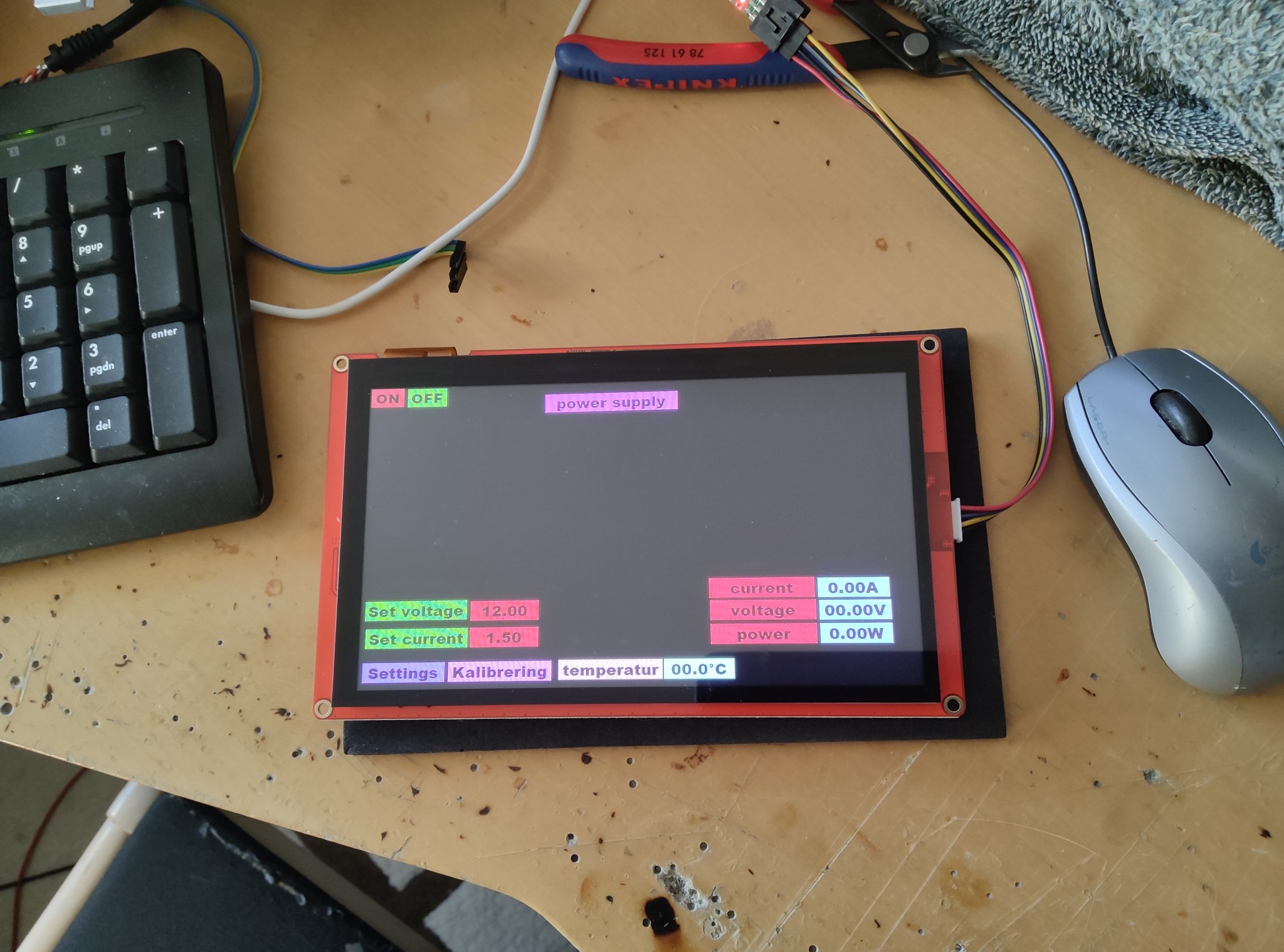

Me and my body spent a few hours on user interface, Jesus om no good with computers, but nextions software is very intuitive, so its getting easier, here is a little progress, everything needs some moving around and polishing, but om confident it will work out, hope this week i can get it comunicating with teensy.

Would it be possible to include bar graphs so you could quickly drag voltage or current limits up? Graphical knobs are a pain and you need some easy way to make it variable. Just a suggestion from an ease of use perspective.

Yes i have a list of features i want, but right now i just want it to work on minimum, i can always add more. Theese are the wanted features.

I'll take basic that works and is reliable. I'll take an accurate 12 bit over anything that isn't as accurate but higher bit depth.
Pretty ... that comes later. Read back as well as set point is valuable.

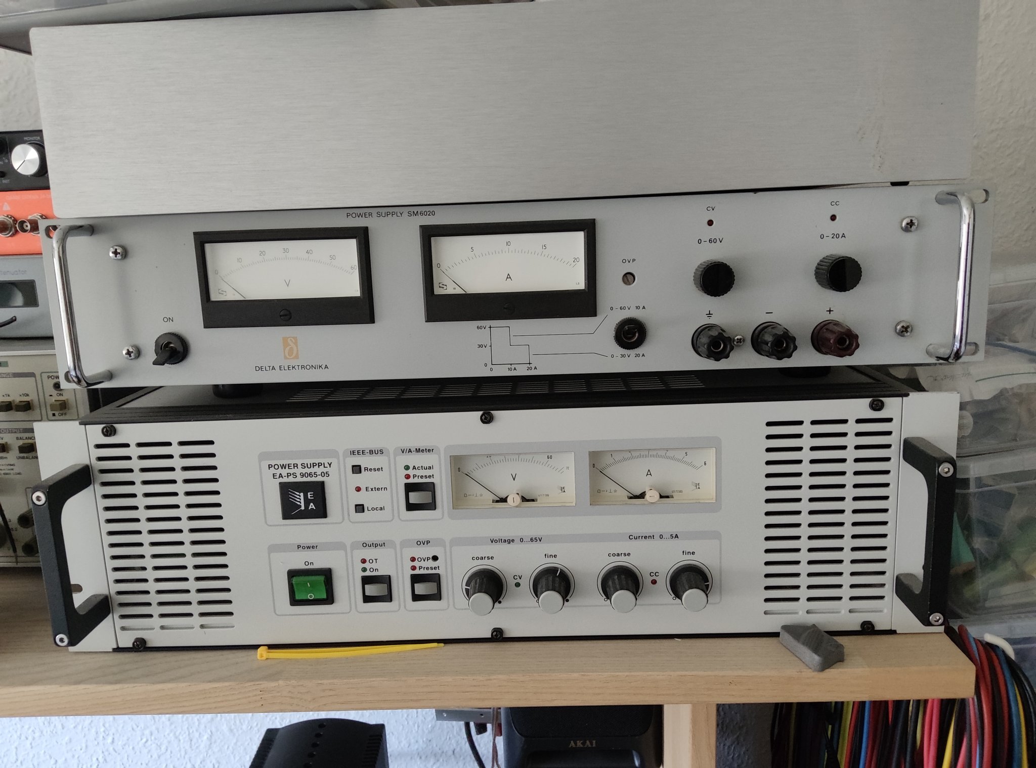

Looks very nice, and what a wide span it has, yes, fans are very annoying, especially the small ones with high rpm,
My best supplys are theese
Your eye sight is still spot on, it is a very nice piece of gear. I have secretly fantasiced about putting diddens regulator in it and refresh its electrolytes, theres plenty of space.
I refreshed mine, calibrated it and gave it to a university friend. A better power supply would be helpful, the rest is a bit fuzzy in my memory. I just wanted to make it work as it should for my friend.
Yes, a box of air - so to speak. There is physical room to improve things. The best thing was it performed okay, and it was easy to use.

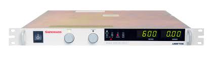

I'm planing to spend less than 100 eur for split supply based on two RK6006 and two https://www.aliexpress.com/item/1005007655671269.html and make diy metal enclosure. RK is litle brother of the RD6006 well popular dc-dc power supply, take a look into the video!
You are right the dials are very nice, also produces are pretty clean sine.
