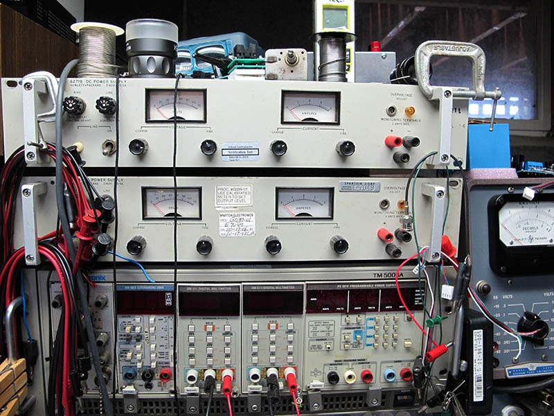

I have two setups. In NJ I use the HP6271's bought surplus when working with SS power amps. I usually run the outputs through the Tektronix DVM's for current. For opamps and lower voltage I use a TEK PS5010, also bought surplus.
In OH I use (as Chris first mentioned) a variac and a big Antek transformer. That power supply is housed in an old HP "Digital Voltage Source" carcase.
For tubes, I use a Heath IP17, or a Variac/transformer combination.
