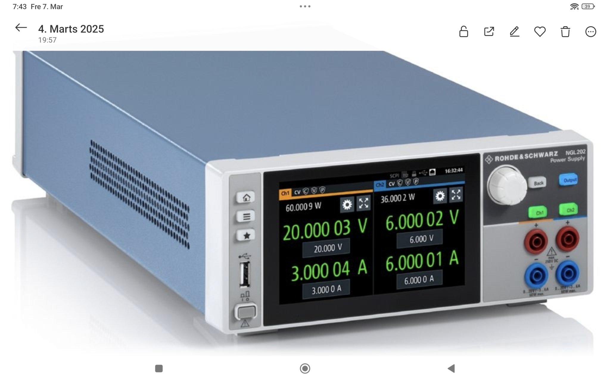

The built in metering frees up my meters for other duties. It's always useful to know how much current you're drawing. I really like knowing my set voltage is actually what the circuit is receiving. I really love not having to move meters around and connect them, I just look at the power supply and it tells me.
The E36312A has four wire outputs in the rear in case you need to guarantee your set voltage is right at the UUT terminals, having dynamic correction. The trend display is also extremely useful at times. I think this is a case of when you have it available and use it, you realise how nice it is. Remember when we joked about power windows in a car? (I did).

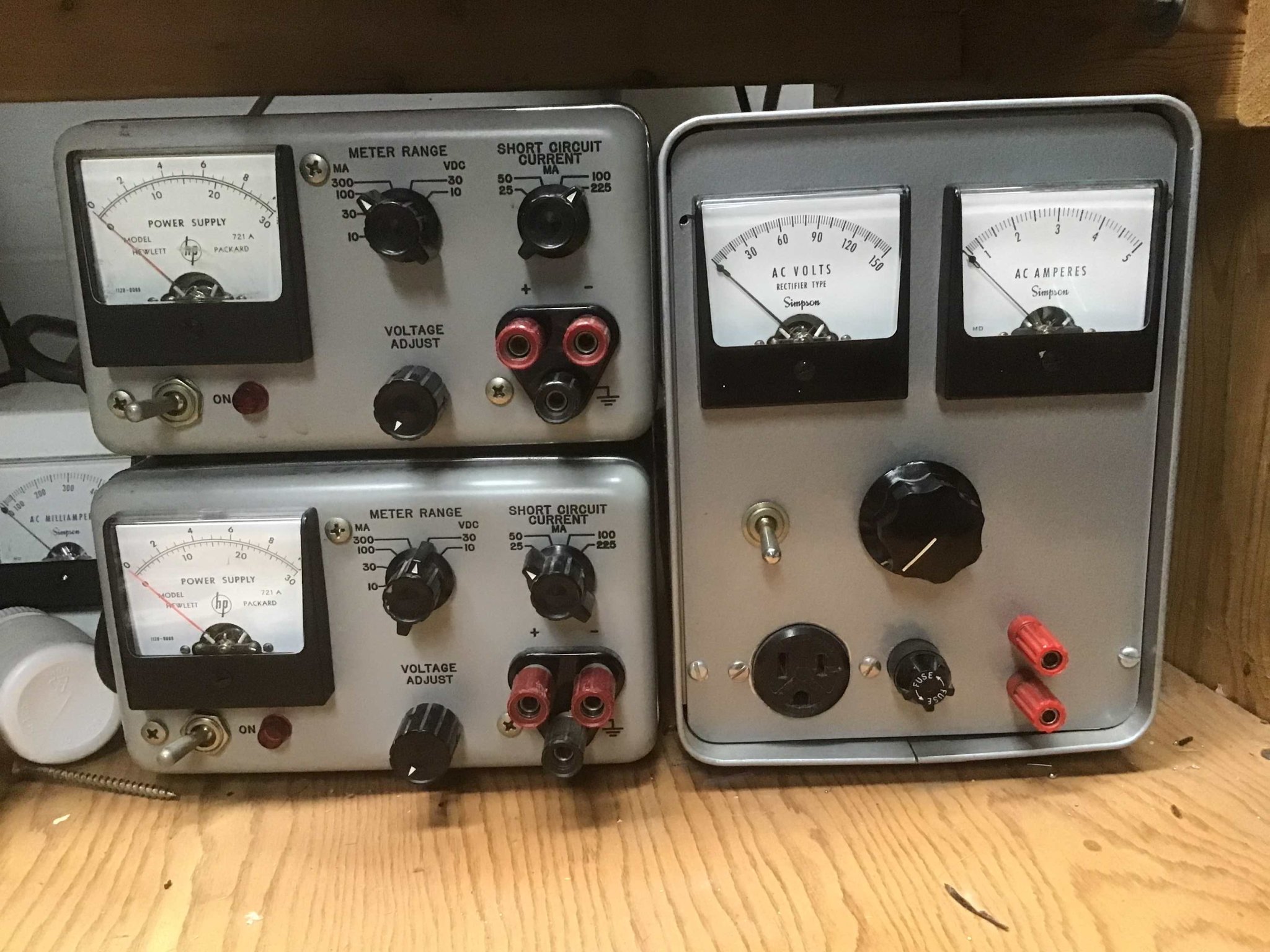

Hello Carlp,

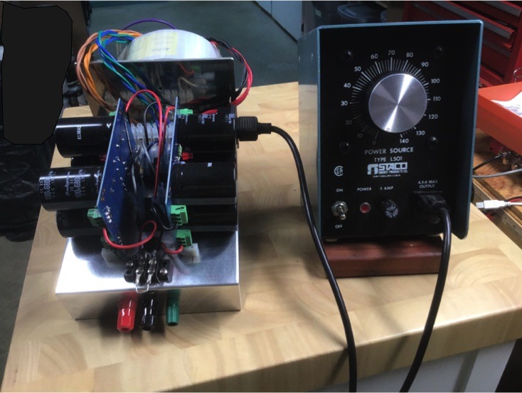

Used HP gear is usually good value. I bought mine 20 years ago, and they are in constant use. When I need more power, I made my own bench power supply as described in my DiyAudio post titled DIY Bench Power Supply.
Also many years ago, I made a variable AC source, nothing more than a 2 Amp Staco variable transformer, and a couple of meters. That variable transformer is quite expensive today ($200) but you can probably find a used one for a lot less. I do not power up any unknown device without using it. Bring up the voltage very slowly, watching the ammeter closely, any serious shorts will be obvious before any damage is done.

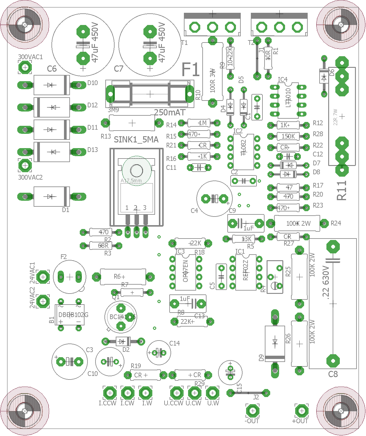

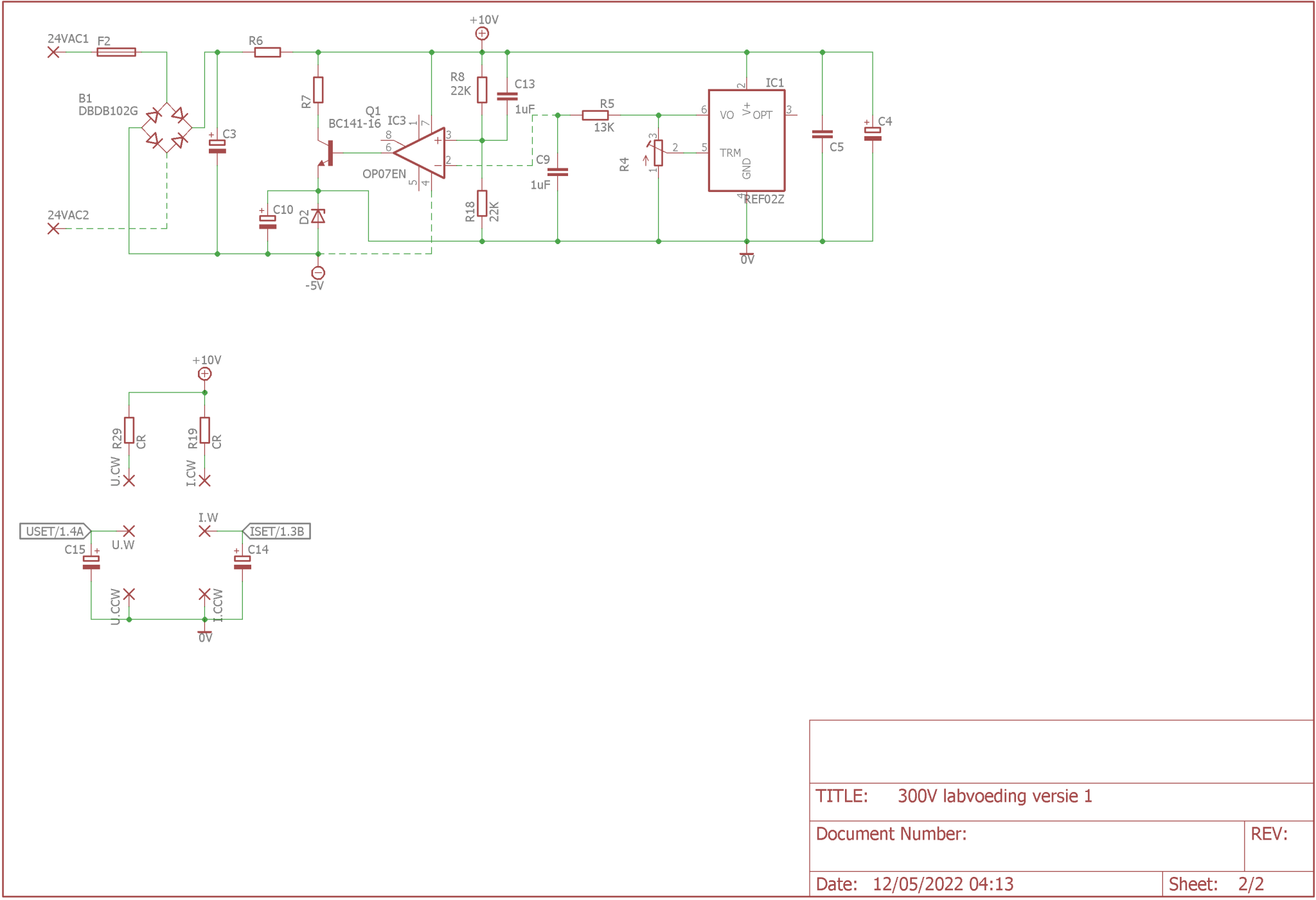

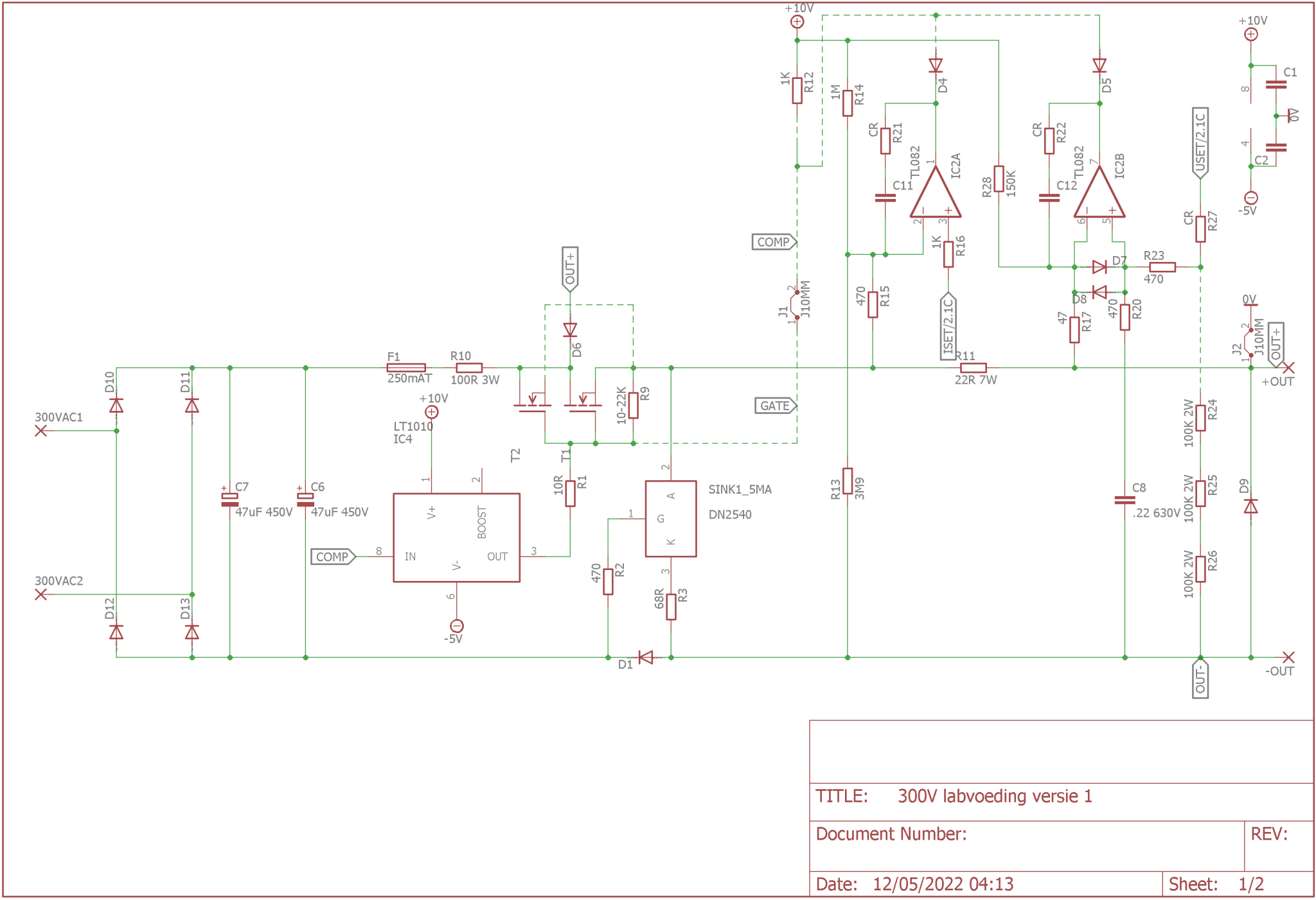

Heres the Eagle files for a 0-300V 0-200mA lab power supply i did a while back. It needs improvement, i would replace the REF02 with LM329. And add source resistors for the mosfets so they share the load more evenly.
The DN2540 behind the current sense resistor is to keep the mosfets in conduction. The original design had another low current transformer winding for a BJT current source.
V4LVE

Why not use a resistor instead of a CCS to load the mosfet output stage? It doesn't have to be a constant current. Also, normally you would have gate protection zener diodes as well. Otherwise not a bad little regulator.
I think the OP wanted a "mid voltage", bipolar higher current supply though.

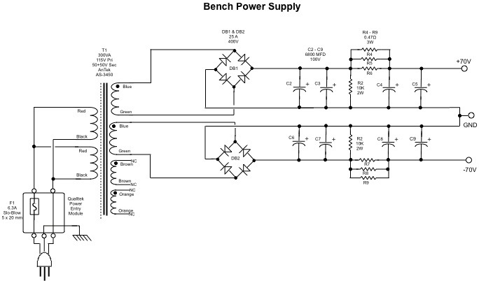

Hello Carlp, just got the e-mail about new posts to this thread, not sure why I missed your 07-04 post. I will just repost the basics again.

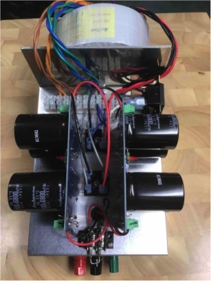

I thought I would just build an open frame unregulated power supply, similar to what would actually be used in a completed amplifier, and power it from a 4.5 amp Variac I have. With that combination I could power up slowly, for testing, at any voltage up to the maximum of the unregulated supply. The 5 amp requirement implies using a transformer in the 300 - 400VA range. I selected 300VA because a model with two 50V secondary’s was available at the time from AnTek. I used the Universal PSU boards from the diy Audio Store, a pair of bridge rectifiers and a total of 27,200 microfarad of capacitance per rail. Total cost was $162.00. If one needed to buy the Variac also, they are available for around 50 – 60 dollars. Pictures and the schematic are attached.
Remember, it is open frame, so you have to be careful. I keep mine a couple of feet away from my work area. Of course you could also enclose it and put volt and amp meters on it.

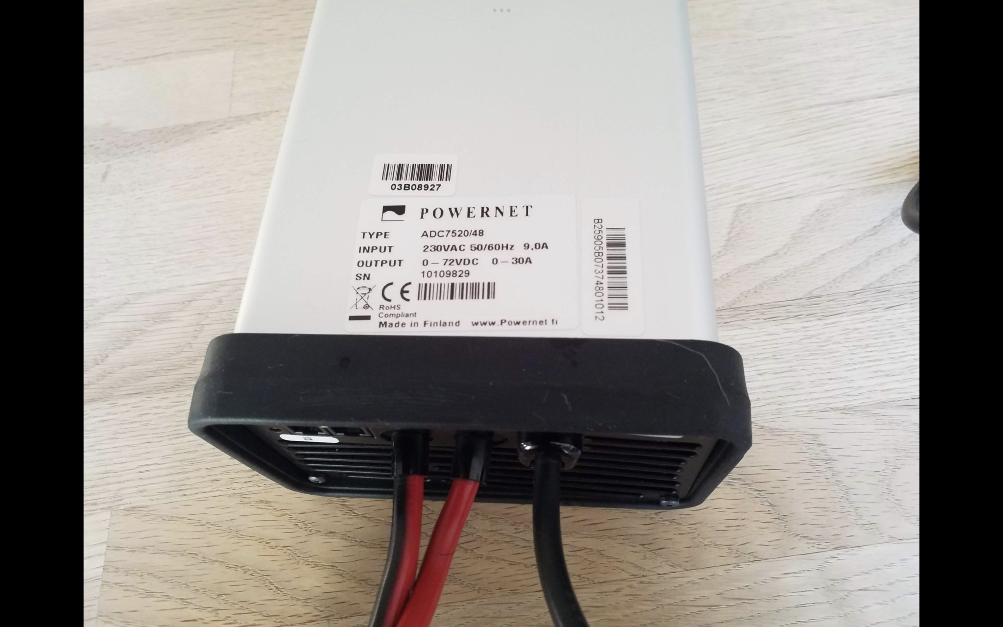

Good bench supplies are expensive, so i have started a project, a dual supply capable of 72 volt 30 amps, can be coupled to bipolar.
Base for project are two industrial switchers, they have analog 0-5 volt control for volts and amps, plus analog 0-5 volt for monitoring output.
I thought that could be a nice supply if microcontroller controlled.
So i purchased 4 16 bit dac 8830 for controlling volt and amps, i bought a powerful teensy 4.1 Arduino like controller, and a nextion 7 inch touch screen, theese things together will yield a power psu, with very precise control, i am currently working on software to run it, and the nextion display will allow very nice interface, i had originally intended rotary encoders, but came to the conclusion that all control could be done by touch screen only, i have looked at Rohde Schwartz series for inspiration for visual and control options.
Parts are still in mail, software is being virtually tested in nextion software and protein isis.
Ripple is a tad high, 50mv ripple, switching at 300khz, i believe a pi filter will do wonders.
Specs are.
+/-72 volt
30 amps
Calculated resolution with 16 bit is 76.3µV.
I will post more pics when there s more to show.

Yes old psu are very good, i have a few delta elektronika. An EA-PS 9065-05, a old hp boat Anchor.
But i wanted something different, a very capable bipolar psu for testing most of the stuff i use.
Anyways, i will keep updating om progress.
I still need a chassis, i know a guy who does cnc in aluminium, so faceplate with the 7 inch screen will be done by him.
As to the switchers, i think i will remove them from original chassis, and add 120mm fans for lower noise, currently 60mm fans are used, making tons of noise .

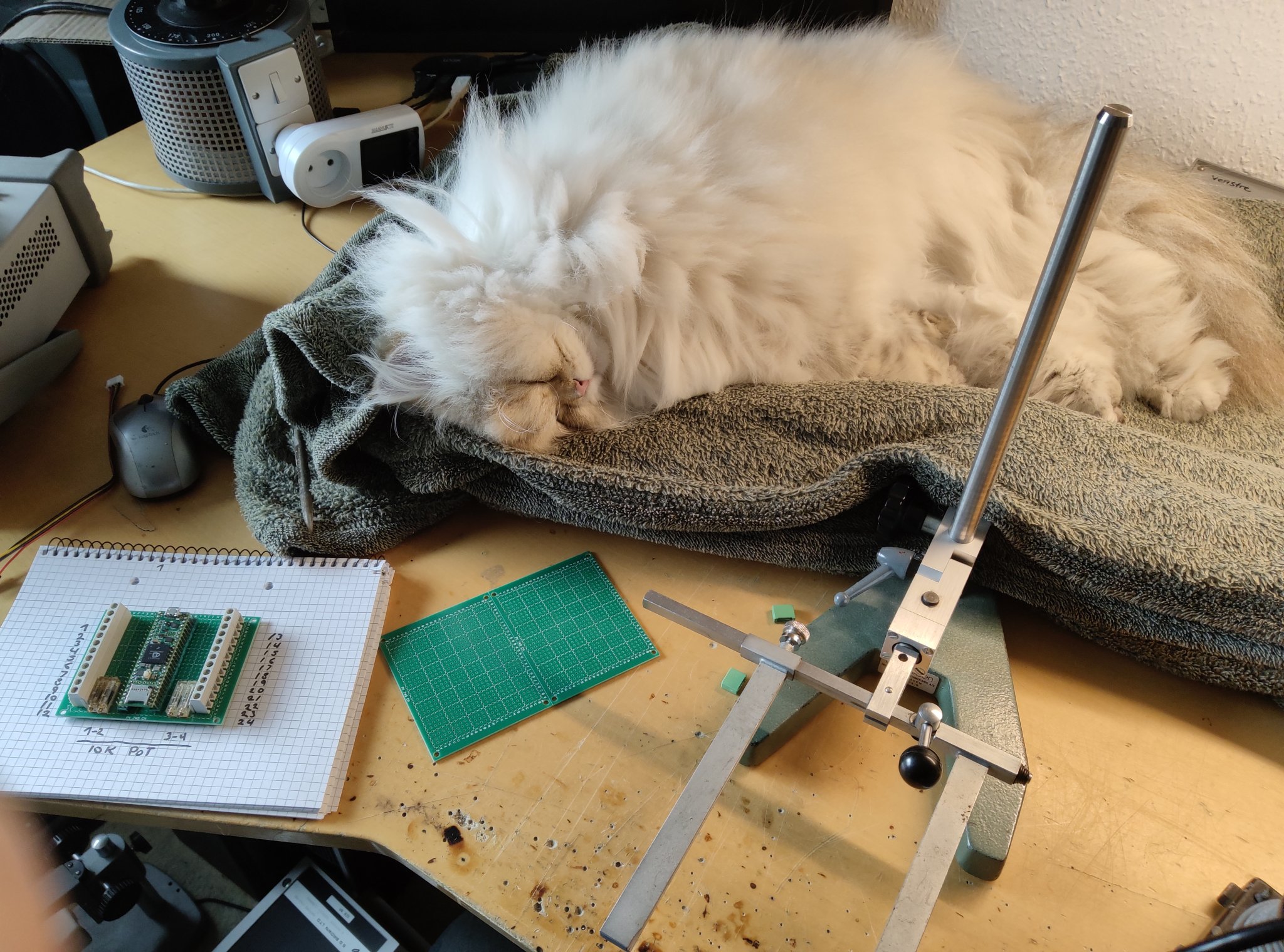

Recieved some parts for psu project.
The teensy 4.1 (i now get its name, its very small)
And the nextion 7 inch touch display.
Stil missing dac8830 for Analog control.
I started layout on prototype pcb for teensy, terminals for easy connection, trimpots as Voltage dividers, converting psu 0-5 volt into 3.3 volt, which teensy sadly only accept. Maybe i should go with resistors instead.
Next up soldering, and the try to produce a nice gui interface in nextions editor.
All psu control will be through display, but i am unsure about control, a rotary encoder gives you much more accuracy,
Ive been comcidering sliders, coarse and fine, but it dosent feel right, Weel teensy has plenty of ports so rotary encoders can be added later on.

Yes, he is a happy camper, always ready to help out. He likes watching when i fiddle with stuff. Sometimes he watches YouTube om desk also, tons of cat videos..
I can't have a cat on the bench! There's the hair, moving of things and possibly ex-cat due to high voltage. Never mind the soldering irons! Then should the pussy decide to chew some cables under/behind the bench there would be hell to pay!
Dogs are bad enough underfoot, but at least you won't find them on the bench. I'm very happy you and your cat can co-exist. I wouldn't mind the company.
