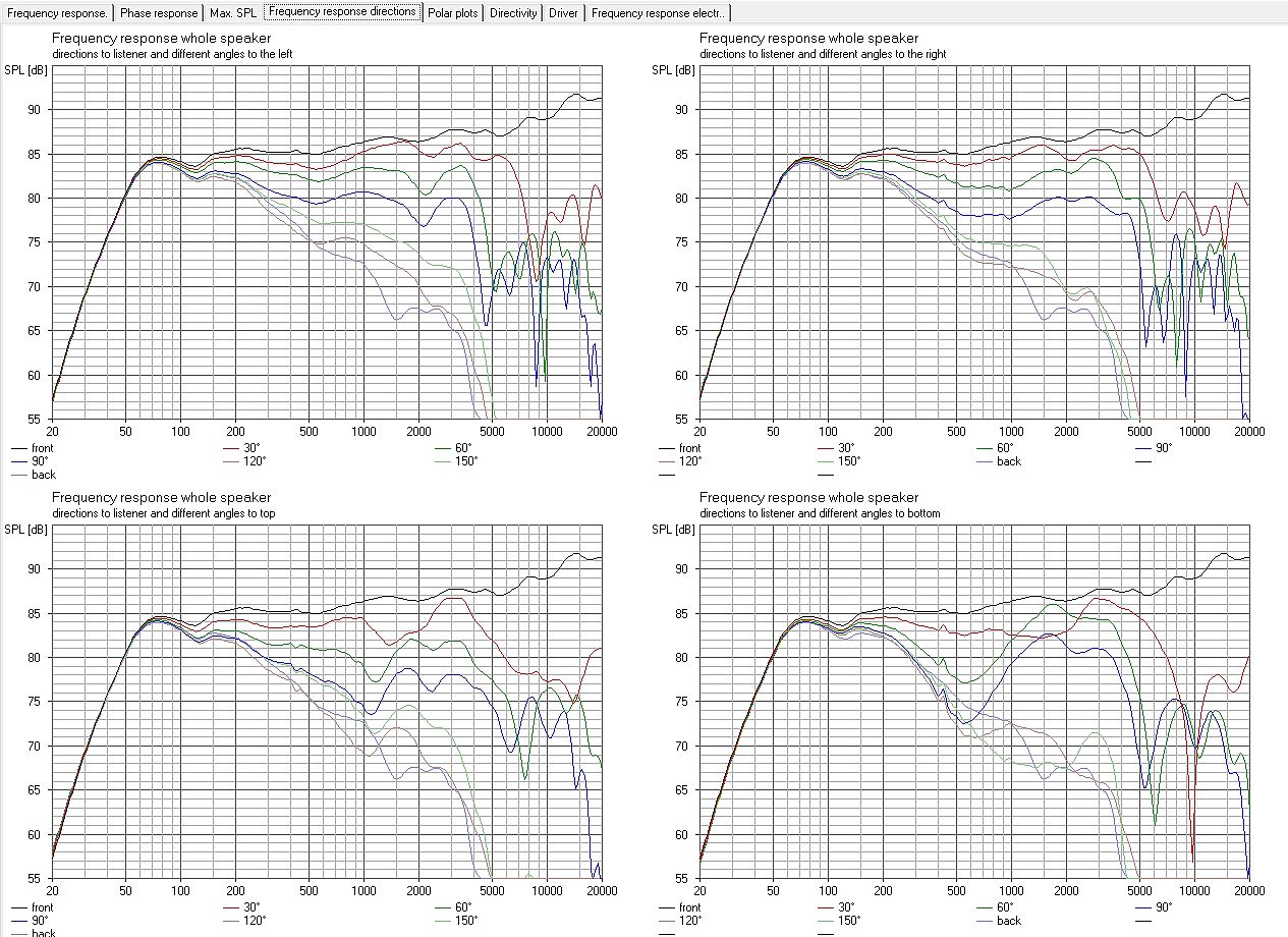

But with supertweeter all frequencies above about 10-12kHz are slightly boosted, which gives much better total sound picture.

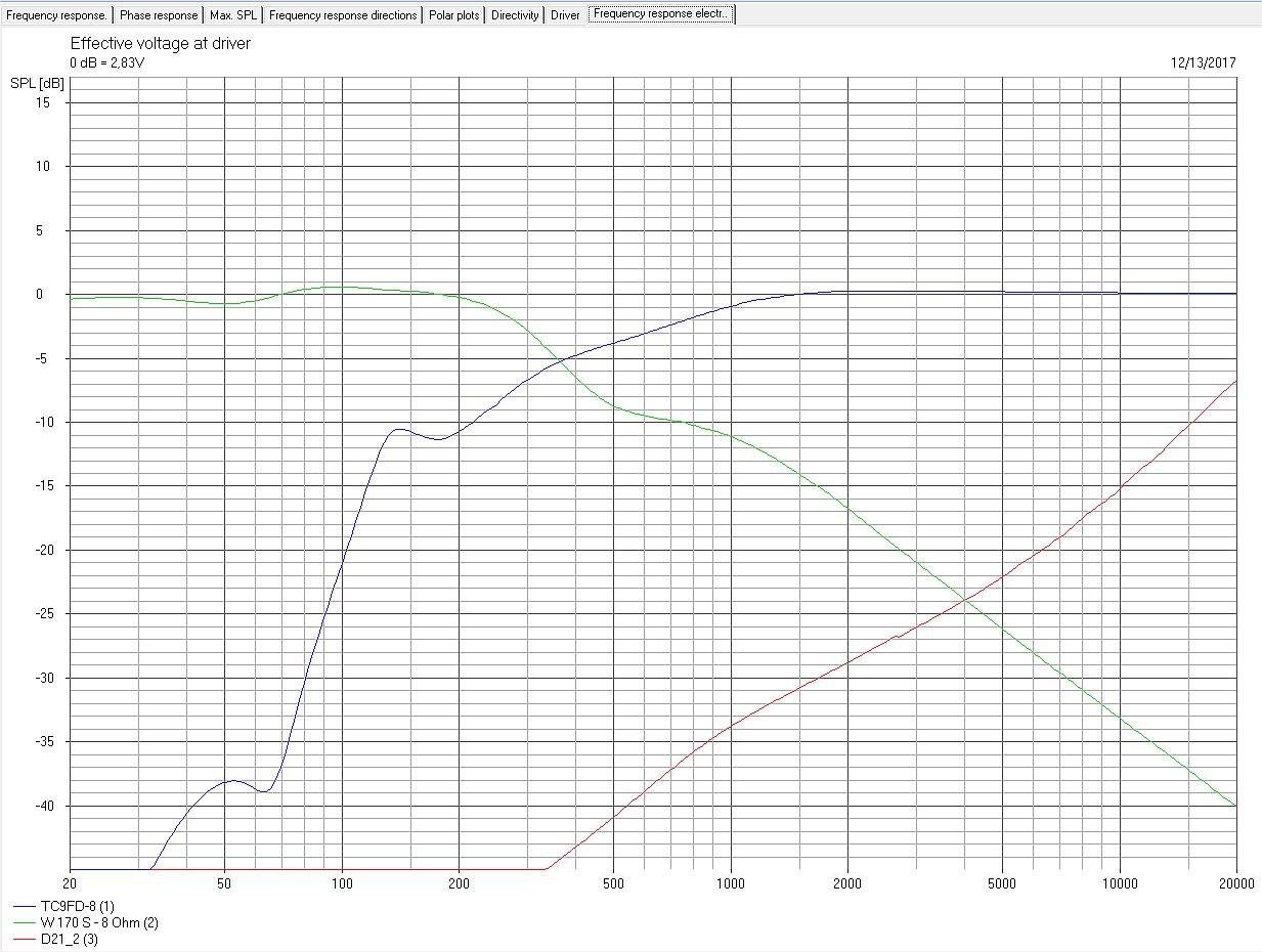

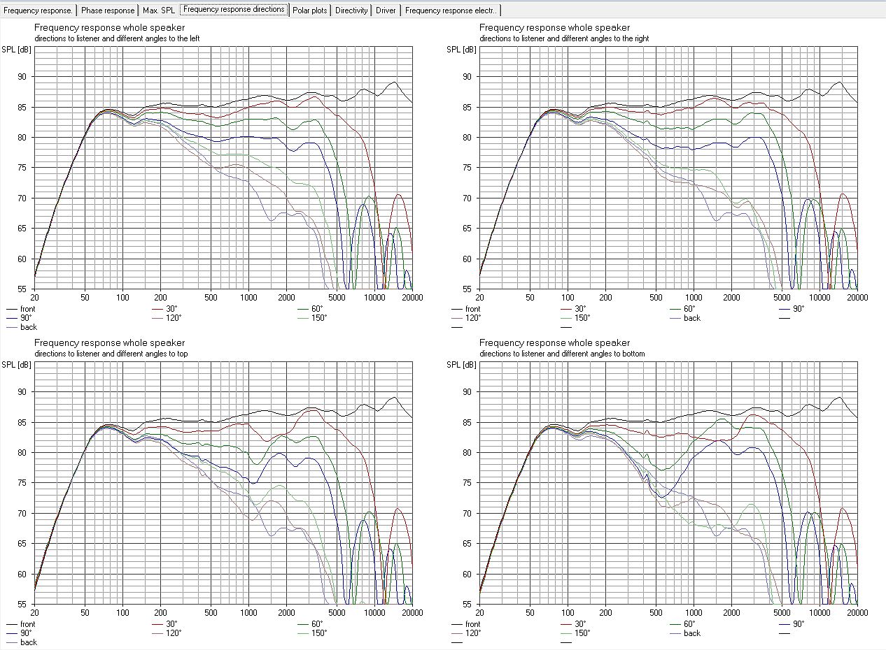

BTW, i am with TC9FD and 17 cm woofer in 25 l box.
I'm listening mostly off-axis.

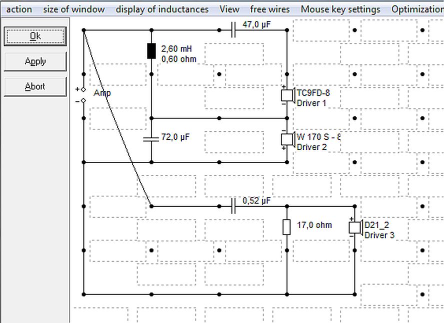

My old Dynaudio D21/2 supertweeter was cut >20 kHz electrically.
0.52uF (film / foil ERO KP-1832) in series, then 17 ohm parallel to D21/2 for low attenuation.
This is best for my ear, after much experimentation
