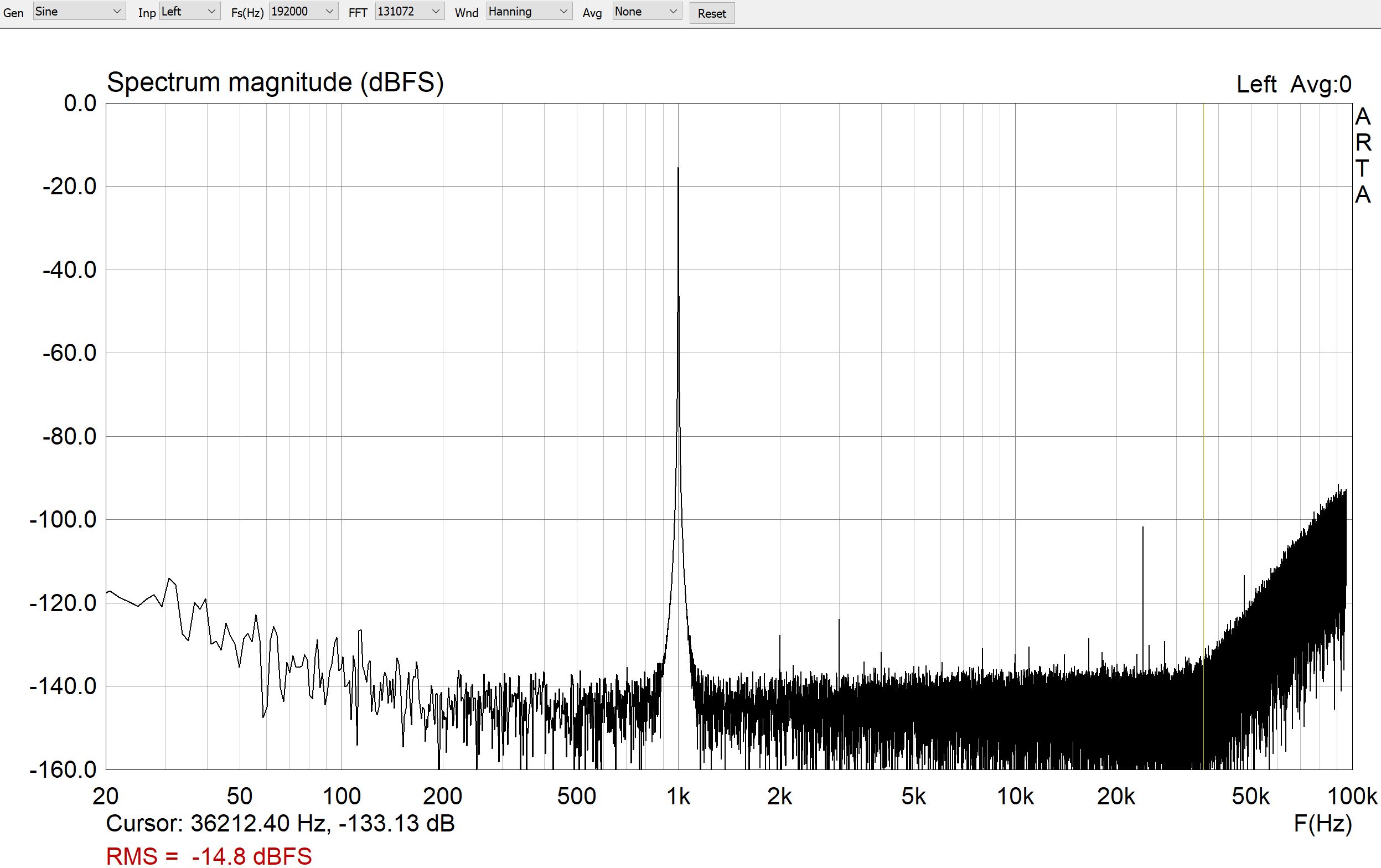

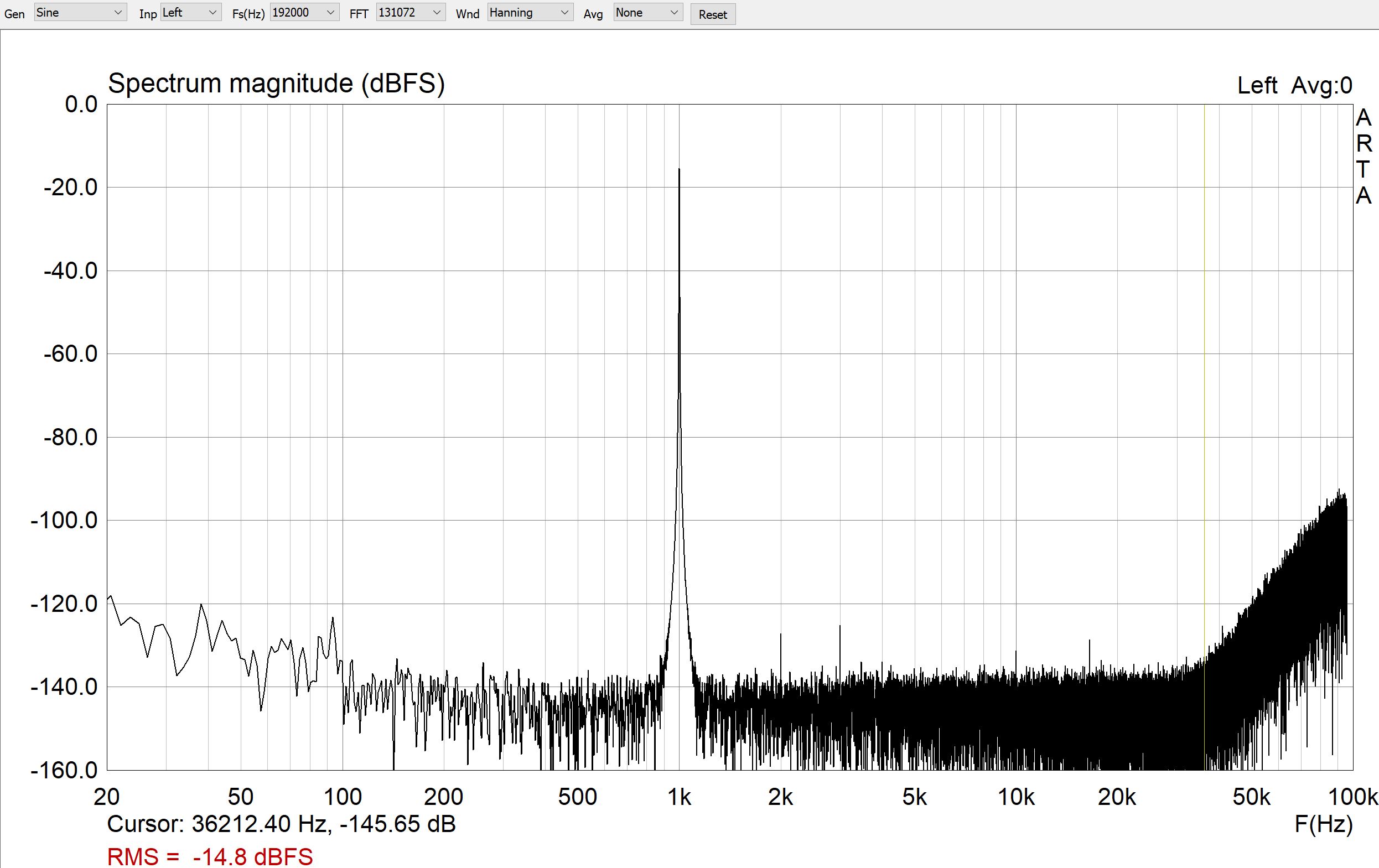

Just an ordinary laptop and windows 10, that comes preinstalled. Only adjusted the sample rate and bit depth in windows settings and in ASIO panel.Could you please repeat with 1kHz sine both for phantom on and off?
BTW nice bandwidth! What PC/OS do you use?

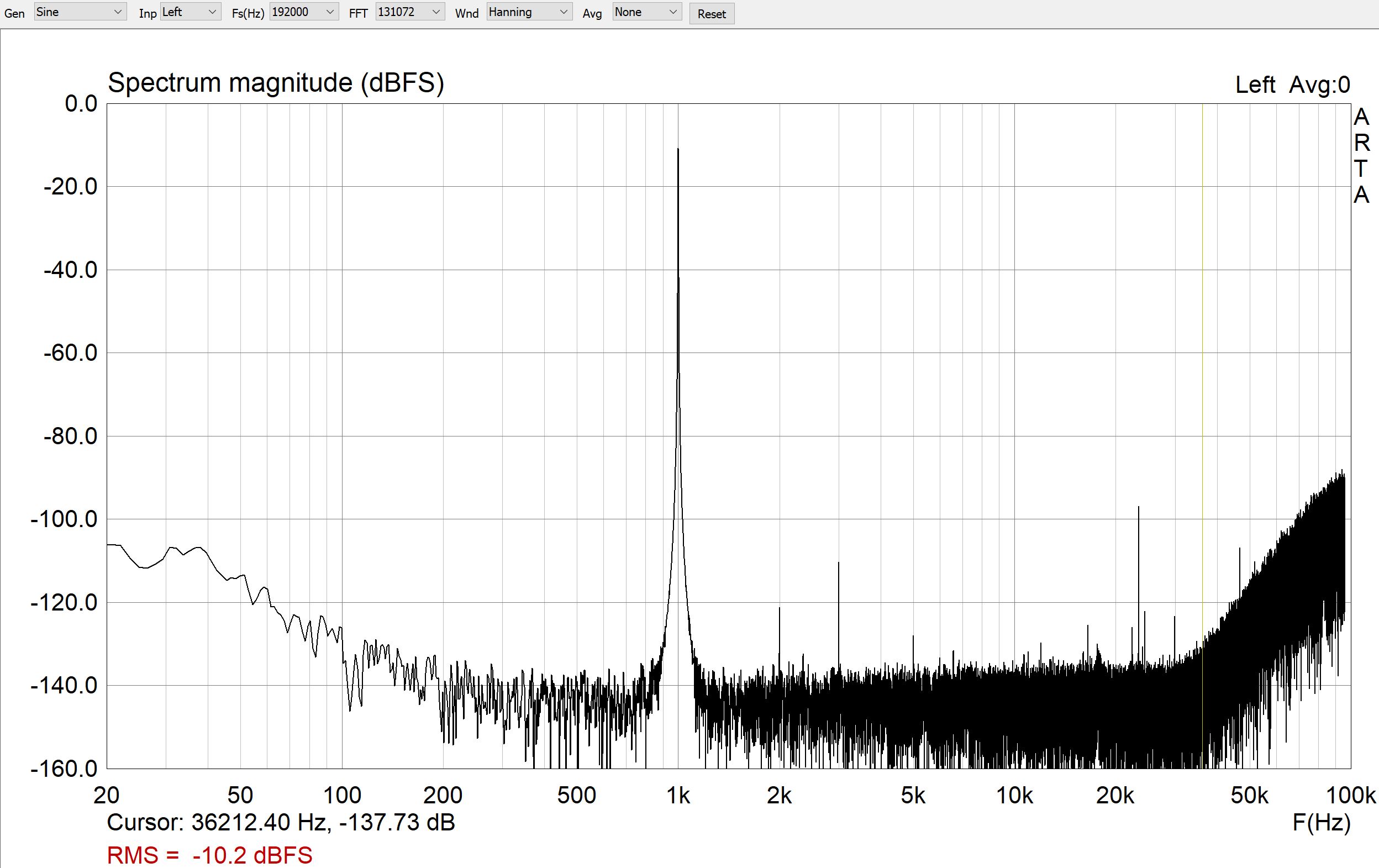

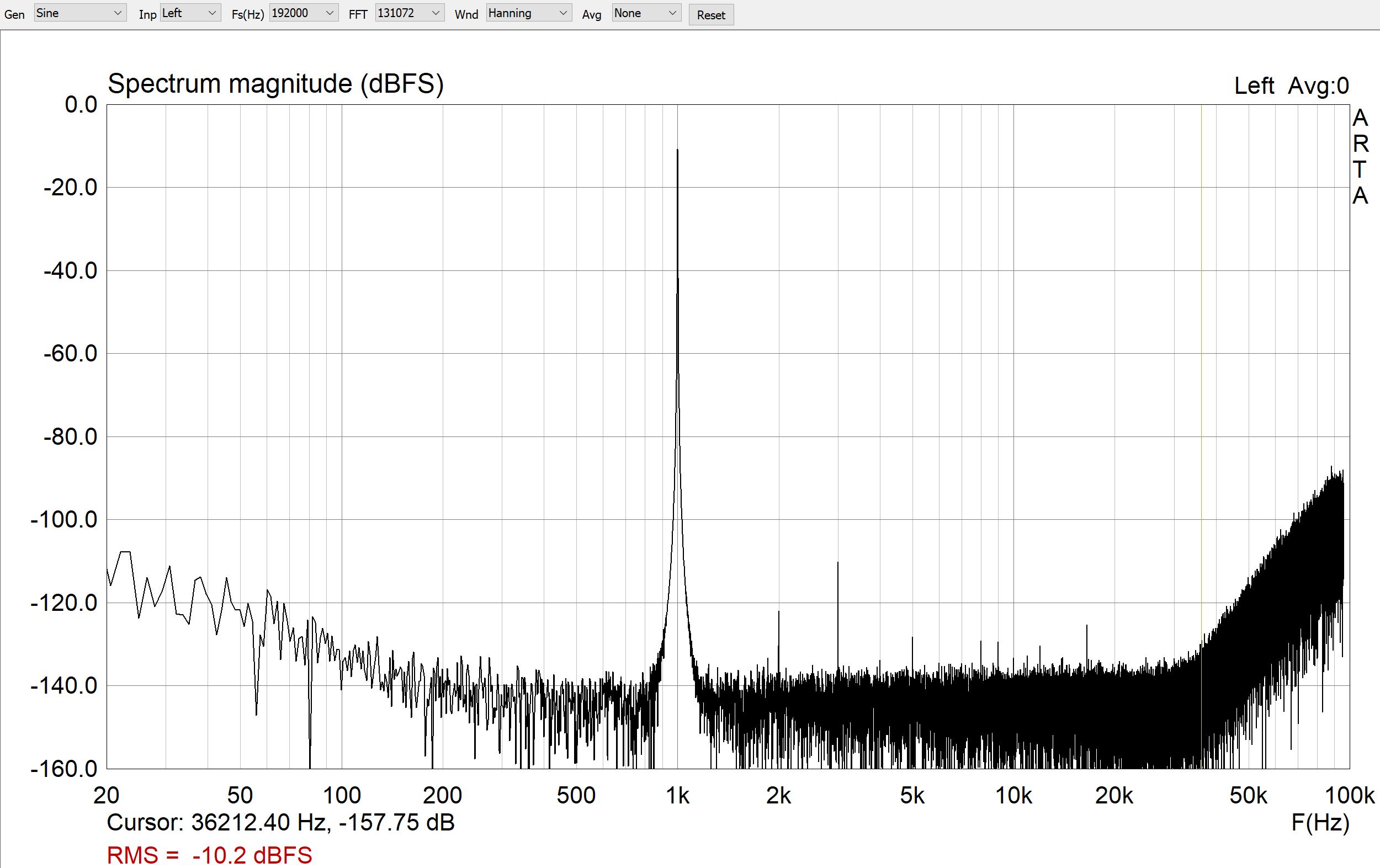

I do not have a decent source yet. The UMC202HD output has distortion and it's level is not so high. The pictures below are taken with output knob between 2 and 3 o'clock. With and without 48V phantom boost powered.
Thanks a lot! Not sure if it is the output stage to blame for the distortion. The input buffer op amp cannot drive the adc at full scale because of restricted headroom. It will start to distort clearly above approx -17dB.

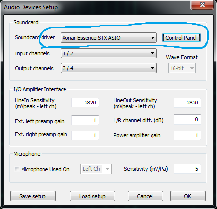

And if you use ARTA (or smth else) - make sure you use ASIO drivers, like at my screen:
Thanks a lot ! do these drivers usually come with the card ? or can they be found somewhere ?
Unfortunately I don't know anything about Behringer soundcards. I'm not even sure if it has ASIO drivers (but it has to has I think). Have you checked thoose ARTA settings? What you have in that list?
Hi ! if you mean the drivers i am using windows default drivers ... the soundcard is plug and playUnfortunately I don't know anything about Behringer soundcards. I'm not even sure if it has ASIO drivers (but it has to has I think). Have you checked thoose ARTA settings? What you have in that list?

i think i will try one very soon. Great card for the asking price indeed. Thanks for the advice.Yes, UMC 202HD comes with ASIO drivers. Common practice for most sound cards today.
One small tip - if your soundcard does not have ASIO drivers, try ASIO4ALL. I do not know how it works, but it worked for my old M-Audio BlackBox in Windows 10 - and it does not even support W10 AFAIK.
